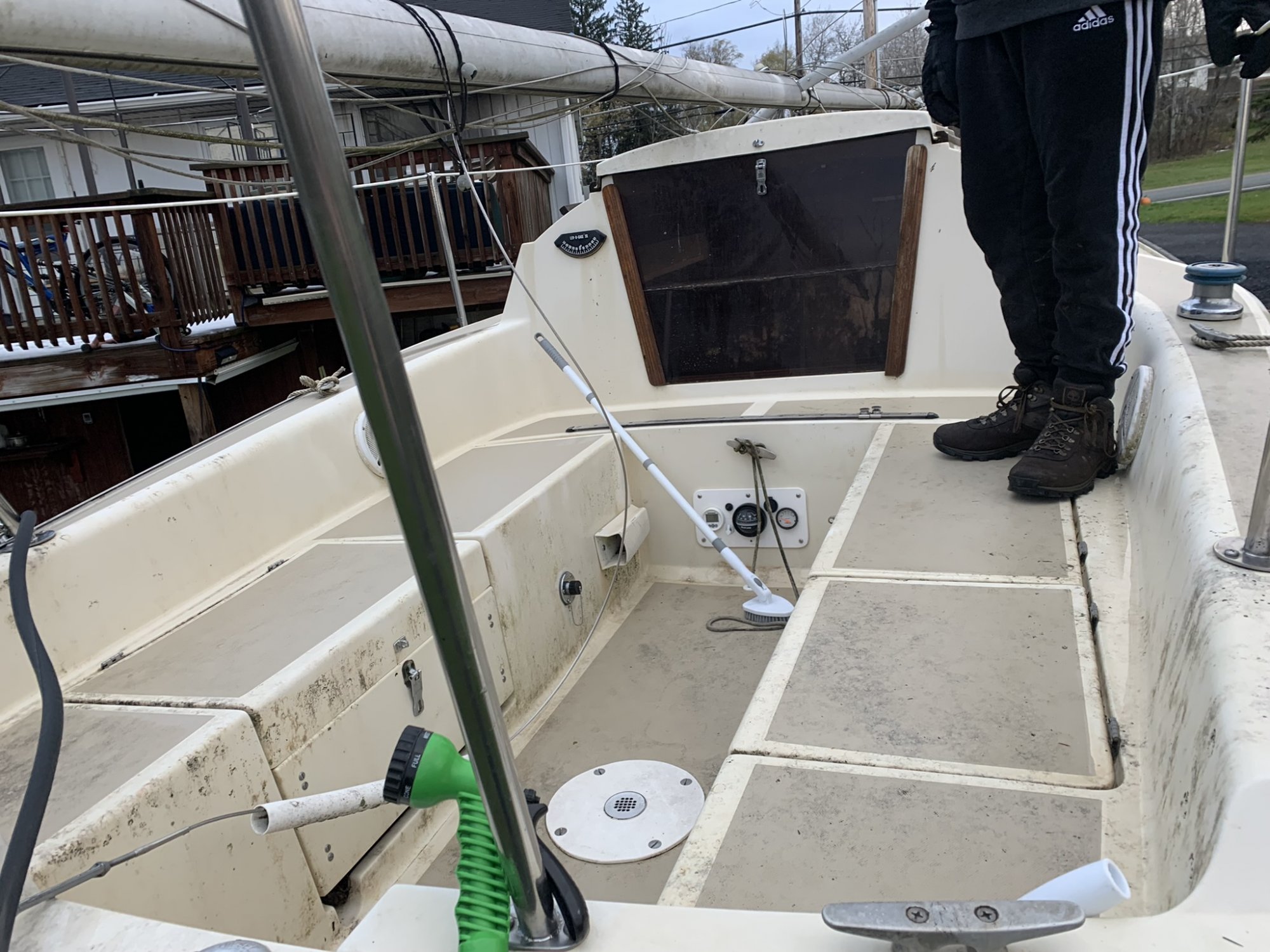

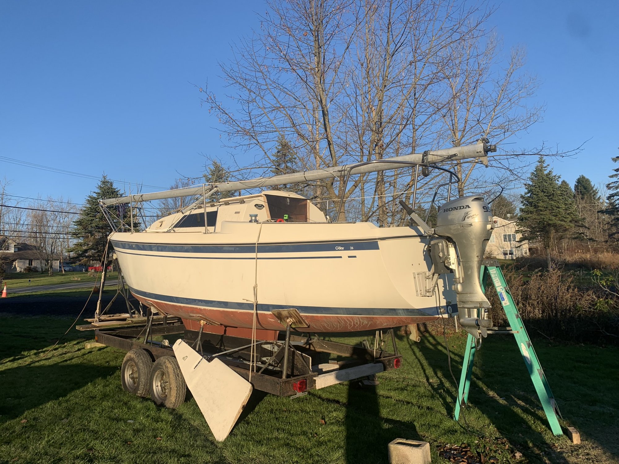

Hello, good news everyone! My friend and I ended up purchasing the 1986 26’ O’day and here’s a little update. (I know some of you wanted to hear more about it and how it’s going so I made a new thread. Plz moderator if I’m posting in the wrong spot correct me) so we bought the boat for 1000 bucks with the trailer and man was the outside rough. There was this thick black gunk all over, probable from sitting under a tree for so long. (Shown in first photo)
As you can see it doesn’t look white. Now we did some light cleaning on the outside and a bit in the cockpit area and we’ll see for yourself!

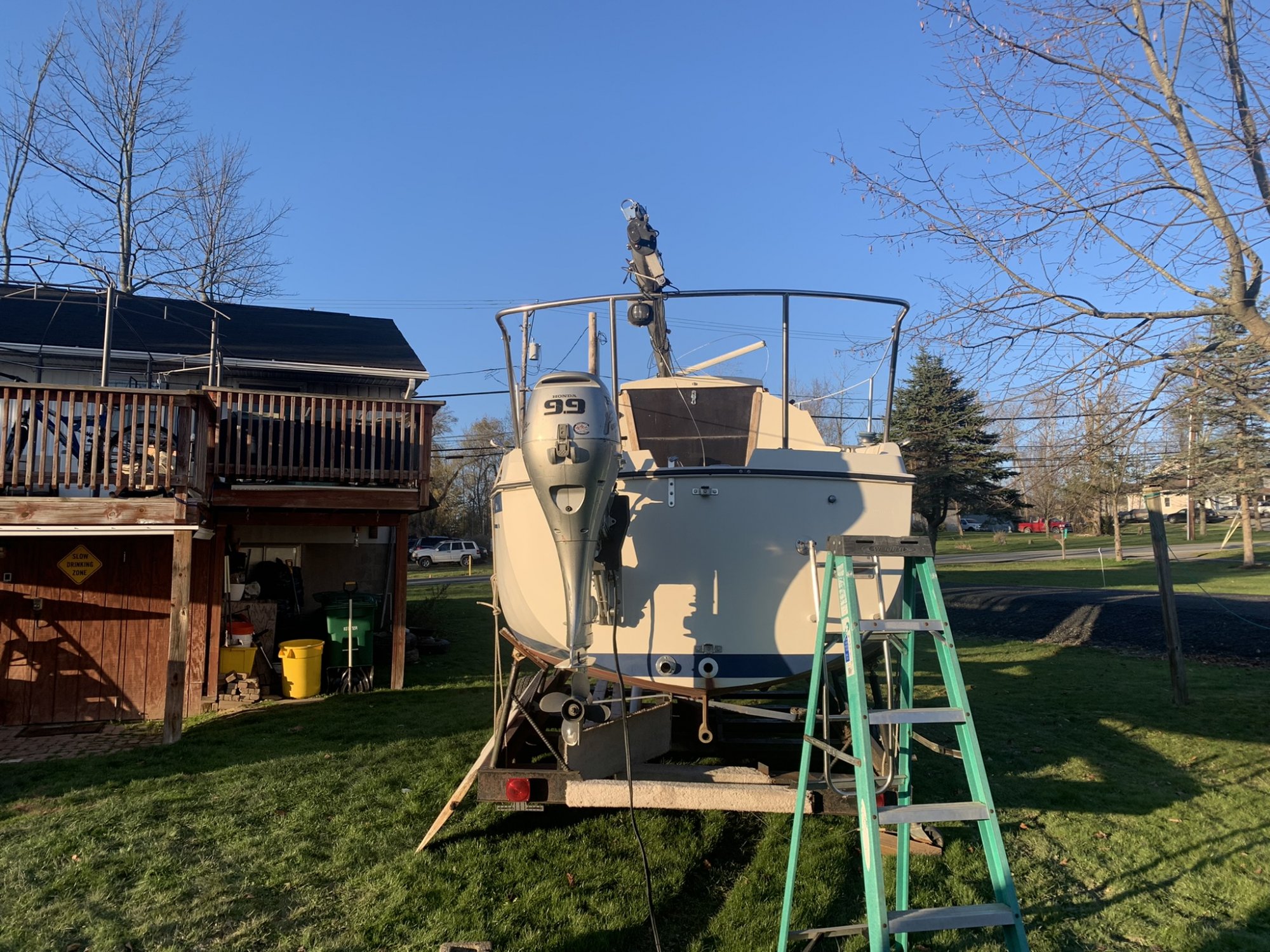

also we picked up a 2006 Honda outboard with electric start. Great pick for 860 bucks, plus it looks awesome on the boat. Now for the inside. My buddy and I just got done cleaning it up, it wasn’t too bad but we have to recover some of the seat cushions.
I ran out of files to attach but you get the idea.
other than some work on the trailer the boat in its current state can sail! But I have some plans I wanna do before then. First, I bought a generator. It’s not big by any means but it has the same dimensions as the old inboard did sooo I'm going to put it there. Next I’m going to hook the outboard into the 15 gallon tank that is on the boat. After that I want to paint the outside, I’ve painted cars before and a boat once. I know the process and I’m sure I’ll make mistakes but navy blue paint just looks so good on boats I can’t resist. Then we plan on replacing that old ice box with a chest cooler dual zone cooler. Oh and the boats name (because it was never named) is not the “Flying liability”. Mainly because I probably shouldn’t be sailing. Let me know what you think!

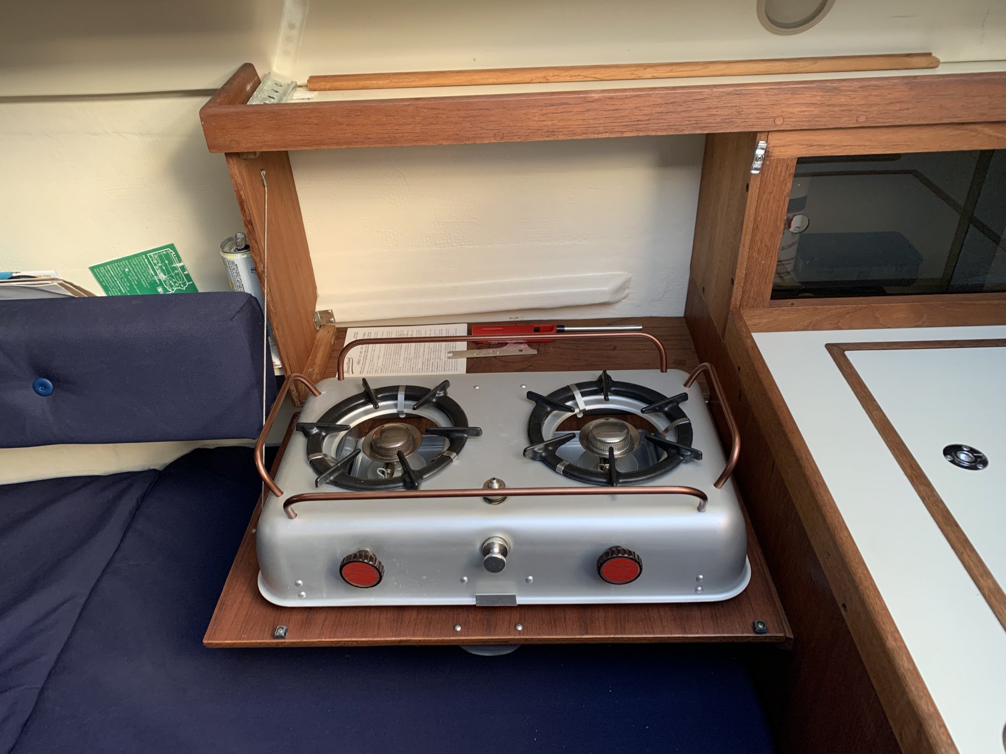

Step back a minute from the generator. There are a couple of big issues with a gas generator aboard a sailboat and even bigger issues with mounting it below decks, namely carbon monoxide poisoning and the explosive nature of gasoline. There are probably better and safer solutions. Let's talk about those before go forward on this part of your project.
In the meantime, enjoy winter sailing dreams.
24,753
The above plus the "white gas cooking burner" present a liability to the safe sailing experience you seek.
While camping ashore the highly flammable fuels have a stable environment. On a boat you are constantly moving, tilting leaning and affected by the wind. The evaporated fumes present a risk of explosive combustion. This is especially a risk in a closed cabin.
You may want to rethink the fuels you use. You will definitely want to install alarms that can announce the prescense of combustible fumes in the boat. You will also want fans that can clear the boat of any fumes before you try and start any engine or light a match.

Thank you for those tips! We mainly plan to use propane on the genny if it pans out. We have been thinking about getting some sensor to put in the cabin and In the engine bay. She does look a whole lot prettier and I can’t wait to paint her in the spring!

extra large engine, fuel, gen, gas, reefer,..... loading a vessel is a art form. just like poorly loaded car trailers can lead to poor performance. all the while no mention of the new sails. yes sails. and the books on how to use them.
all your tasks have nothing to do with sailing the boat. and sailing it well.
the noise of an engine, the noise of an onboard gen, are always a buss kill compared to the sailing.
so i'm blunt, sorry, you've done a lovely job so far.
me. getting the sailing thing correct first is how i roll

The boat originally had a diesel inboard motor....We actually just under 80 pounds under what that old iron diesel motor weighed.
If I understand these actions.. You removed a diesel engine and are replacing it with the outboard that you scored at a great price.
What Jon is sharing is it is not just matching the weight of items you remove from the boat.
Weight is not all the same. The affect of weight changes boat performance based on how high off the water it is and where it is in the boat.
You removed the engine which is located about a third of the length of the boat forward of the transom and at or slightly below the water line. This will have the affect of reducing the weight of the boat and raising the CG of the boat. You replaced it with an item of similar weight but raised the weight above the previous CG and to the stern of the boat.
These changes will affect the stability and efficiency of the boat.
the sails an rigging are new
This was a bonus in the purchase. Most used dirty boats have used (dare I say blown out) sails.

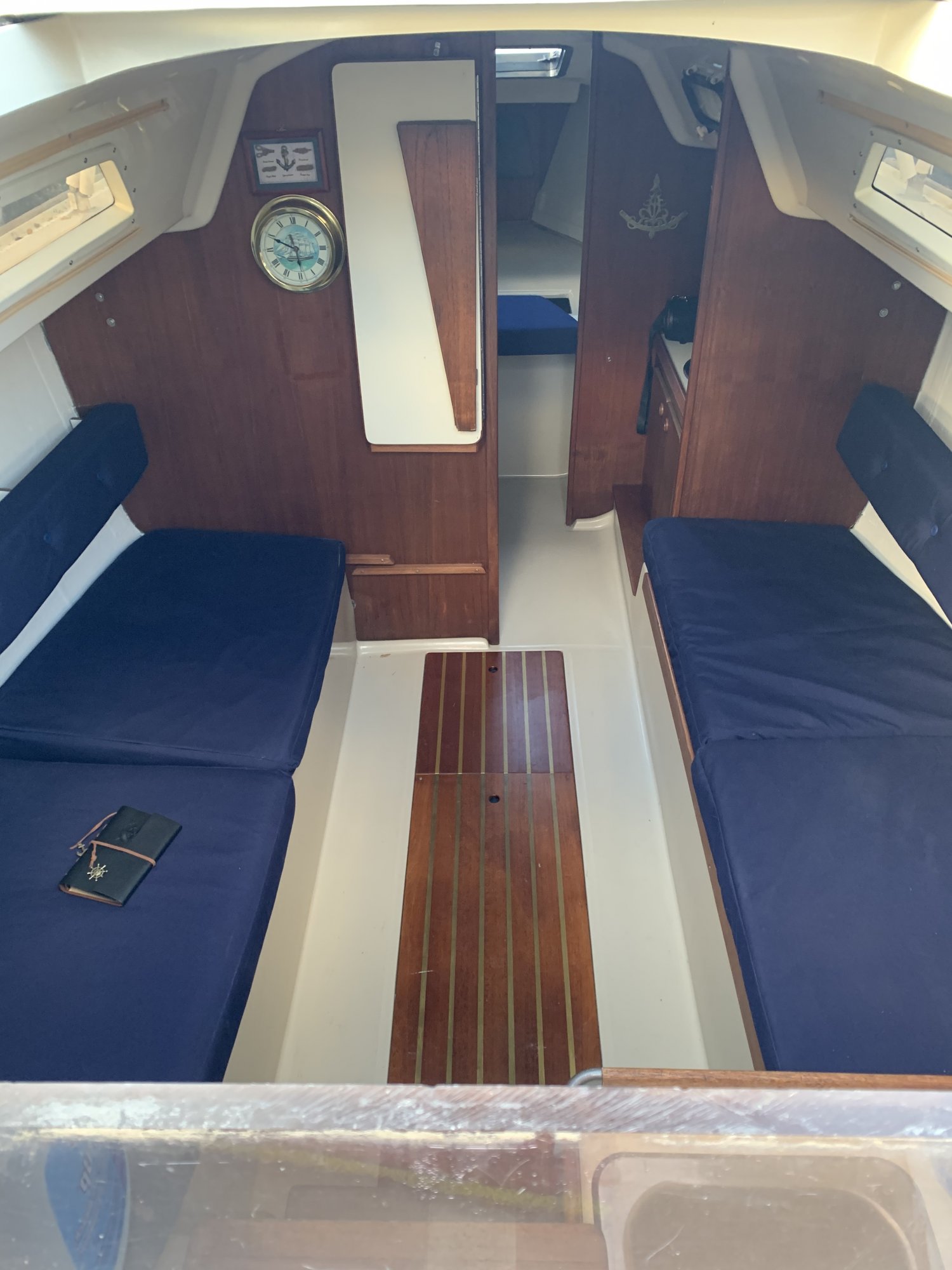

Your interior looks fantastic overall! I do however see a waterstain. O'Day used silicone sealant which is notorious for failing. Expect to find a few leaks. Use Bed-It for deck fittings
