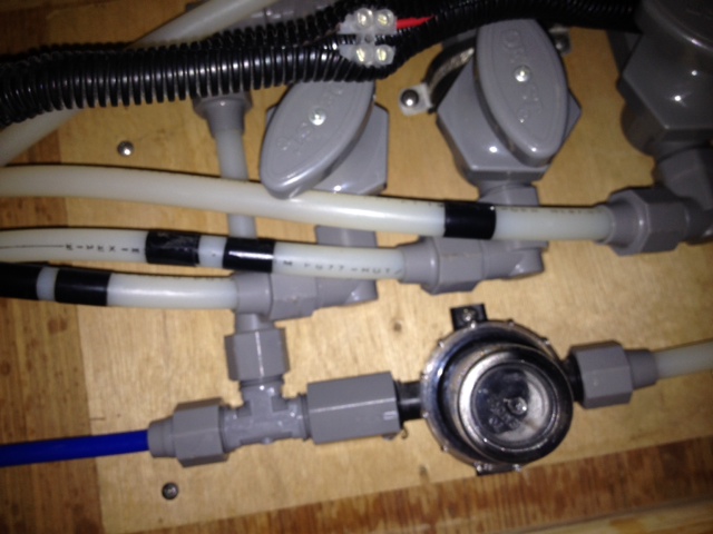

Ninsar
Apr 8, 2013
11
Hunter 450 Preveza Greece
Watermaker output
Yes, pluming the water maker via the manifold works fine.
The water maker has no problem filling the tanks through the bottom..
My setup has been pumping every 10 days for the last year without problems
See photo (attached) from 450cc installation.
The blue line is the input from the water maker.
