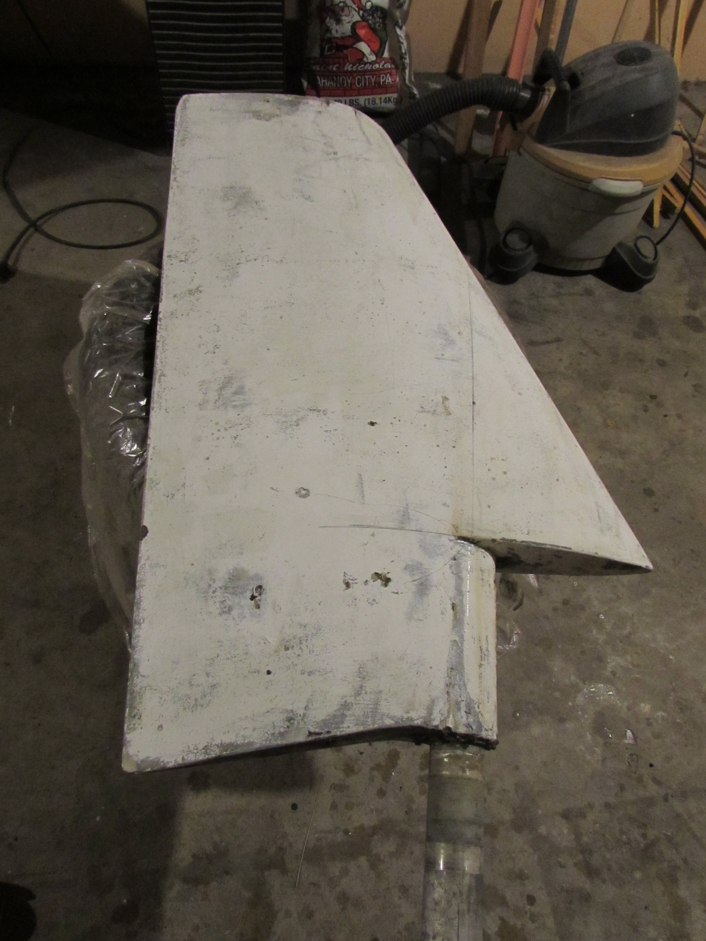

The transom-hung rudder on my Oday 240 is completely waterlogged. My first clue appeared when she was still in the water, and I could not figure out why she was no longer sitting on her lines, and looked about 3 inches low in the stern. I got the second clue after we hauled her and I lifted the rudder off the gudgeons and realized it weighed at least 80 pounds (Rudy tells me the weight of the rudder was only about 30 pounds new). Finally, I laid the rudder down and drilled a quarter inch hole through the fiberglass skin, just into the foam, and the hole quickly filled up with water.
The rudder is now in my basement to prevent further damage from freezing, but there’s no way I’m going to put it back on the boat in the spring in it’s current condition.
Any thoughts on a repair? The guys at the marina suggested that the water may be getting in from either or both hairline cracks and the center seam, and repair would involve a lot of time to dry it out and a lot of time sanding and applying epoxy over every potential crack and along the seam.
If I go the replacement route (much easier, but a bit more $$), it’s probably the fold-up rudder from Ruddercraft. Anyone have any experience with them?
