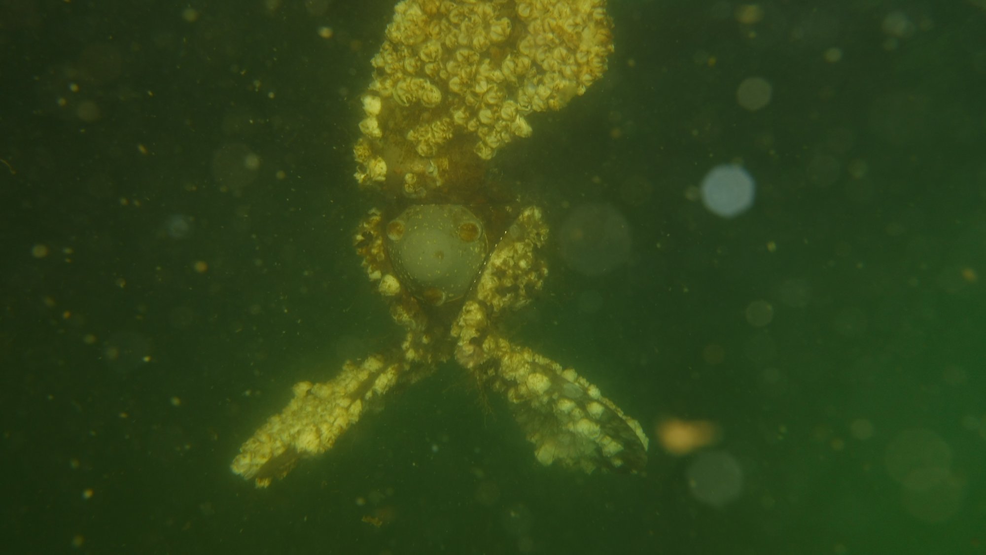

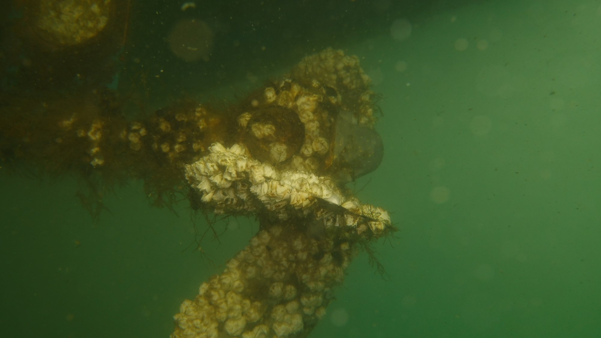

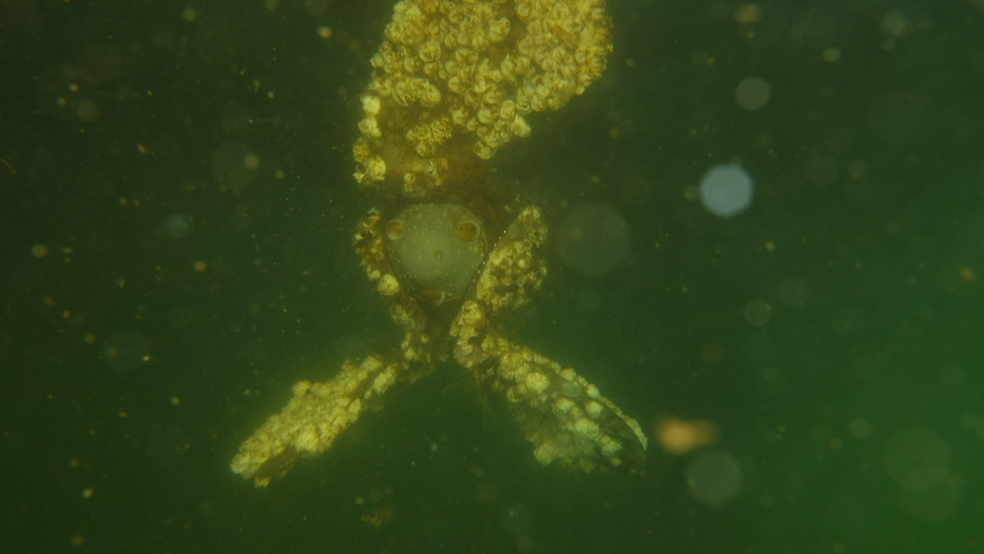

One spring, 4-months after I had a diver clean my hull and prop and replace the zincs, I headed out to do some crabbing. It had not been used during that time, but this was not an unusual situation and had never been a problem before. As soon as I left the dock, I realized that something was wrong because I could not rev to more than 1500-rpm and had a lot of vibration. Surprizingly, I was still able to make 5.4kts which was much faster than normal for 1400-rpms. The diver I had been using was unable to get out for several weeks. Fortunatly, I have a couple of freinds who are dive instructors who had just gotten new dry suits and were looking for an excuse to NOT get wet. This is what they found.:yikes: :facepalm:

Then the diver cleaned the prop, he had just knocked off the bodies of the barnicles but did not scrape off the white bases. The new growth then had a foothold and came back worse than ever.
Since then, I dive my own boat. It saves me $200 twice a year and when I dive, I might have a handful of barnacles.
My experience exactly. A few giant barnacles growing on your prop will throw everything out of whack. The diesel will be overloaded, won’t get up to normal operating revs, and will smoke.
I dive my own boat too.
