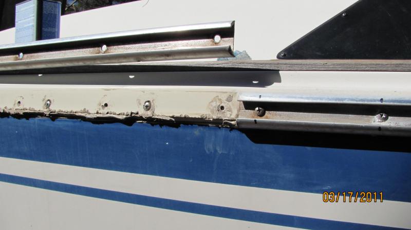

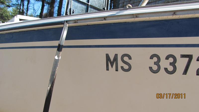

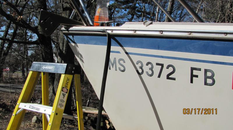

I removed the rubrail and found that the hull / deck joint was not sound. The deck glass overlaps the hull glass. Machine screws go thru the deck glass thru the hull glass and into a wood stiffner epoxied to the inside of the hull. The joint was not sound in that some of the screws were missing and some of the deck glass was missing (had chipped away) where the screws had worked loose. Water had gotten into the stiffner. There is no access to this stiffner from the inside of the boat. Putting additional screws thru the deck overlap into the stiffner did not work since the stiffner was wet. Faced with this situation I felt the most cost effective solution was to install the rubrail and caulk both the bottom and top of the rubrail at the hull. This worked but is a continual maintenance issue since the caulking can fail when the boat bumps to dock. Lack of access to the hull/deck joint from the inside of the boat is a problem.

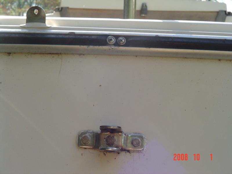

Joe, your pics helped. I know we talked about this before but I don't remember those photos. They make it pretty clear what I have to do. What I did not understand was that there were separate joint screws and molding screws. Doing both sides sounds like a good plan.
Did you caulk all the screw holes you were going to reuse and run the screws in before the caulk set up?
Did you caulk at the lip that goes under the joint?
I'm wondering about using MS's butyl tape for bedding the gunwale after caulking all the joint screw heads.

Joe, your pics helped. I know we talked about this before but I don't remember those photos. They make it pretty clear what I have to do. What I did not understand was that there were separate joint screws and molding screws. Yes. Well, once you get one of the moldings off you'll see the screw heads that hold the deck to the hull along that seam. Doing both sides sounds like a good plan. Doing the whole thing is a good plan if you've never done it in a long time. One year I had leaks up the ying yang in my cabin. I read in one of my boat books that a common house hold cleanser like "Zud" will take the stains right out of Fiberglas Gelcoat. Well, it did. It also ate away all the caulking under my gunwale moldings. :cussing: I the gunwale moldings my boat on a warm summer day in my driveway next to my house and I was able to do it in no time at all, just doing one side of the boat at a time.
Did you caulk all the screw holes you were going to reuse and run the screws in before the caulk set up? Yes I did and when I put the moldings back on, I put a small dab of caulking on each of the screw threads as I screwed the moldings back on.
Did you caulk at the lip that goes under the joint? My deck has a lip that fits over the hull joint under the moldings. I saw no need to caulk it. You can use your own discretion on that. It can't hurt to do it and I don't think you would use that much caulking.
I'm wondering about using MS's butyl tape for bedding the gunwale after caulking all the joint screw heads. You know Ward? Butyl tape is great for some applications like bedding a hinged tabernacle, side chainplates, or a bow stem chain plate because these pieces of hardware are secured with bolts. You know that if they get banged or disturbed in any way, they're not going to move and cause leaks, but anything that is held on with screws like toe rails and gunwale moldings needs to be adhered at least where the screws hold it in place. I would stick to one type of caulking. Water is going to get into that molding regardless, but you want it to drain out.
I think that once you get those moldings off you'll see all the spots that need to be caulked.
