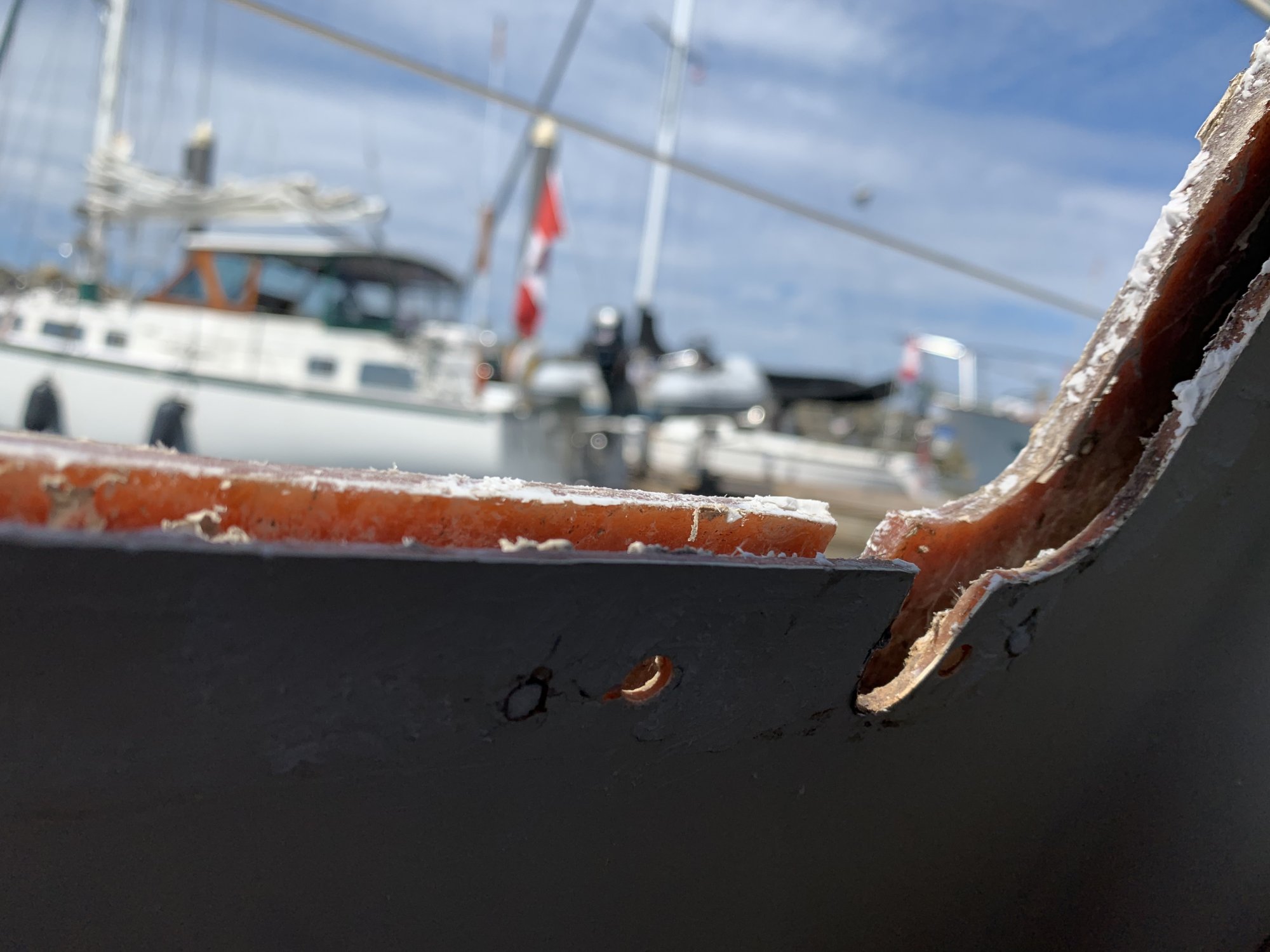

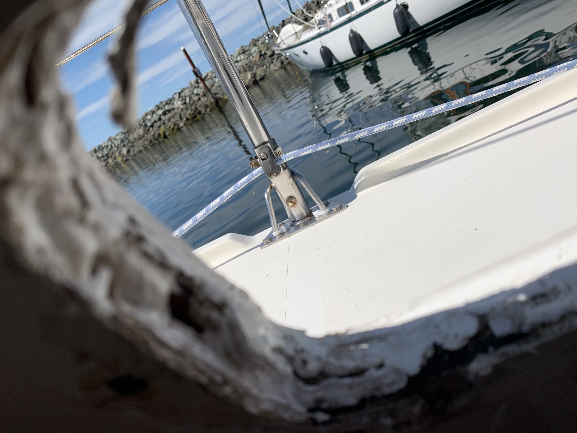

Window/chainplate leakage. Mine was from the windows...re-bedded all openings on my 37, problem gone!
