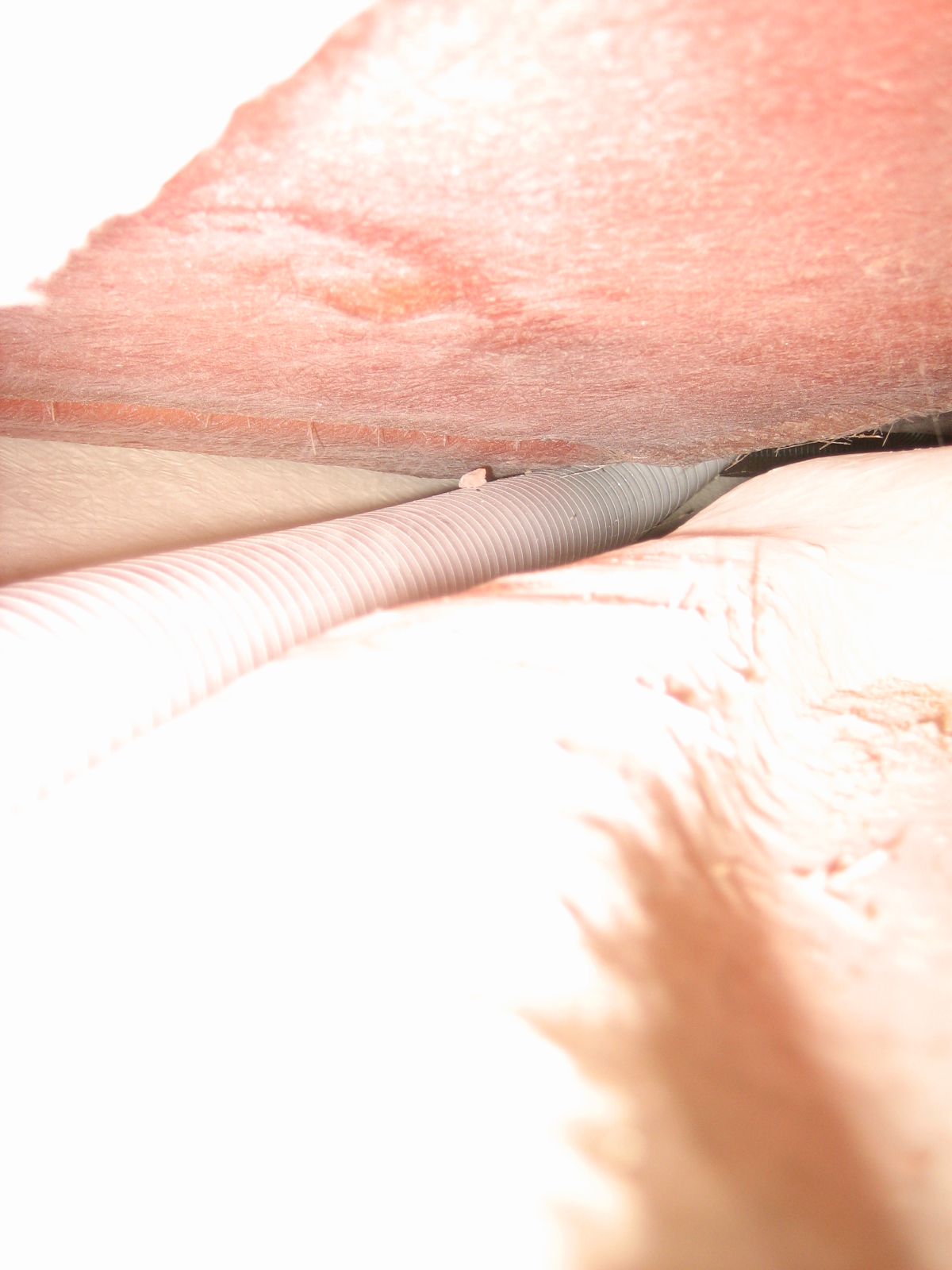

Robert, I believe there may be another floor or pan on top of the ballast tank that the head sole rests on. I think it may be part of the pre-molded cabin interior unit. Included is a picture I took this weekend looking forward from the port side bilge access under the rear berth. I couldn't see forward, so used the camera as my "eye". You can see the waste hose along the front edge of the ballast tank leading from the toilet aft to the holding tank.
If there is a gap (which I believe), I'm not sure why you would hear water squishing unless there is an awful lot of water in the boat, or it is sitting atop the ballast tank, or there is some balsa core stiffener in the sole that has become compromised. Our 2004 model head sole is composed of gelcoat (the teak floor does not extend into the head area). If yours is teak, it may be possible that water has found its way underneath.
I'm just not familiar enough with that portion of the boat to provide good advice. Hopefully Crazy Dave Condon or George Kobernus will chime in with some ideas for you. Hunter Marine may also provide some insight as to the construction method in this area. Because of the close distance between the sole and the ballast tank, I personally wouldn't be drilling any holes until I knew exactly what was occurring.

Thank you so much. The pic is very relevant.
This week-end I will looking into the port side bilge and let you know.
Since I have just a porta potti, no pipes should be in the area and I believe I will be able to check it better.
Even I am thinking to run a small plastic pipe and aspirate the area should I have room. That may be also the cause of the bad smelling I found in the boat recently.
