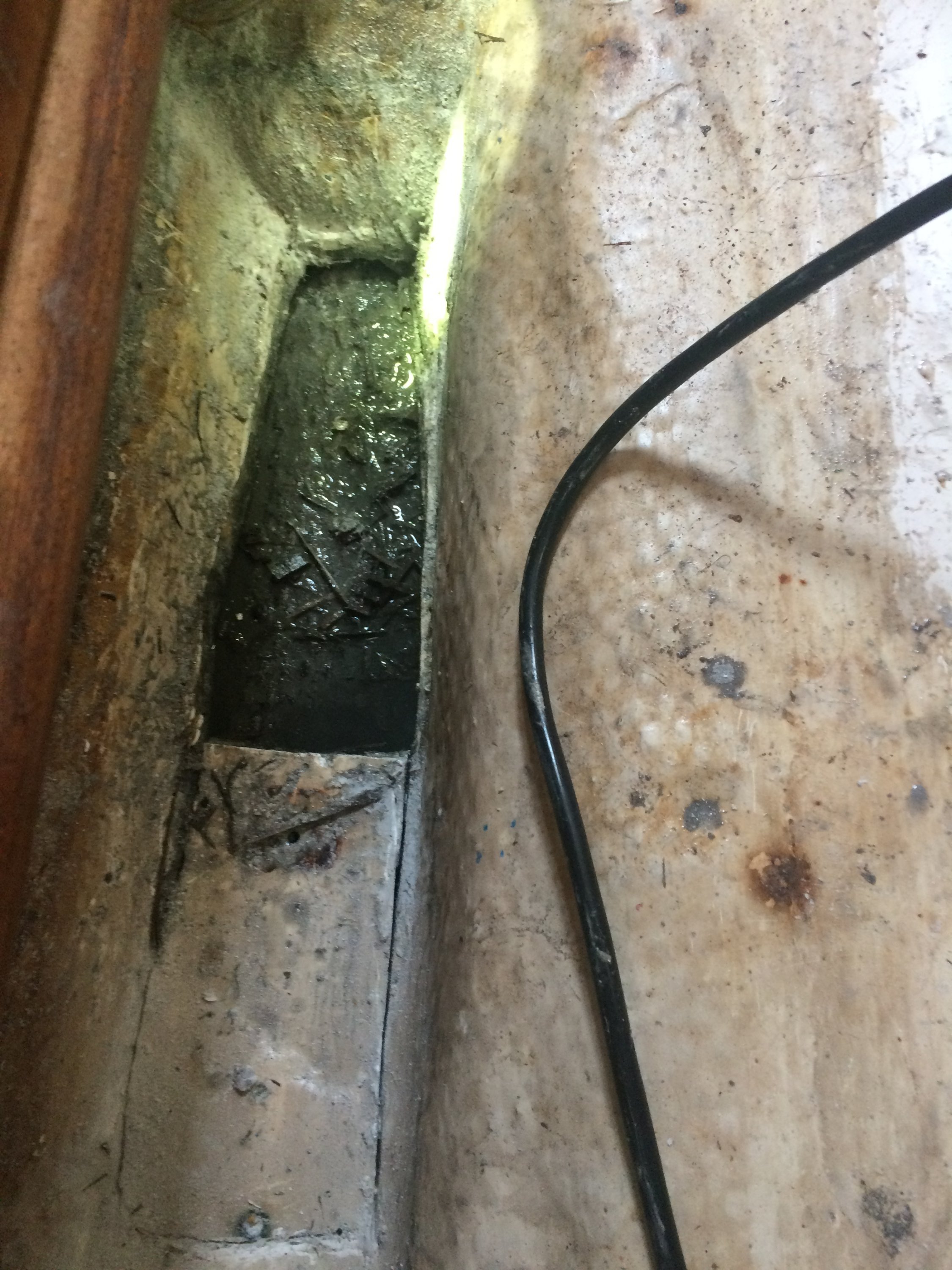

Hello,
I was running some new power to my bilge pump when I took a picture under the cabin sole. There was the typical circle cut in the hull to provide a pass thru. I put my phone up the pass thru hole and took the attached photo. It does not drain to anyplace. See photo for image and an idea of what the heck I am talking about. Many Thanks!
10,197
I can't be of help on this one, Bill.. I've not noticed that on my boat. I suspect that it is trying to drain into the false bilge space but because that space is capped in the visible bilge, the water has no place to go until the level builds enough to get it into the visible bilge via the limber holes.? I dunno.

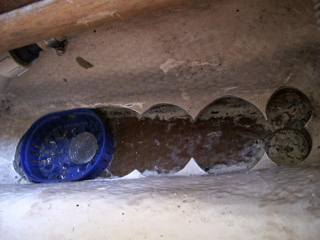

False bilge in H-34 and I think H-31.. the liner had a part that inserted into the bilge pocket.. the liner never was perfect so there is a space of about an inch between the liner and the hull in the bilge pocket.. That little thin fg deck and thin ply spacer was probably supposed to have been removed at manufacture.. but wasn't.. removing the little false floor gives the trapped water a place to drain to.. I think there are passages fore and aft, but not on the sides.. my pic shows it half removed and the gooky stuff underneath.. boat smells much better after cleaning and actually getting the bilge water out.

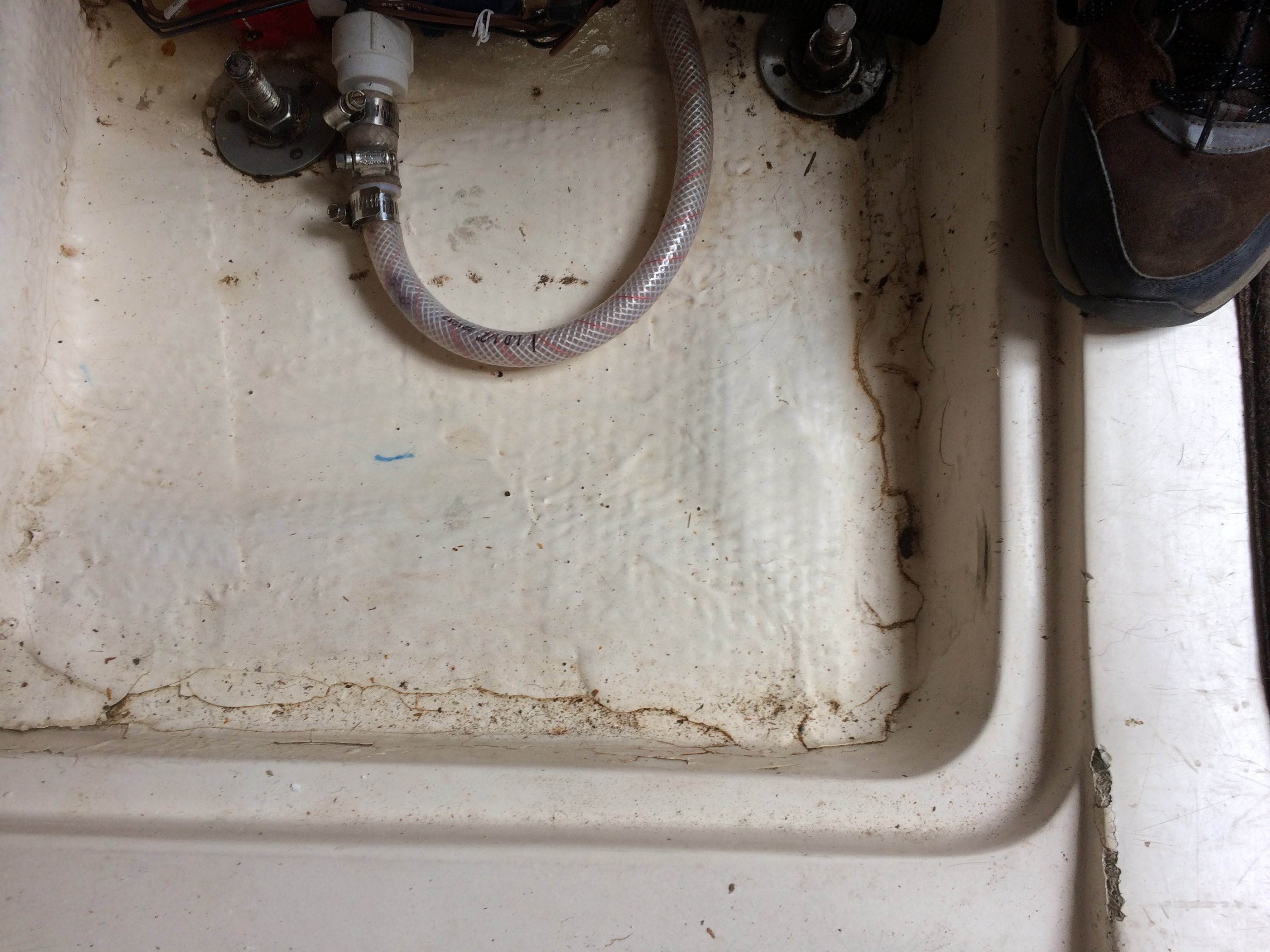

1981 H27 owner here..
Here's a pic of the bilge beneath the floor boards. And, yes, water does migrate along the stringers.

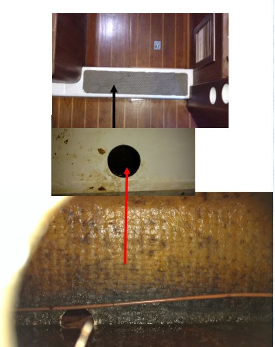

Hi Beth & Bill
Look at my post "false bilge issue Hunter 34"
Shows the step by step modification with pics.
Your pic looks like the hole shown is thru the bulkhead stringer.
If I am looking at the pic correctly the hole shown is for running wires up the hull to the circuit breaker panel and to the shower sump. Water should not be inside that bulkhead, it is not part of the false bilge.

Ken13559
Did the pouring bleach thing for 30 years and the smells always
Returned a week later.
Since I did the modification and got rid of the 30 plus years of sludge and flushed it, all smells are gone.
Only way to really get the smells out is remove the source and not mask it.
