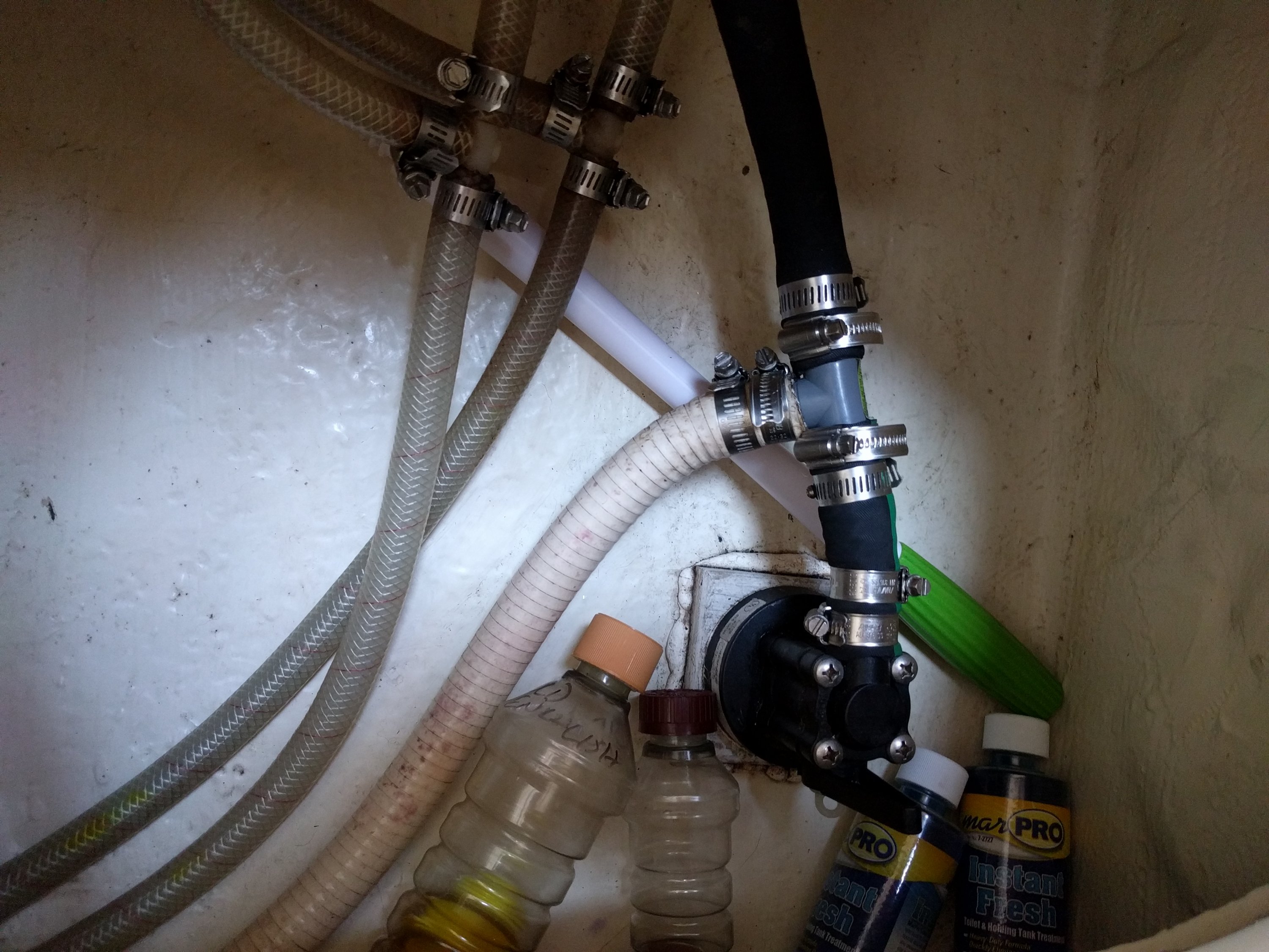

Here is a pic of the "Peggy Upgrade" on the 310. For no. 1 you can switch to wet and flush and it pulls enough water for that fine. For no. 2 we put the drain plug in and flush for super flow. Cleans the bowl nice and quick. If we are ever going to leave the boat for a few days we close the through hull, fill the bowl with water and flush it through.
One tip, after opening the through hull you may need to prime the hand pump. With the through hull closed put some water in the sink, just enough until you can see it in the drain. Give the head 2-3 pumps until you see the water drop. Open the through hull and give the head 2-3 pumps and you are good to go.
Great upgrade and it freed up a through hull for our watermaker.
Good luck,
Jesse

Another piece of advice, this pic was taken before we added a course mesh strainer to the line. In the Caribbean it's not uncommon for baby octopus to hide in through hulls. Then you flush and they get sucked up and wedged in the rim of the bowl. I had a friend get 2 in 2 weeks. There is nothing that smells quite as bad as the sweet and sour stench of decaying octopus. And you can't get into the bowl. So you just have to let it decay and come out on it's own. After smelling that on his boat I added a course mess strainer so any sea creatures would get caught there and not in the bowl.

Thanks Jesse. The picture is great. Getting this done as soon as the weather permits.
