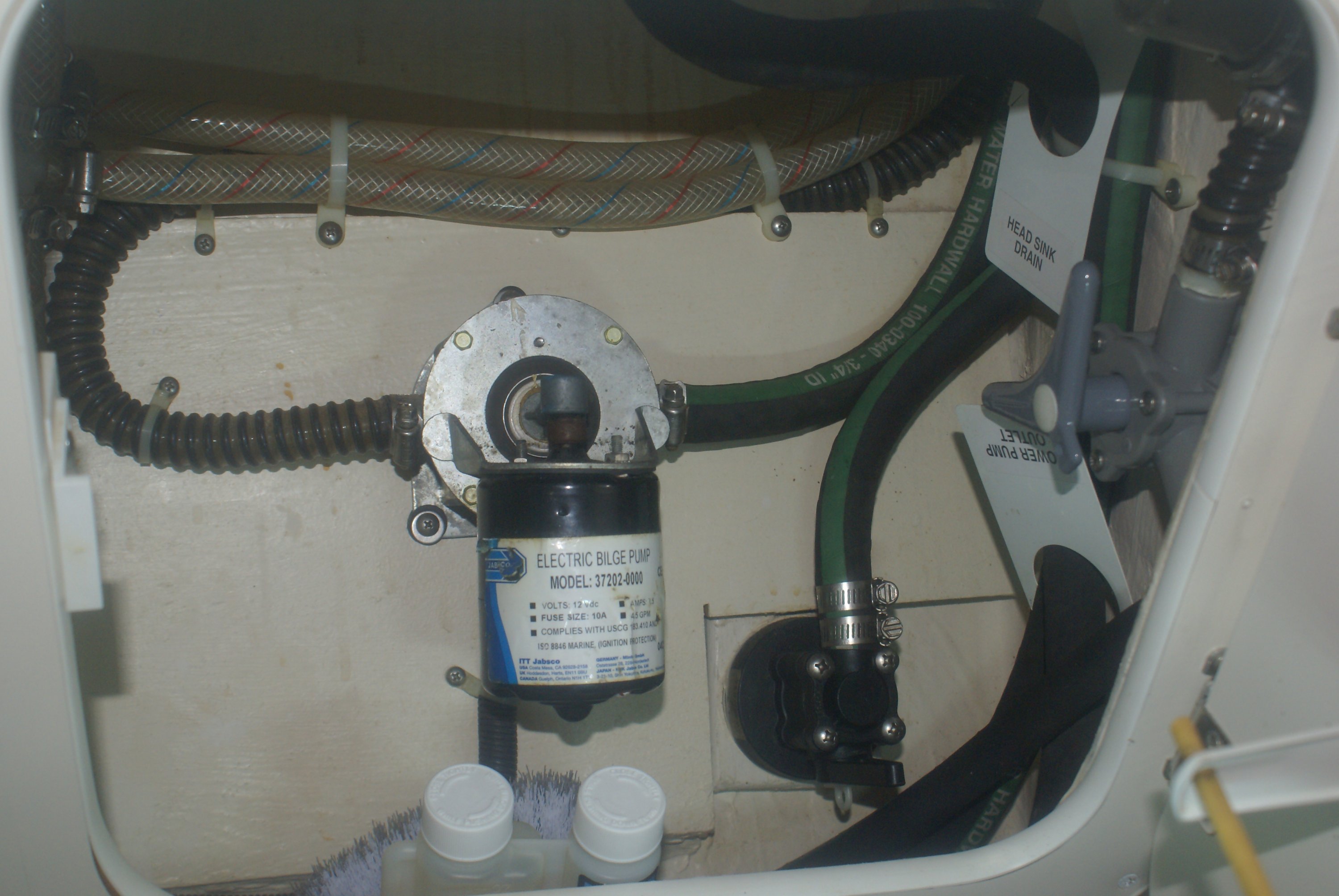

Fresh water flush. This is what I did when I swapped out the WC Head mate pump for the Raritan pump (I retained the WC bowl):
- Disconnect the raw seawater feed line to the head. Get a 3/4 plug and two hose clamps to seal off this line
- Buy four feet of 3/4 hose and a 3/4 T fitting. attach one end of the hose to the raw water intake of the head
- Run the hose up through the hole where the shower drain hose feeds in into the area under the head sink. It fit in my boat with no need to enlarge the existing hose
- Cut the head sink drain hose about six inches above the seacock. Insert the T (two hose clamps on each barb)
- Attach the hose from the head
To use:
- Keep the head drain seacock closed
- Turn on the fresh water pump switch and fill the sink to the desired level of water
- Use the shower head to put water in the head bowl, as desired
- To empty the head, turn the head valve to wet flush and pump (assuming manual head). This will draw water from the sink, through the T into the head, flushing the bowl.
- When no longer drawing water into the bowl, switch to dry flush and continue to pump everything to the holding tank
- Turn off the fresh water pump switch
This will use more fresh water. If you are on a long voyage, a stopper in the sink can be used (you need an air tight seal). Then open the sink seacock and you will draw in seawater through the T. That water will have tiny creatures in it. When they die in the lines, they will create oders. Flush the lines with fresh water once a day and you should be good.
Suggest you keep all seacocks closed unless they are in active use.
Not a good idea to put soap or anything else into the holding tank but human waste and product to promote aerobic bacteria in the holding tank. I defer to Peggy. Get and read her book!!!!
My before picture attached. I will try to remember to take the after picture and post.
