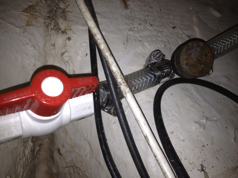

When you're done pumping it out this year, consider adding something like this inline. This way I just close the valve, take a short length of hose and connect it to the male connection and put the hose in the sink and open the valve. Saves running the pump.
When I'm done I close the valve, hook my antifreeze tank hose to the connection, run the faucets and voila, winterized plumbing.
If you have a water heater, you may want to isolate it so as not to get antifreeze in it. That's a different set of pics!
