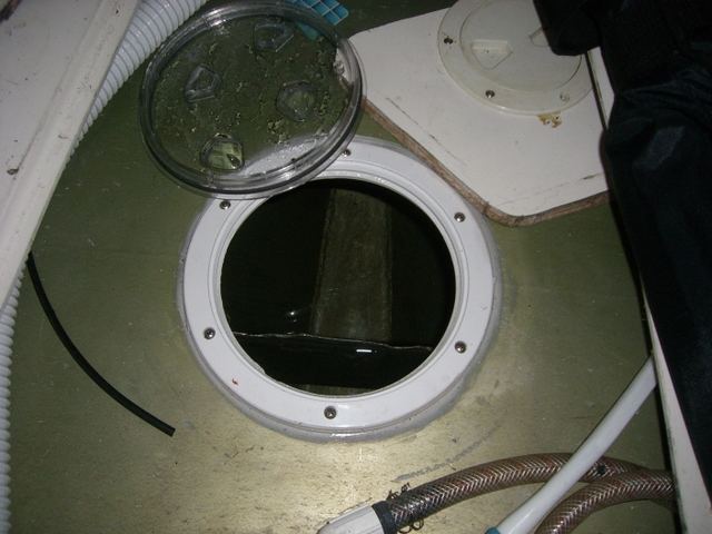

H hh water tank access port, plastic dip tube.
Picture of top of water tank with 8" Beckson clear cap access port. Internal baffle can be seen inside, top of plastic dip tube just visable at bottom of picture. This should give you a better idea of what you'll find.

Sam--
Does the 8 inch port provide sufficient access? I was looking online and noticed a number or rectangular ones for a little more $. In retrospect, do you think you could have used a little more access? I'm an hour away from my boat so I am speculating that a 10x12 one could fit in.

The 8" round port is just adequate. It allows me, with a bit of work, to accomplish what I have to inside the tank. I had considered using a rectangular hatch but felt there was too much chance of warpage causing a corner to lift, breaking the seal and allowing water to slop around. The round port's threads draw the cover evenly onto the annular seal (like that big word?) and maintain positive seal. I set the base in silicone but I'm sure someone will have a better idea for a bedding solution.
When I clean the tank I use a dedicated crevace tool on my shop vac to draw out the remains of liquid and a long handle commercial style toilet brush that allows me to scrub inmto all corners easily. I hardly ever mistakenly use it on the toilet. The coating I used (KBS Coatings) is a sloshing compound for fuel tanks and the like. As I couldn't roll the tank around to distribute the coating I used a "radiatior" paint brush which has a long handle with a crook at the brush end. I poured the coating in the tank per instructions and painted up the walls and cieling of the tank till the stuff set. BTW; I did my aluminum fuel tank with the stuff too but that tank is easy to get out so I was able to roll it to distribute the coating. I was also able to allow the fuel tank to sit in the full sun for a few days so full curing was quicker.

I opened up the tank yesterday and it was as thought, a corroded draw tube. You were not kidding about the ecosystem living in that tank. I will give it a good cleaning and leave the coating until haul out. My immediate thought was that the diesle tank needs the same so I;ve added that to my list.
