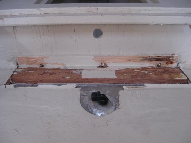

First my personal recommendation is to replace the tank with a new aluminum 37 Gal. (same size as presently in S2 9.2 sailboats). This is the original tank from Fl. Marine Tank. Inc. dflori@fmtanks.com . Presently made in Henderson, N.C. (shipping). New quoted cost $425.00 + shipping, 4 week delivery time. The old aluminum tank is .090 aluminum while the new tank is manufactured out of 5052-H32 .125” aluminum. No baffles required. Aluminum can outlast the life of a boat if installed and maintained properly. Refer to article at www.yachtsurvey.com by David Pascoe. The S2 sailboat is well built, but they did not install the water tank properly, my tank bottom is flat on top of the deck below it and is also foamed in, which when wet causes “crevice corrosion” because of the lack of oxygen, on the aluminum surface, this is the area where I found most of the large holes (photo attached). I cleaned the tank with clorox and used to much, a no-no. I received tank replacement quotes from the following web sites.

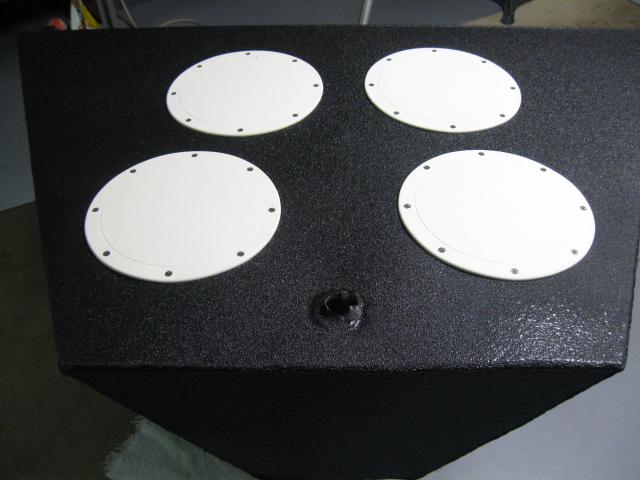

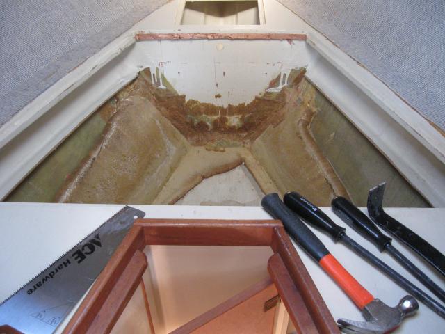

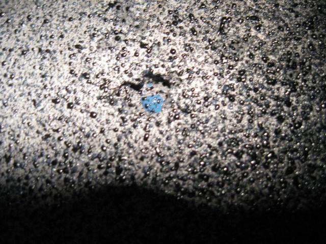

More photo's attached show that I opened the tank and installed four inspection and clean out ports. I am retired which allows me the time, also curious, cheap, always need a challenge, have the tools and try to keep in shape by Roller blading frequently. I had a welder look at my tank, he observed the many pin and larger holes and said he would save me money by not having him weld it. I than took the tank to local Line-X dealer, they do a spray-on composite made with Dupont Kevlar (photo attached) www.line-x.com. I also sealed the seams inside the tank with a NCS coating from ecosmartepoxysystems.com which you can apply either with a brush (thinned) or putty knife. Total cost for coatings, hatches, misc. about $325.00. Plus all my work and time $0.00. All of the above information is potable water safe. After searching many types of sealers I found most, if not all, are non-potable water approved, including Marine Tex, Gluvit and other epoxy. My reasoning 1. I could reinstall the tank in the same way it was originally 2. saving work in not adding hold down straps 3. keep the baffles which I believe are necessary (when full there is 309 lbs of water moving around in a enclosed area) 4. be able to clean it out again in the future and 5. no waiting time for a replacement, always in a hurry! I recommend replacement with a new tank simply because of the small difference between the cost of new tank and my repair approximately $170.00 plus new proper installation. The hardest part was removing the tank from the compartment it was stuck fast to bottom. Originally found only one hole which grew larger and another hundred pin holes appeared after a presser washing. This is why I opened the tank top. S2 owners, plan on replacing your tank if you haven't done so already.
