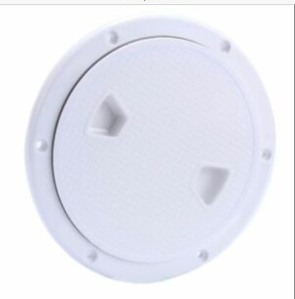

If you have enough access, you can cut a hole in the top that can be capped with a 6 inch inspection port.
