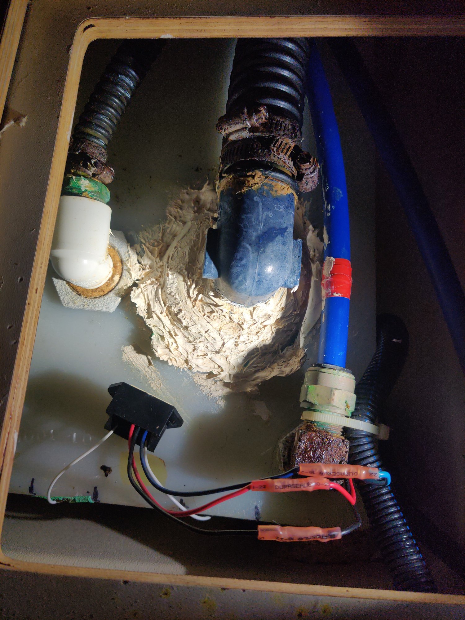

I have a 2005 41DS. It seems I have a problem with getting water out of my tanks. I have removed the line from the pickup, placed it in a bucket and it works great. So the lines are clear from the top of the tanks to the filter and pump. I took compressed air and blew it backwards into the tanks, it does gurgle a lot so it seems clear. Reattached the lines with no improvement. I am unclear as to what's inside the tanks for the pickups. I can't get the elbows off of the tanks to pull out the pickups, pipe dope is now solid. Apparently there was a problem with the fill line on my port tank. It looks like the P.O. used a case of caulk to seal it up. I reached out to the P.O., but didn't get a response yet.
Any ideas of what my next step to figure why I am unable to pull enough water out of my tanks to maintain pressure and volume? The starboard tank outwardly appears fine and undamaged, but it has the same problem.
For some reason this was overlooked during the survey by "The Marine Specialists" Richard Davis ASA.

The pickup tube is the blue line. You need to unscrew the fitting and see if the pickup pipe has broken off inside the tank

I can't get the elbow off where the blue line connects, aged pipe dope. I'm afraid I will damage the tank if I put anymore pressure on that than I already have.

The filter prior to the pump is new, the filter at the pump is clear. When I took the blue line off of the tank and put it in a bucket of water it works perfectly. I did that on each tank. So I think the problem is something in the tank. What puzzles me is that it's both tanks. The boat did sit for several months before I bought it. I blew air backwards into the tanks to clear anything in the pickup lines. Still not any better. What are the pickups in the tanks made of and what do they look like? It's going to be a real problem to lift them out of the tanks due to all the ancient pipe dope they are sealed with.

From where the blue line connects to the tank, seems to be clear since it worked great when I put it in a bucket of water. That test eliminated the tank itself out of the system. I would like to know what to be looking for when I can finally get the pickup out of the tank, hopefully without damaging the tank itself. I haven't been able to find a drawing or information on the pickup inside the tank. Kind of hoping to have that information before I break out the big wrenches. Or maybe I should leave it to a pro to do it.

Whatever stuff was smeared all over the outside of the tank pickup line may have gotten inside the fitting too.
I assume you don’t have a washout or other way to look inside the tank?
May be time to purchase a washout / inspection port and install…that way you can see inside the tank…
Or yank that gnarly looking fitting off, make sure the pipe/pickup is still there and not clogged, and re-install.

Thank you for the video. I do like the wash out ports. I do plan on installing them on each tank. What do the pickups look like, stainless pipes, or hose? I'm thinking maybe a crack in that above the water level.

I did blow air through the fitting and heard plenty of bubbles. The P.O. was from VA. But kept the boat in FL. If he had it up there in the winter, could it have frozen and caused that damage to the tank and possibly the pickups?

I am not sure what your pickup tubes look like…my old O’Day 322 drains from the bottom of the tank, so no pickup tube.
I expect maybe the same Pex tubing as on the outside, but I don’t know.
It seems really strange that you hear bubbles if you blow into the tube, but cannot pull water out…
I am sure it is not a huge problem, but certainly frustrating after having bought the boat.
Maybe get the washout ports installed, then you can see inside and figure out what is happening.
