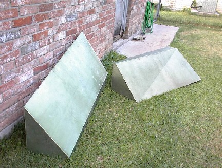

Also see photos. . .
of Ron Pearson's fix in Related Link. He removed his and is making new ones from plywood and epoxy. Just removing them would make them much easier to repair I think. At any rate I believe you will have to cut the top of the settees open to have room to make cleanout ports. You need to get between those baffles that Gene describes. Picture is of Ron's tanks. They look so nice. . .from the outside.
