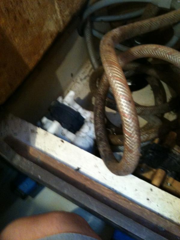

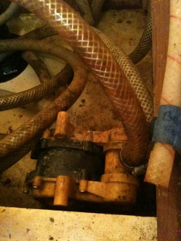

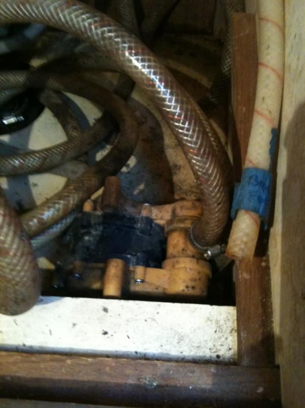

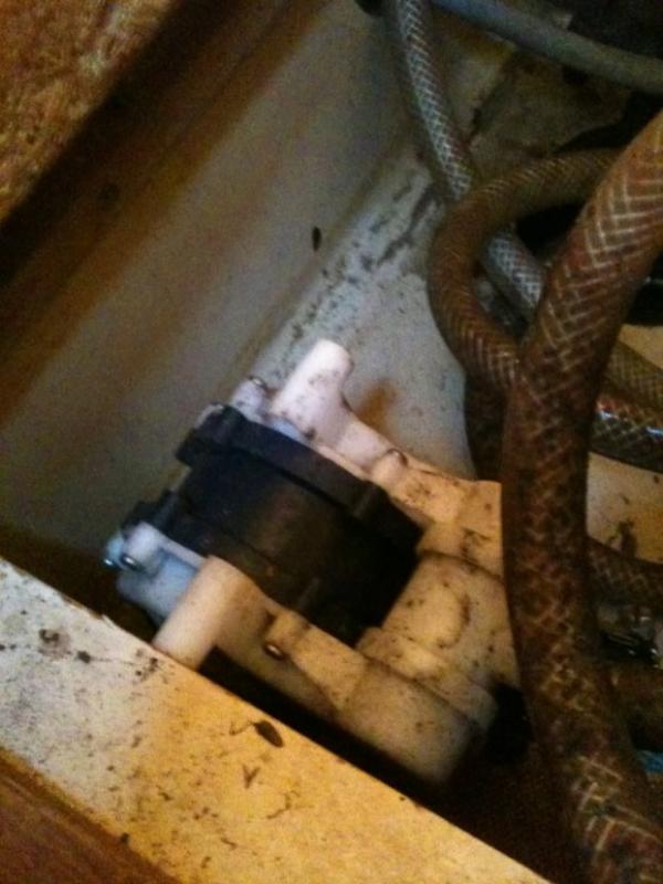

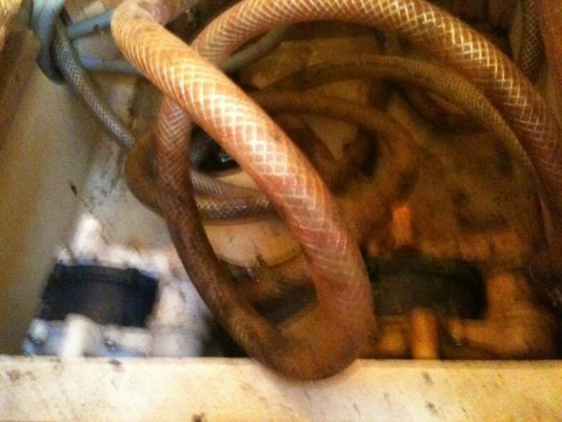

I think I have finally figured out the water leak from my port tank. I poured water over and around the tank and there were no leaks under the sink, as I figured . The water just went into the bilge. The freshwater manual footpump seemed to seep water, however. I removed that and sealed off the hose and it appears the leak has stopped. Need to check it out some more and then replace that foot pump. I have been told that those foot pumps leak after awhile.
Here are pictures of the footpumps mounted under the sink. Not sure where the hoses come from for fresh water (obviously the water tank somewhere) or if it could be teed off the fresh water to the sink faucet (probably not as that is from the pressure system). The pictures are not great, but I also included a picture of the pump from Westmarine. It just screws in under the sink and a hole is cut into the kickplate for the actual footpump to stick out. Intake from fresh water, output to auxilliary faucet by main faucet (sorry...forgot those pictures.....looks like the one pictured from Westmarine)) Hope this helps.

Congrats, looks like you found the source of the leak. Thanks for the pics. It gives me some ideas. Looks like you have a hot water and cold water foot pump? Which raises a bunch of questions concerning how that works with the electric system. Must be a bunch of hoses.
