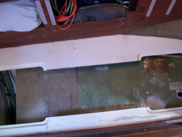

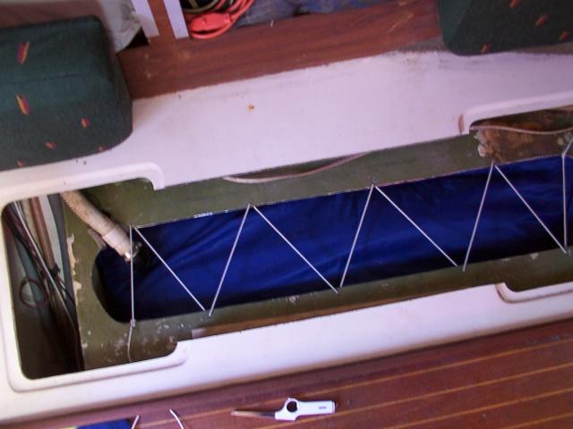

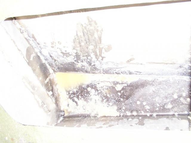

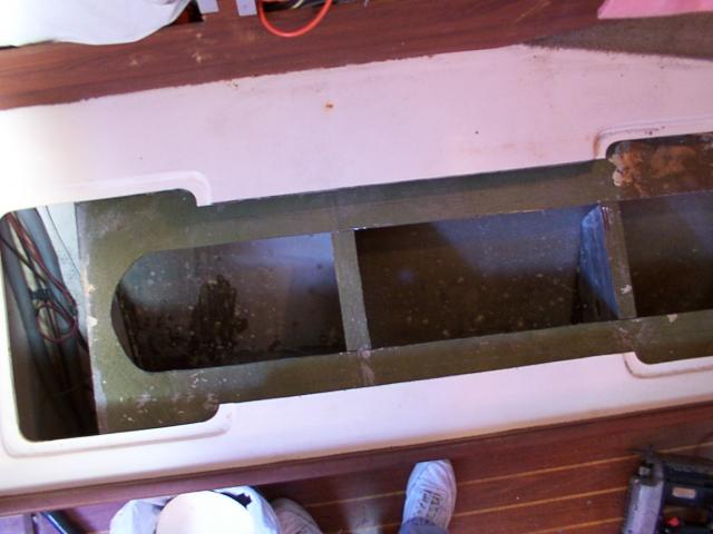

I cut my tank open with a sabre saw-metal cutting blade. I cut the whole top open to expose the baffles. The baffles were cut out with a 4.5" side-grinder with a carbide/metal cutting blade. It took several hours. Wear hearing protection. The second photo is the tank inside. Ther are two baffles in the port tank and only one in the starboard tank. Dressing up the baffle welds with a side grinder and putting down a carpet liner will prevent the bladder (if you go that route) from abrasion damage. Also the bladder was tied in place with a "lacing" of 1/4 line over the top. See photos:
