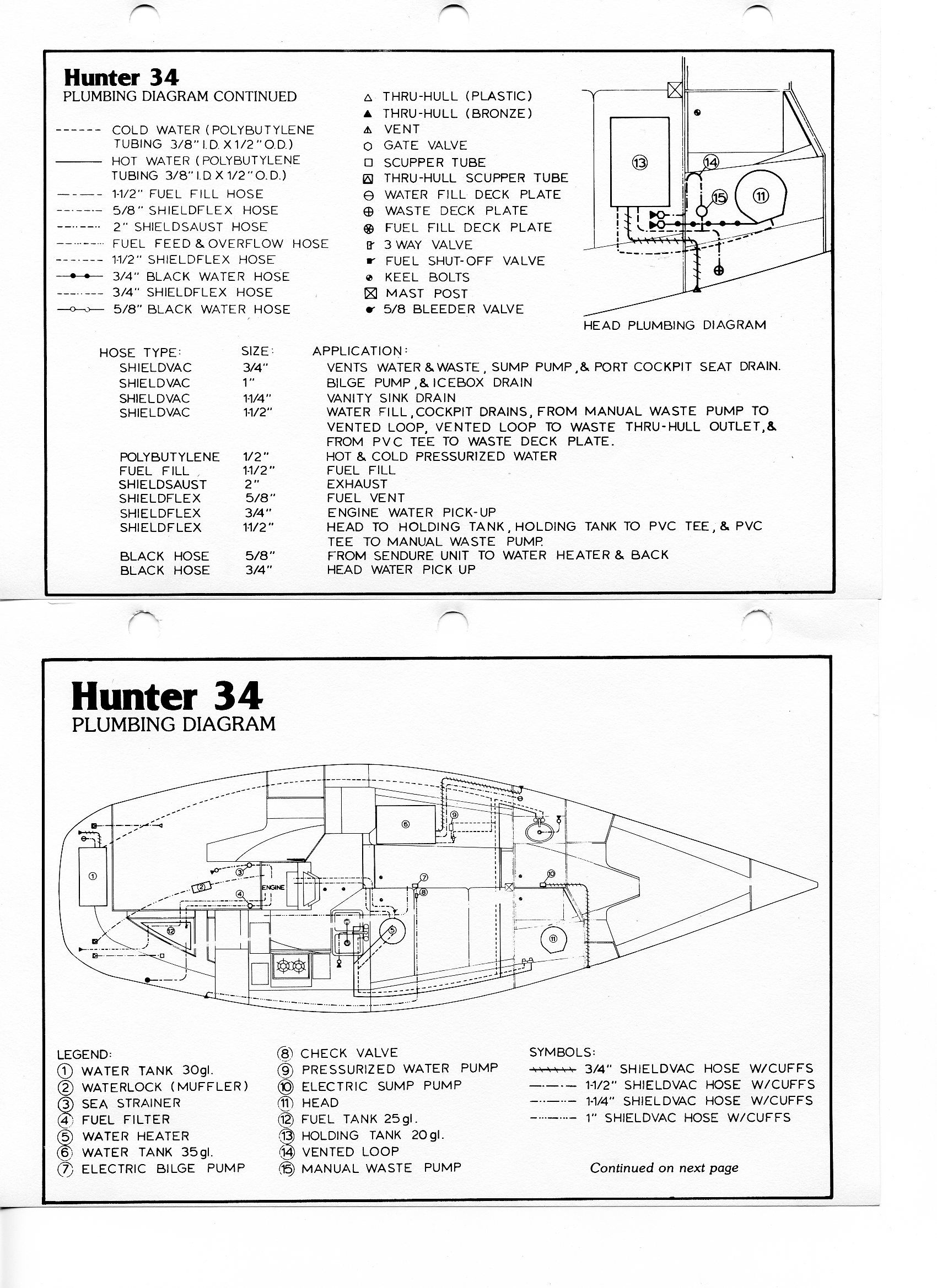

Anyone have a picture of the original Port water tank In a Hunter 34? This is a 1983 vintage and was purchased with the tank missing. It was a odd shaped tank I was told by PO but could not provide any other info. Any help on the plumbing diagrams for this model would be of extreme value also. Thanks
10,246

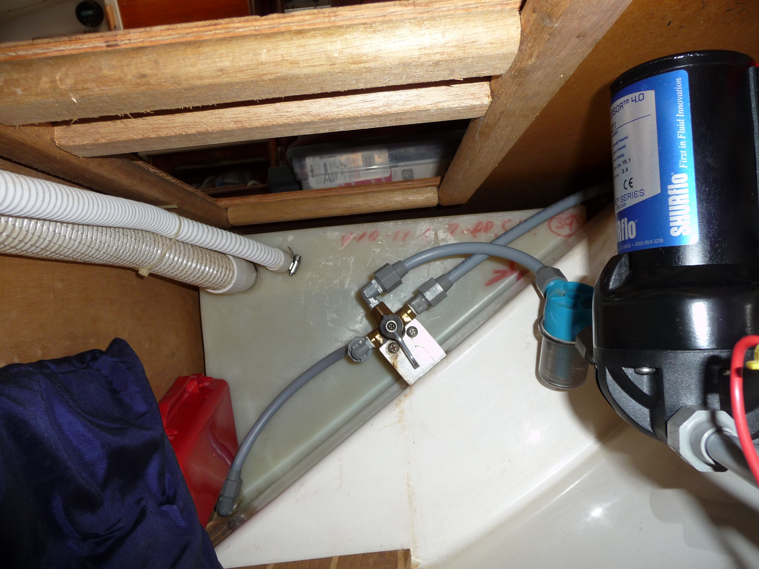

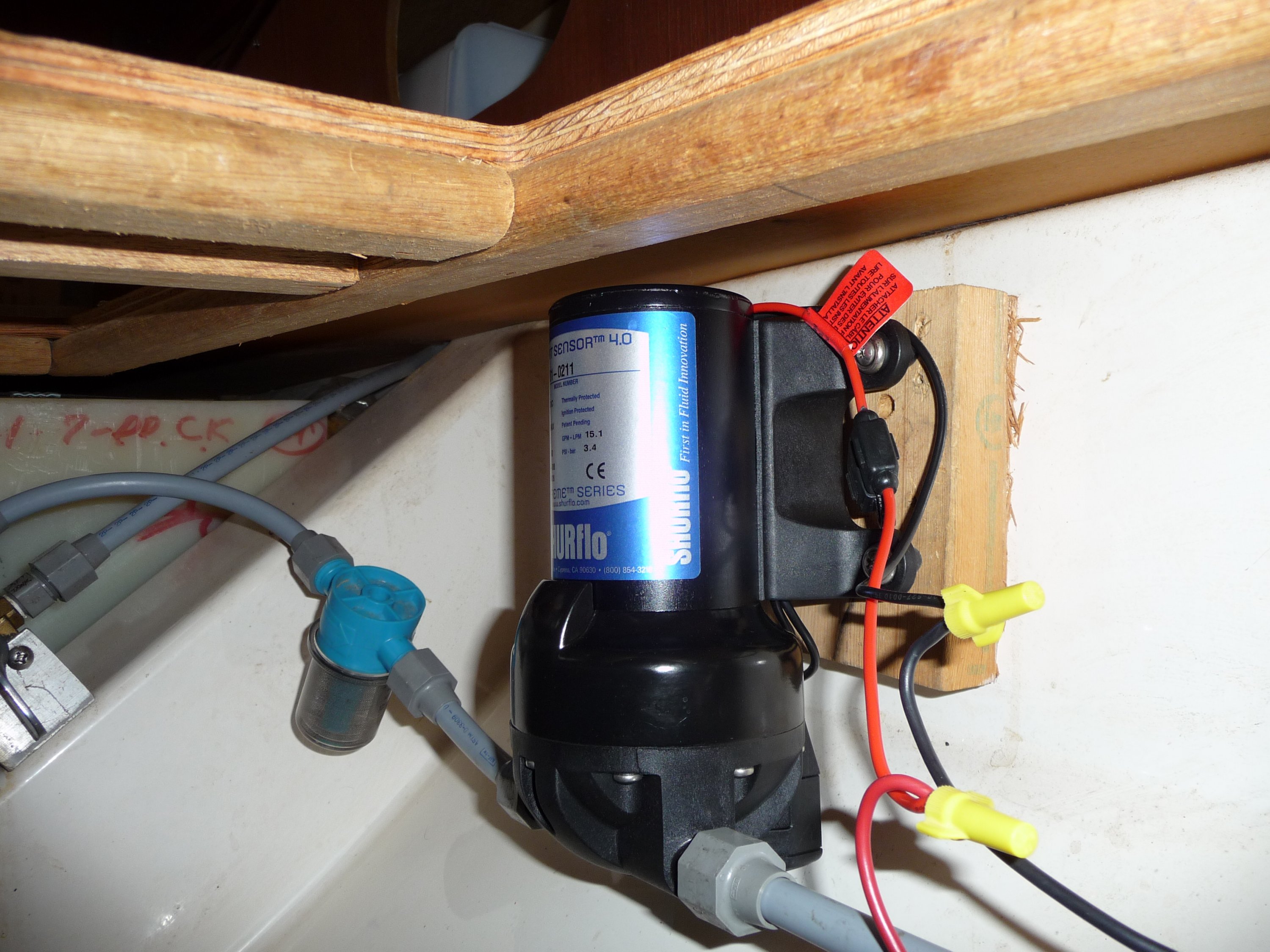

I do have a PDF of the plumbing but I don't have a picture of the tank. The attached picture shows a little of how it fits between the aft end of the seat and the big hull beam on the forward side. Short vertical on outside, long vertical on inside, slanted bottom .. holds 35 gallons.
EDIT: The tank looks to be resting on the big beam but it is aft of the beam and extends down to the curved hull liner.

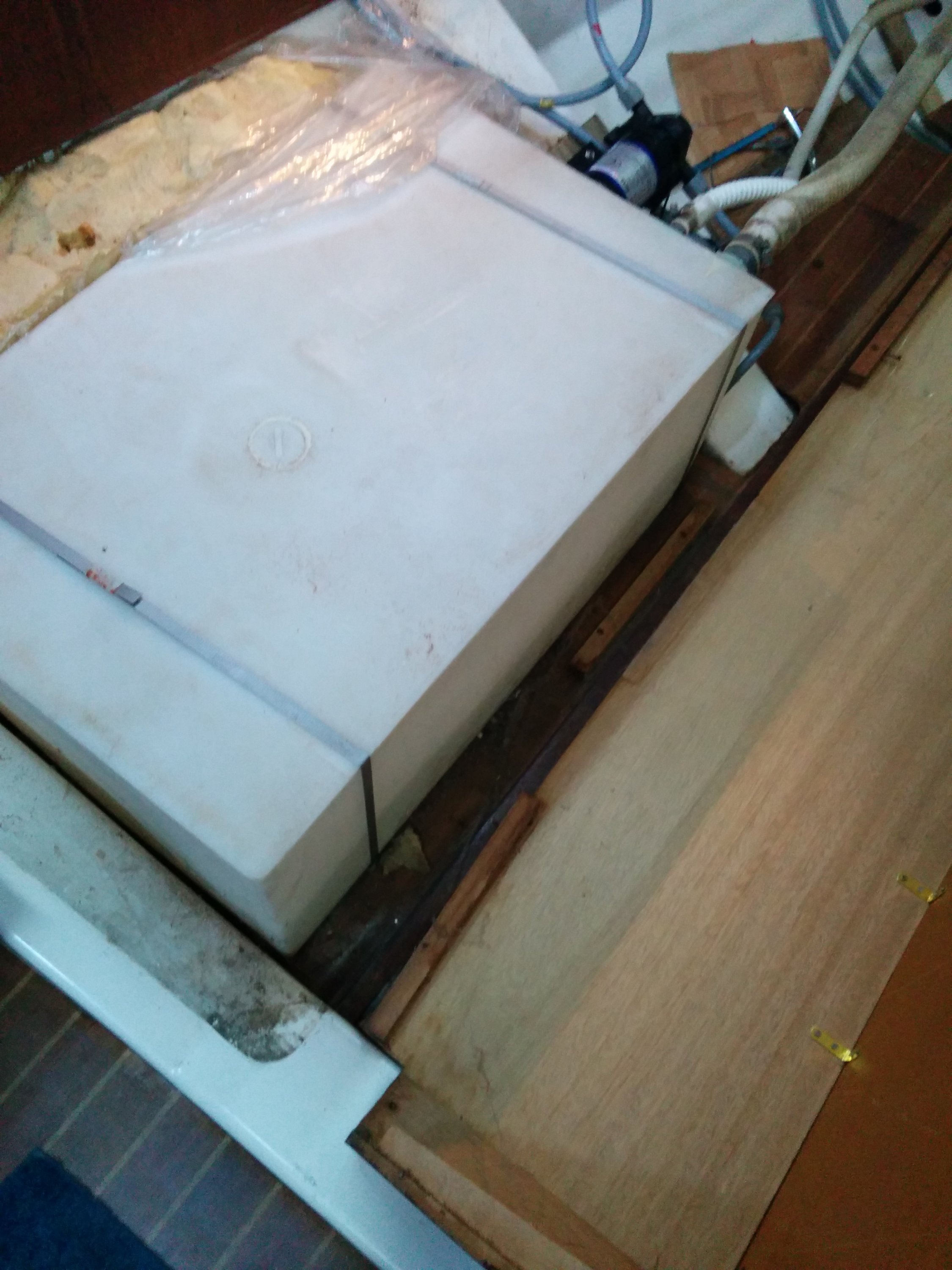

This is the only picture of my water tank that I have.
There is spray foam insulation between the tank and hull.
Maybe between Kloudie's picture and mine you can make out the shape.
You still have the rear water tank right? I think the rear tank is 30 gals.

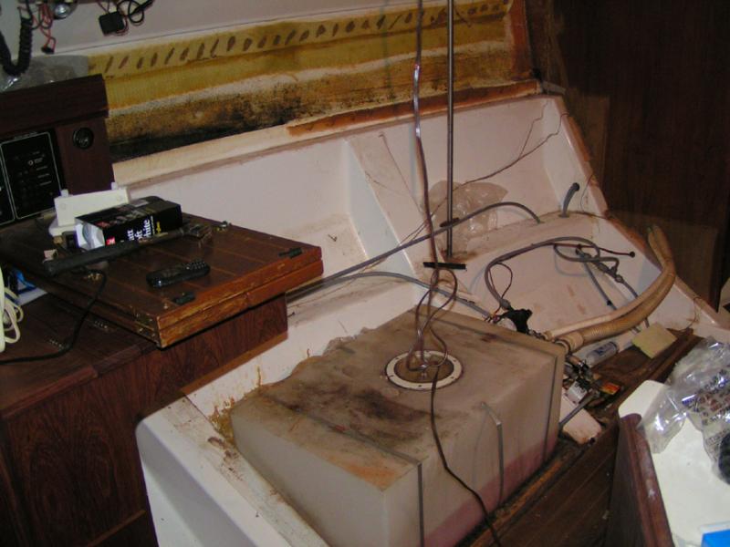

Lou, here is another I found in my pictures. This is a forum member's (Brian) tank showing the straight sides.. His access port and gauge is not standard.
Peggy, you are correct, the 35 gal tank isn't a whole lot but as Don says, there is another 30 gallon tank in the stern giving 65 total which is OK or folks who are careful about usage. You can see the selector valve on the fiberglass beam in my picture.

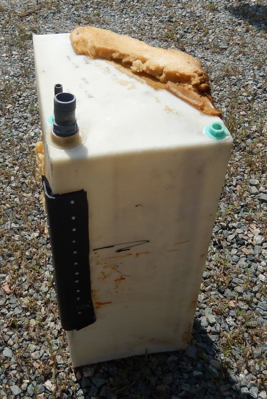

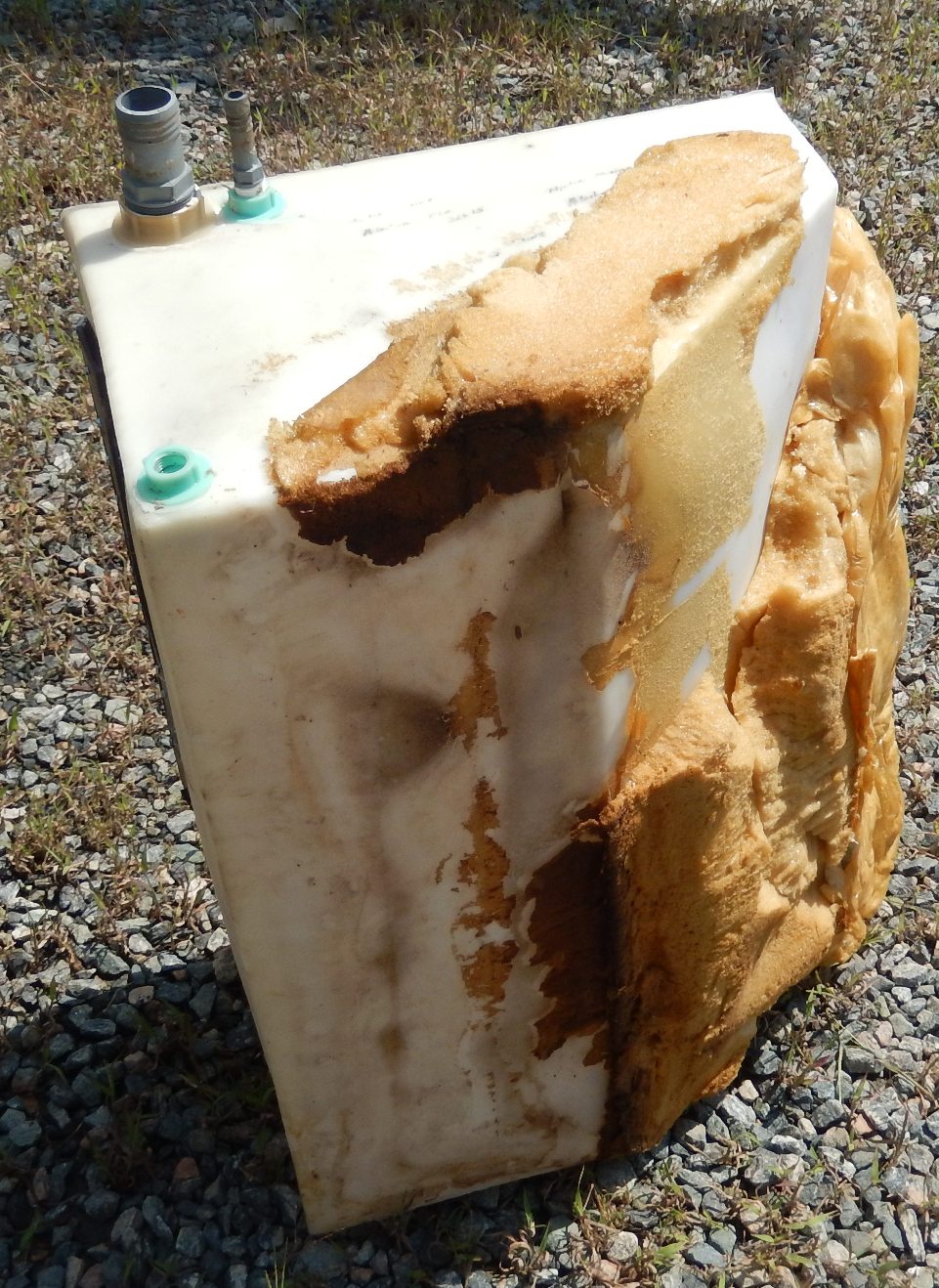

Lo, I have what I believe is my (1983) original tank in the back yard. Here are a few pics.p4.JPG p3.JPG
I'm currently re-fitting so have lots of pics. of everything I took out. Learning the old girl inside and out. Let me know if I can help.

Peggie, that may explain what happened to mine. A PO tried to fix a breach at the top on the tallest side with so screws, silicone (NSF approved ???) and an angled piece of black plastic.
