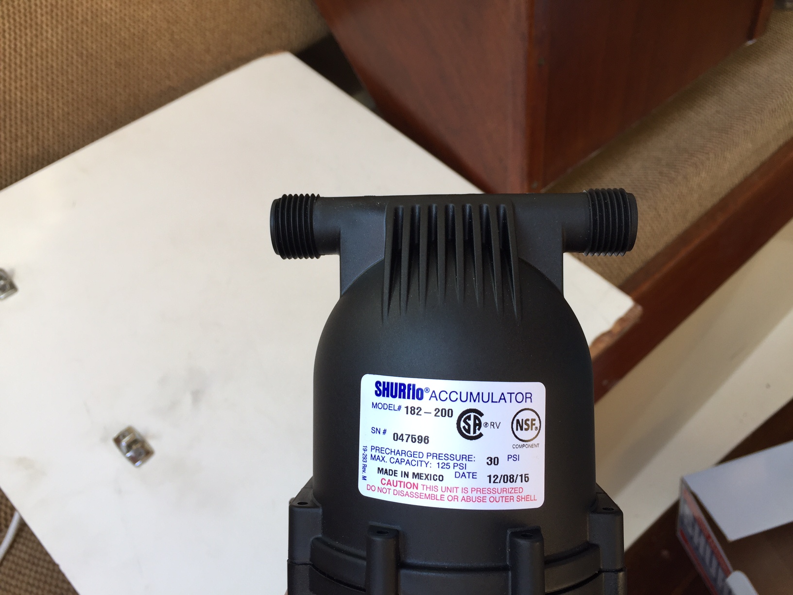

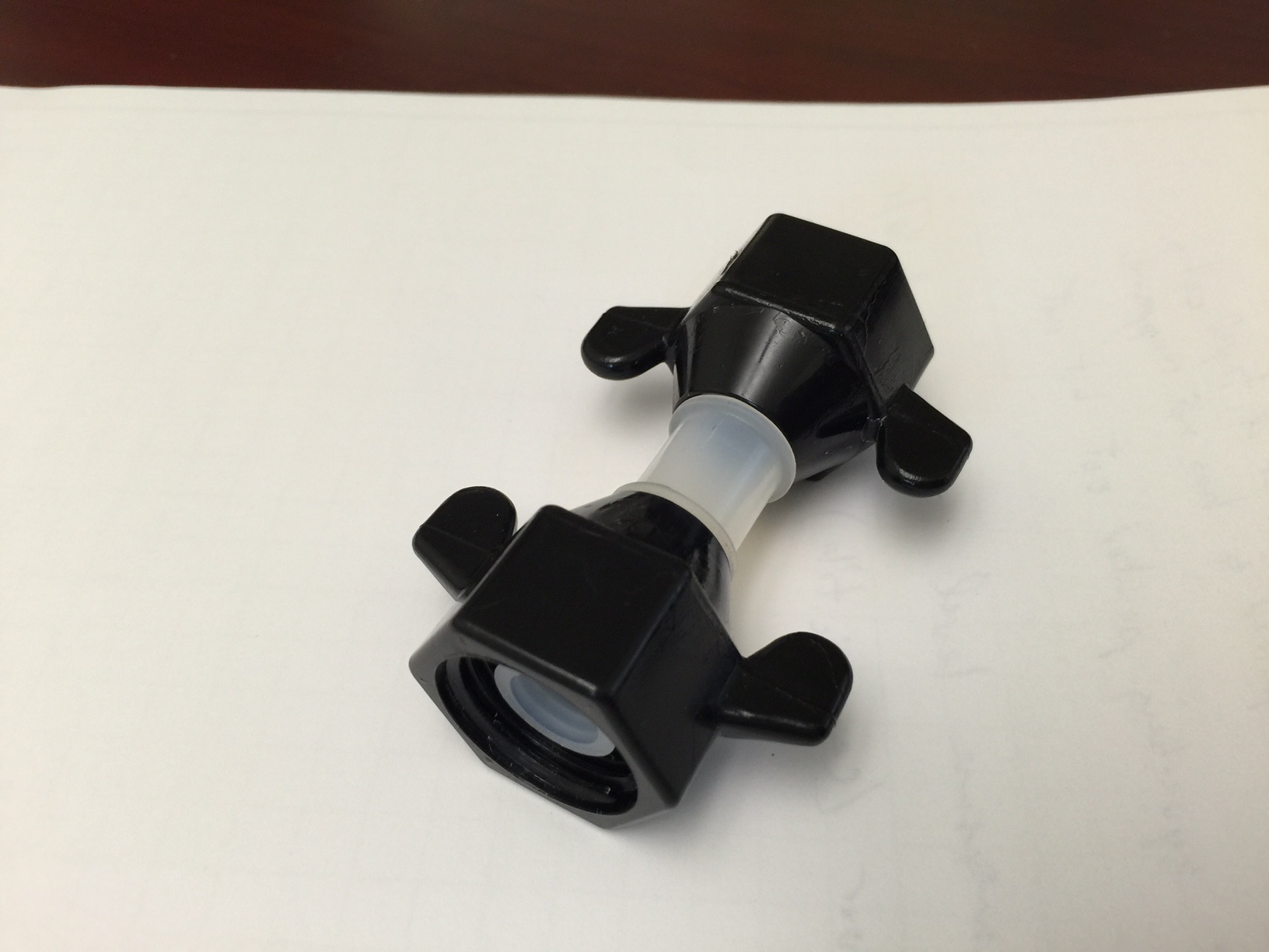

1. I got one of those small accumulator tanks to even out the flow. The built-in fittings are the 1/2" male threads. The package came with this little female adapter thingy, and I don't know if there is any real purpose for it. The instructions also indicate that the tank can be installed in-line after the pump, or it can be installed off-line on a tee after the pump. Since the purpose is to even out the pressure, is there any preference? I guess I'd have to buy a cap for the other end if I install off-line. What is that adapter for? I'm assuming that I need to purchase an adapter for the connection to PEX anyway.

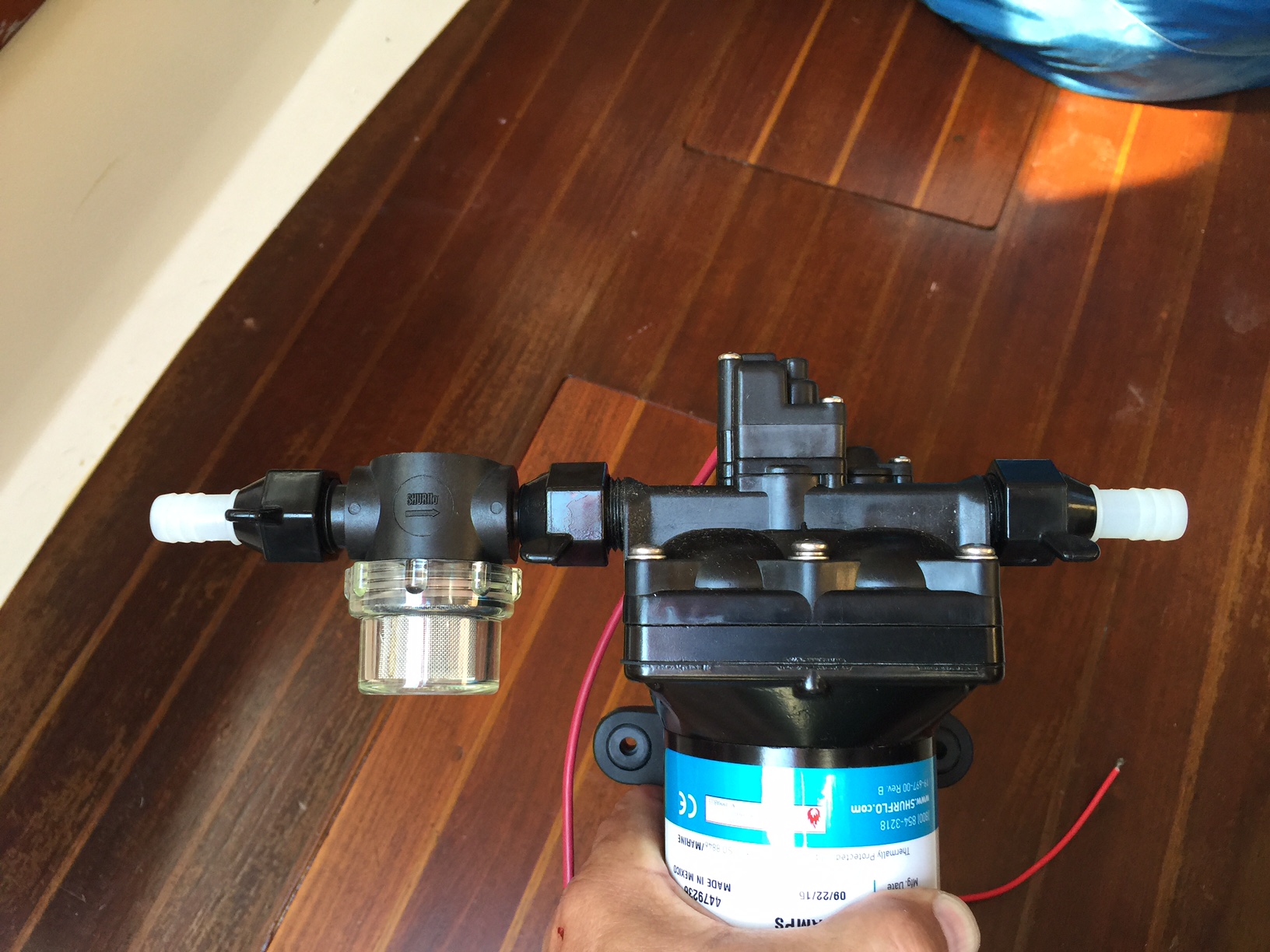

2. The Pump instructions indicate that it is preferable to connect a flexible water line within at least 18" of the pump. I am assuming that PEX is NOT considered flexible (or is it?). In that case, I figure that the conduit from the tank to the pump will be a flexible hose. I could start with PEX just past the accumulator, no?

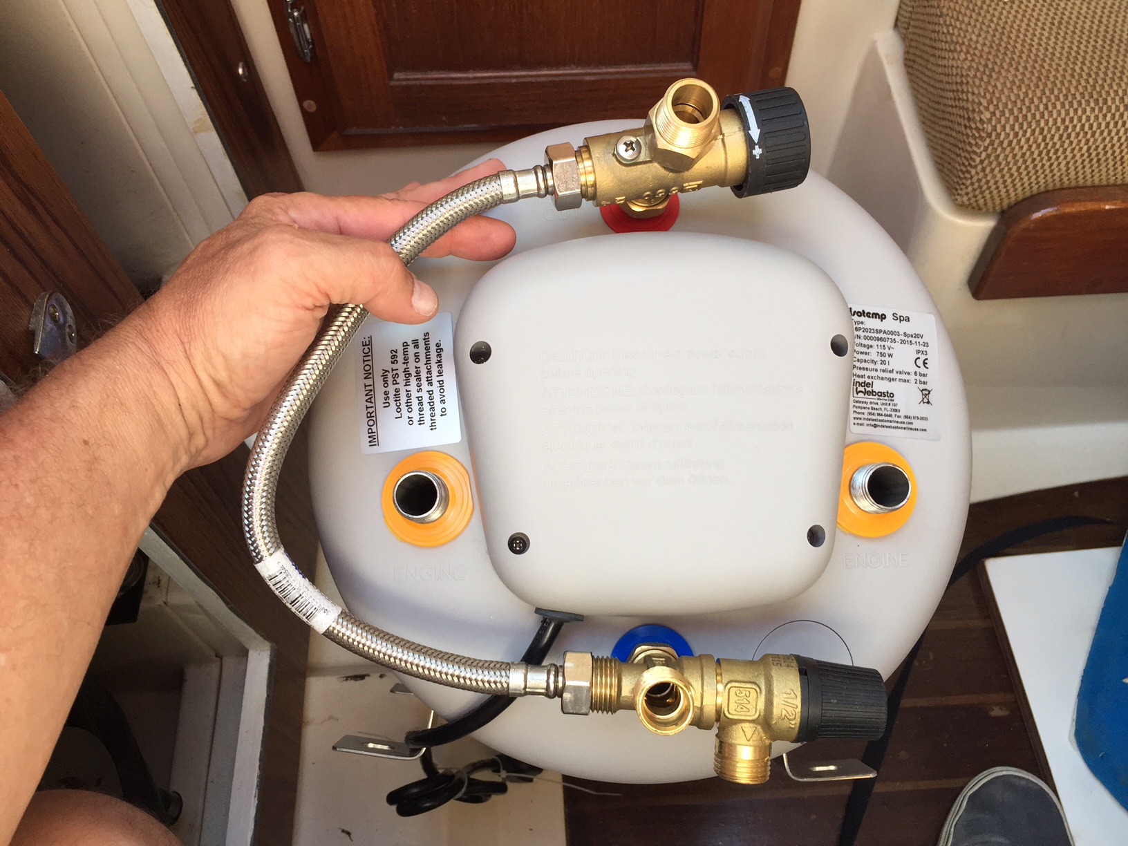

3.The water heater instructions seem to indicate that the in-flow and out-flow from the heat exchanger are thru "adaptors to avoid restrictions", rather than a 90 degree elbow. I want to run the lines down under the platformIMG_0325.JPG IMG_0335.JPG IMG_0331.JPG IMG_0332.JPG and make a few bends to turn them back up to the engine. Better to do with flexible hose rather than bend fittings (probably a stupid question :redface:) or is a fitting with a 90 not considered a restriction? (I do consider it a restriction). I plan to use Shields Series 250 for the heat and flexibility.
I'm mounting the tank horizontally on a platform just above the hull.

I agree with Terry that an accumulator is not required. I've learned to love the sound of the pump, since if it does go ON when not expected, I know right away. We turn the power to the pump OFF when we go to bed. If you have one and want to put it in, put it after the pump. That's the pressure the pump is seeing, not the inlet. See the WM Advisors.
An elbow is not a restriction, it is simply a longer "equivalent length" of pipe. My reference manuals are packed up for my move, but it's like adding four or five feet of pipe to the system, not an issue.

Face it, any fitting installed in a pie/hose drops down its effective size, even if for a little bit. If you want full service, use continuous hose without fittings, or full-flow fitting. Even full-flow is a bit restrcitive. This even applies to vent lines.

Good point, Stu, for the water pipe, it is just friction head. Still, I'm using the Shields Series 250 hose for the engine connection and it is bendable without kinking to 2-1/2" radius for the selected diameter, so I think I will just make those bends by sweeping the hose.
Based on commentary, I decided the variable speed pumps can be more trouble than they are worth, and West Marine and others said the accumulator does make a difference in evening-out the pump operation, since I'm using a fixed pressure pump. It's light and small and easy to install in-line after the pump (and not very expensive) so I figured I would go for it.

I'm more concerned about the heat exchange hose than I am for the water service lines, therefore I will minimize the fittings. It looks like I just need a hose clamp at the engine nipple and a 5/8" barbed fitting with 1/2" female adaptor at the water heater for both connections. There should be plenty of pressure in a small service. I'm installing hot & cold for the galley and cockpit shower fixture. The vanity will just have cold.
It would be better for winterizing to have it set up so the water flows through the fitting on the accumulator.
Shut flow has a kit for this, basically 18" flex line like you would use on a house installed before and after the pump.
BTW - I just installed an accumulator and replaced my fresh water pump. The accumulator didn't do much, probably not worth it. I have always found the the hot water heater on the hot water side had a greater accumulator effect then my added accumulator on the cold water side.
