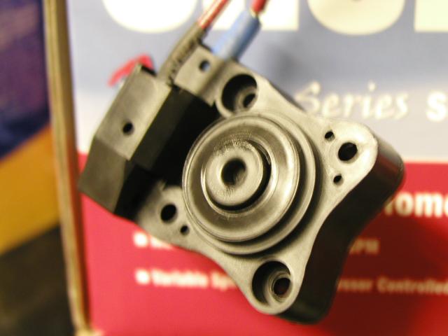

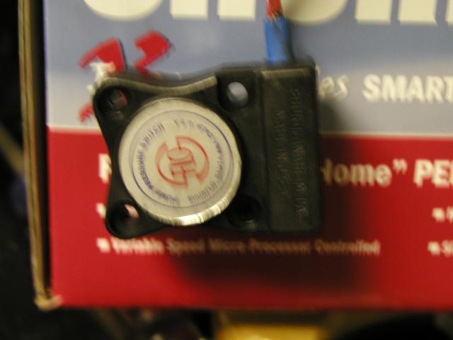

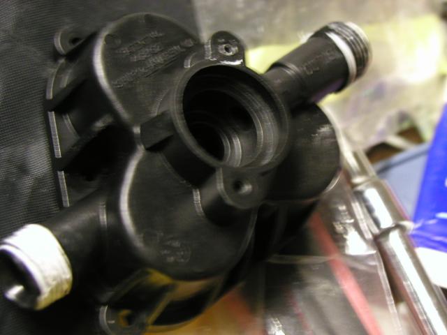

Jorge, it sounds a lot like you have a pressure switch on the pump that is not working.. There is a switch in the pump head that stops the motor when the pressure in the pipes reaches a certain level. The motor should shut off as soon as you turn off a faucet. If there is a leak, it will run a little then shut down a little .. and keep doing that.. The switch is on the end of the pump. There is a little piston that pushes on the switch to turn it off.. If the switch is bad or the piston port is plugged, it will do what you are describing. It sounds like you have a bad water pump breaker on the panel also.
The (bad out of focus) pictures are of teh inside of the switch plate, the outside of switch housing and the pump head where the switch goes..
For a new pump, a pump that is rated for 3.5 or 4 GPM (gallons per minute) will be fine..
