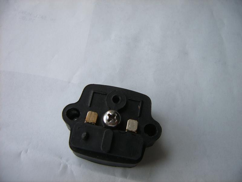

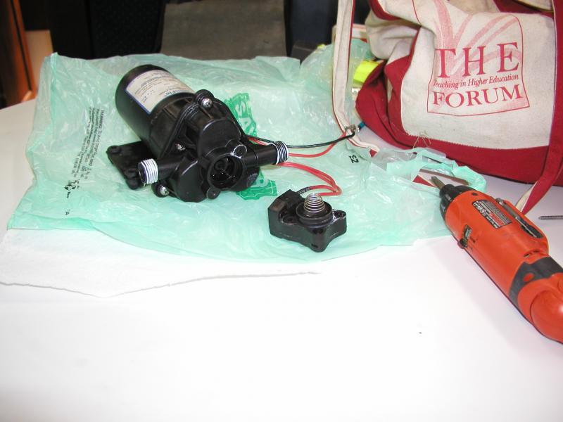

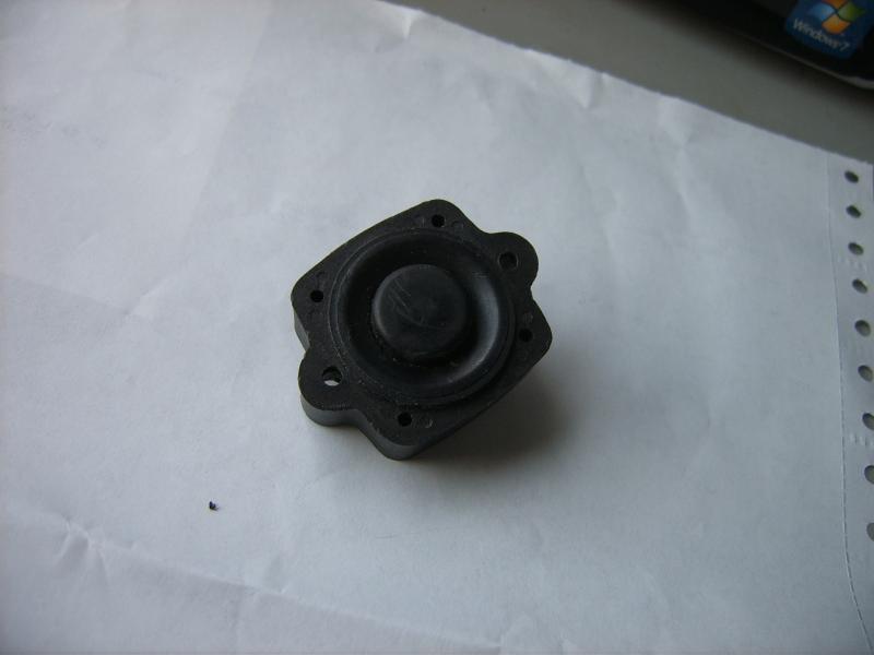

Here are a couple of pics of the switch. I cannot find a way to get the case apart to expose the switch. It looks like the collar around the depressable button is glued in.
10,257
WHOOPSIE! that looks like a proprietary switch that the FloPower folks are doing for their pumps.. ouch ! I figured that they'd knock off the ShurFlo correctly ! ?? can you ease the rubbeer diaphragm off to look at what is underneath?? Stuff like that usually have a kinda snap/press fit around the outer edge that can sometimes be gently lifted from the hard case. There would be no need to glue it because the mounting screws would hold it sealed against the pump case.. Have ya verified that the switch is indeed bad? Ohm-meter across the leads.. should read closed.. then push the button until ya hear it click.. should read open..
