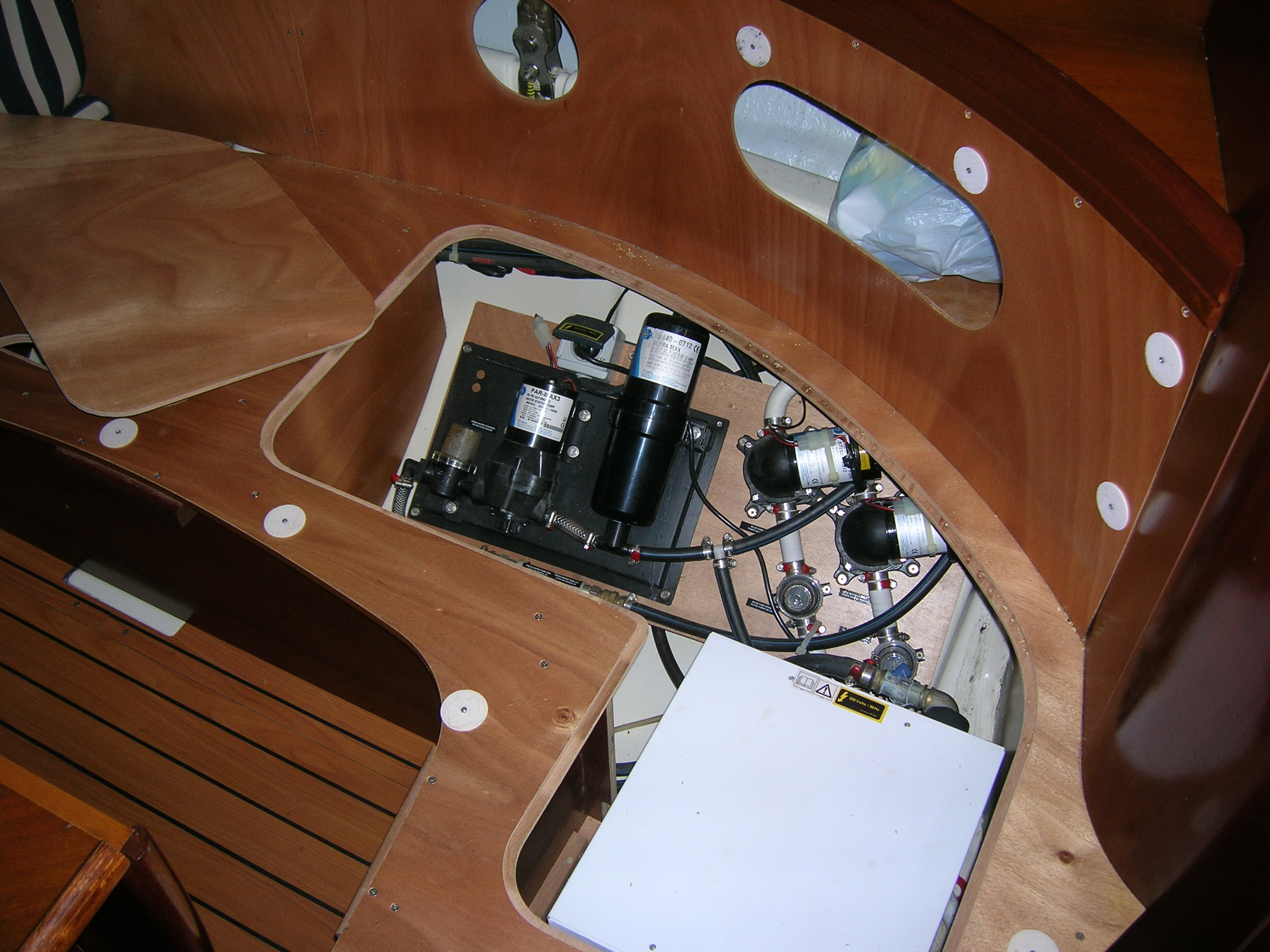

An accumulator will be installed on the pump outlet, and the one pictured above is about 1 - 1.5 liter in size.

Thanks for the picture Philip. I got the mounting, but no accumulator, so maybe it has been removed, when it stopped working. I will look for one. Thanks.
