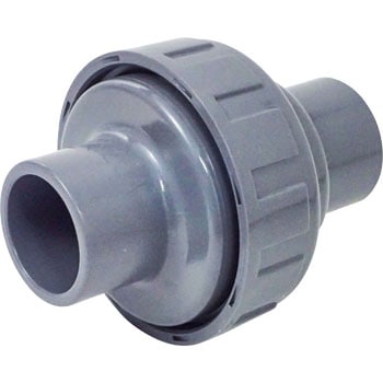

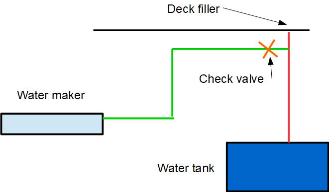

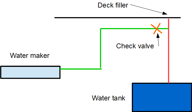

5. 2- Or do I connect the line with a T connection , closer to intake from the deck?
That sound doable. If you go that way you will need to cut the inlet hose up high, add a tee fitting and then a line to the water maker. I would add a check valve or one way valve on that line near the connection to prevent back flow from the filler line to the water maker fresh water outlet line.
