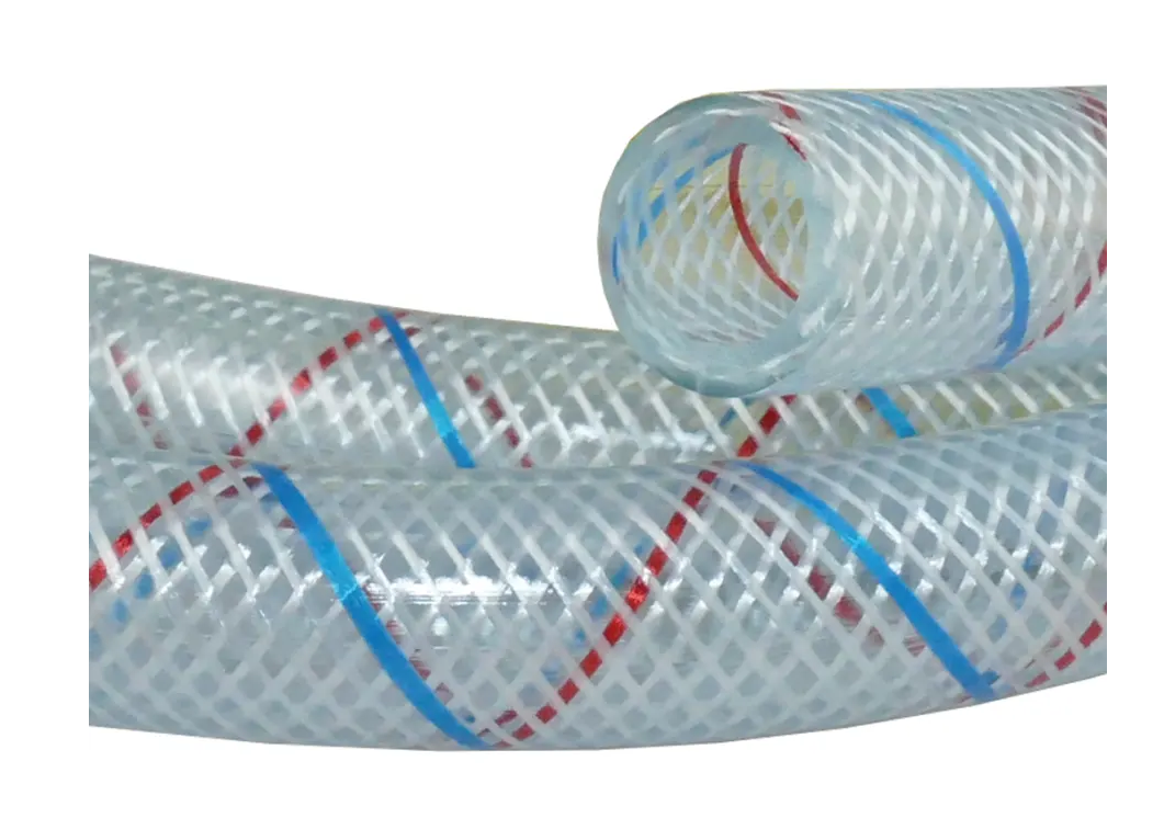

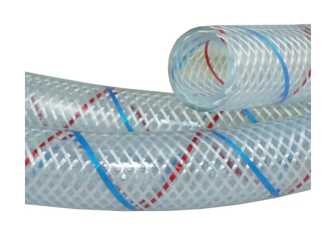

TRIDENT MARINE HOSE & PROPANE
SERIES 162. 5/8" Reinforced PVC Hose w/Tracer
It comes in various sizes.

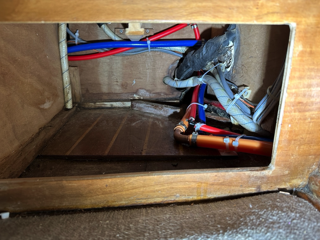

I just redid my plumbing using Pex A. Pex A is more flexible and can be used with crimp rings or with heat expansion tool. Check with the specific PEX manufacturer to be certain. My install is a year old and there are no leaks from the PEX fittings with crimps. Expansion fittings, the ones designed for use with the expansion tool can not be used with crimps and vice versa. Plumbers like the expansion tool because it is faster when installing fittings than using crimp rings, however, the crimp ring tool is about half the cost of the expansion tool.
While PEX is flexible, it does get stiffer when cold, installation is better as a warm weather project. Sharp bends will require fittings. In the photo the orange PEX is for the hydronic heating system and the remain PVC hose is for the refrigerator drain and water cooled refrigerator.
Fittings and hose are much less expensive online. I used SupplyHouse.com. Good prices and quick shipping.
