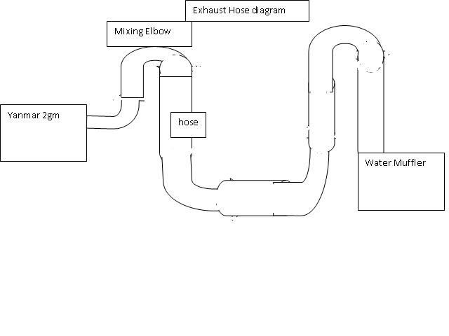

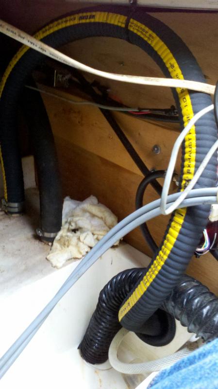

His big concern was the exhaust hose. The PO replaced the exhaust hose from the mixing elbow to the water lift muffler. As per a number of articles
the hose should drop to the muffler - which allows the water to always drain from the hose.
I am including a picture of the current hose configuration. I don't know if this is how hunter designed the system.
Can anyone provide pictures of there setup on the H31?
Is there a large loop in the locker compartment?
My mechanic suggest changing the large loop to a smaller one - so any input would be appreciated.
Thanks
Mark
