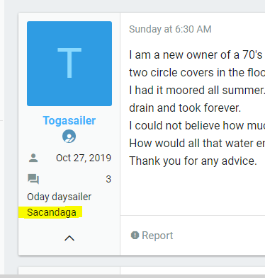

Unless there is another Sacandaga? The salt only comes out of the shaker :^)))
Well, that was why I asked, I was not familiar with the location of Sacandaga, did not know it is a freshwater lake in NY. But my point was that IF the boat was in saltwater it is easier to tell whether the water was rainwater or had leaked in through the hull. The rest of my advice stands as useful no matter what the water tastes like.
