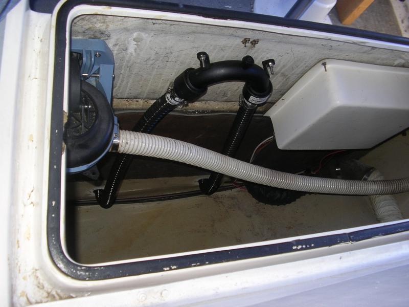

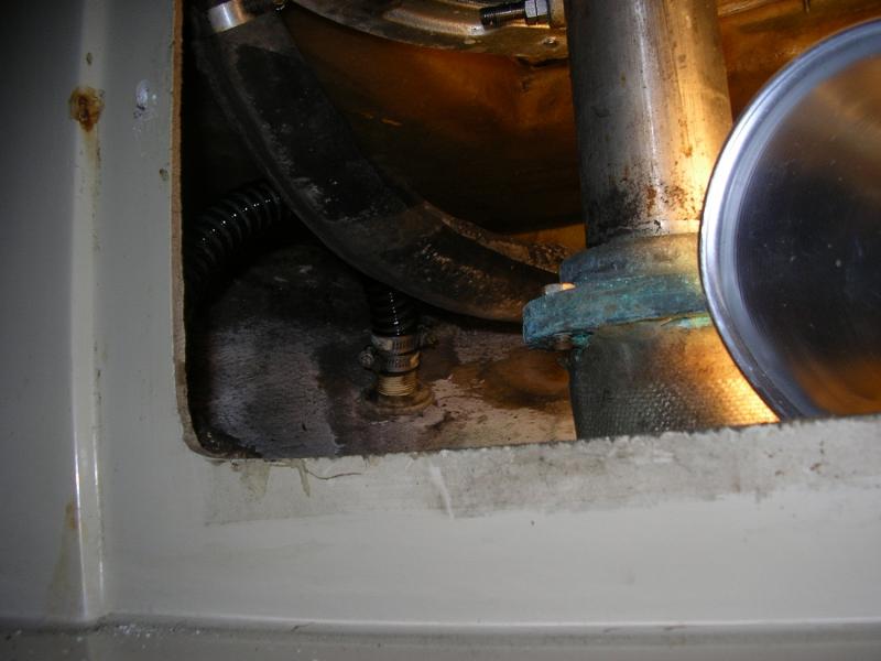

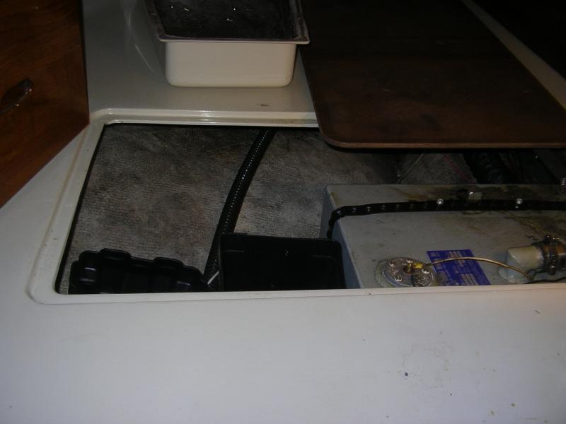

Oct 2, 2008
3,815
Pearson/ 530 Strafford, NH
Shouldn't the bilge pump drain through the transom? My Catalina 30 is set up that way.
I took these shots while I did mine.
1 Under the quarterberth showing hose lying on the hull.
2 Through the panel far back in the quarterberth shows rudder post and through hull with no room for any loop in the line from the bilge pump.
3 Vent loop I added in the portside locker to get the height needed for the loop.
Notice the hand pump with sufficient height.
