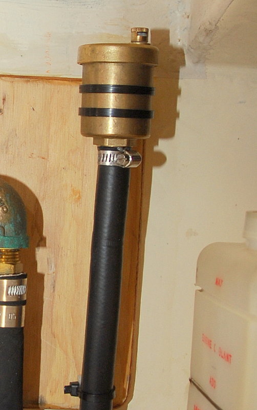

Tom, that appears to be the wrong kind of hose between the engine and the nipple (injection point). I'd use black reinforced.
As to the water issue, it appears you need a vented loop on the line from the engine to the nipple.

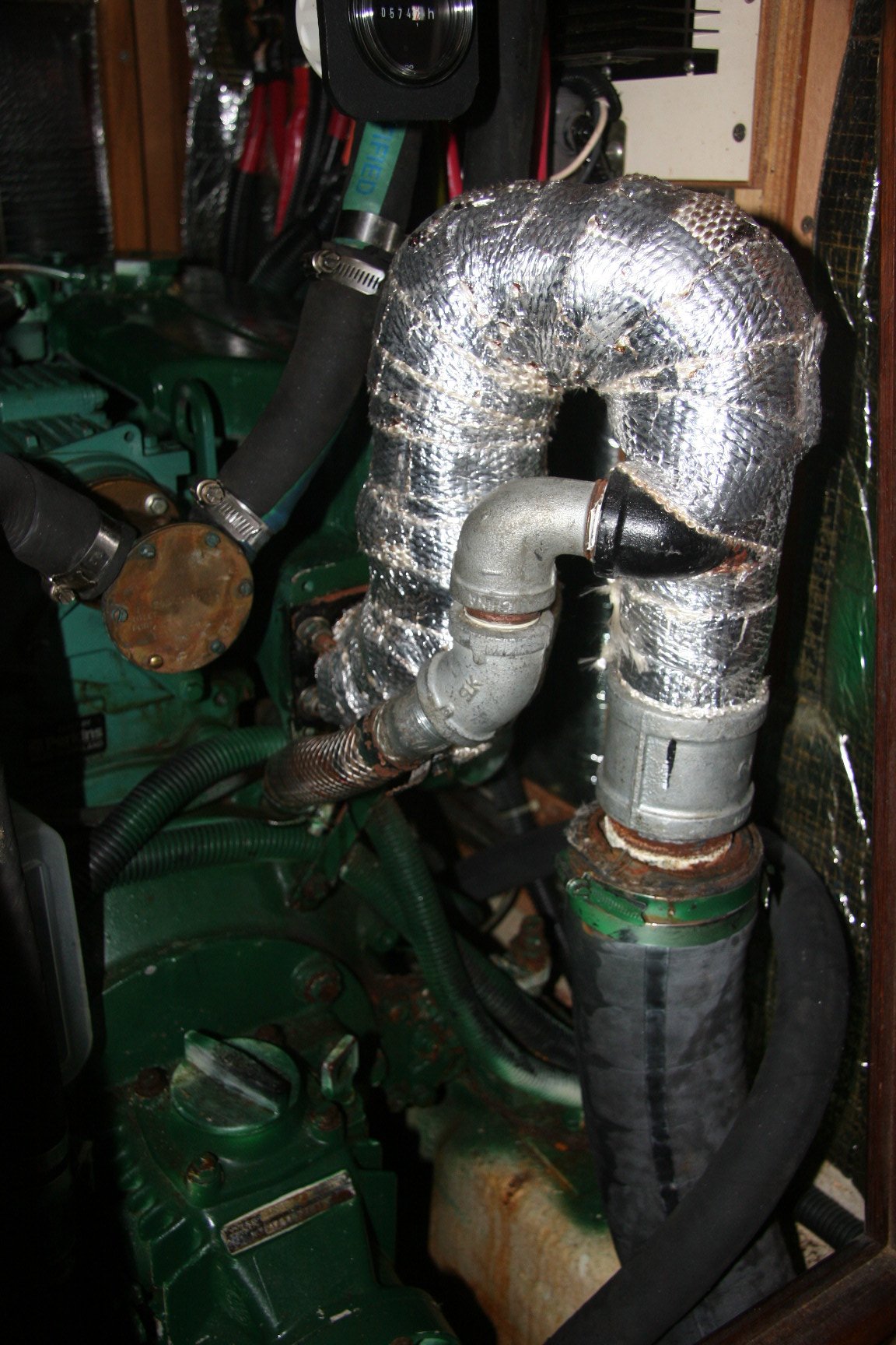

OK. Let's try this. Photo shows my Volvo with a new exhaust mixing arrangement.
I hope the injection point is a tube within the bigger pipe that directs the injected water DOWN the leg and not just into it with a tee.. Potable water / PVC hose should really not be used in an engine space and that is not engine rated hose. Is there a siphon break?...

Nice picture. I see you put the loop in front of the boats seal loop, looks like now about 1 foot of extra seal leg. The insulation is for the exhaust heat protection for human safety?
I am curious how you replace the square faced VP rizer and made a good seal?
I have the same boat and it has a anti shiphon but it also discharges the water/exhaust is above the 25° starboard side. I didn't leave the helm on that tac, to double check.:yikes:
The sea water pump has the high point siphon break, which is on the discharge well above his add on (actually so high it doesn't show in his pict directly behind the insulation shown).
I was wondering about that too, but the height about the injection point should not flood with such a low flow. The injection of water is the triple elbowed smaller line. Exhaust is insulated.
The injection point was about 9" lower. so the added back pressure may slowly wear his pump impeller a bit more. The flow will remain the same since it is a positive displacement type. I no leaks around his pump seal ( pump is round thing to the left with two hoses) or bearing, it should be good to go.
Jim...
PS: I would have used cast iron, like the VP riser. Your engine/exhaust is protected by your shaft zinc. Galvanized is not needed.

For future reference, if we are going by the safety standards, it needs to be Schedule 80, and galvanized is not allowed under the standards, in the dry portion of the exhaust system.
"1.6.2
Materials used in a marine engine exhaust system shall be resistant to saltwater corrosion and exhaust products, and
1.6.2.1
shall be galvanically compatible
1.6.3
Pipe Size - Threaded pipe and fittings for the engine exhaust(s) shall be at least schedule 80 pipe or the equivalent.
1.7.1.5
Hose used in wet exhaust systems shall comply with the performance requirements of SAE J2006, Marine Exhaust Hose, or UL1129, Standard for Wet Exhaust Components for Marine Engines. All other exhaust system components shall meet the performance requirements of UL 1129, Standard for Wet Exhaust Components for Marine Engines."
Clear PVC hose does not comply as a "component" used in a wet exhaust system....

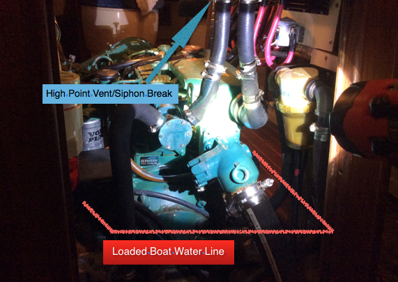

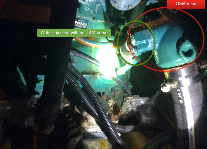

I want to clarify and share the OEM arrangement for the Riser in this post. Both points on hose, purge tee and siphon break should be clarified for the OP. The first pict is my OEM picture which shows my Boat Water line and would put the exhaust riser barely below AWL.
This pict shows how OEM used a purged TEE to make the flow momentum point downstream. When I visually inspected the interior, I was not impressed since is was like a 45° elbow cast in riser, but no flow erosion after 1200 engine hours. Hmmmm? Note the injection hose, Tom, as the other told you double check yours for service. Failure of your sea water purge hose would be a disaster in the making.
We kinda beat up on you by my request for a picture, but the forum experts are worried for you.:)

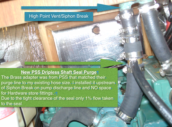

Now for a picture of my PSS seal purge fix that I discussed earlier in this post.
Look above picture as a BEFORE fix on the pump discharge. This is the after fix.
Jim...

The seal loop on my Hunter exhaust looks like this.
No siphon break needed and the high point loop prevents boat heal from reverse flow.
What the OP and I have plaguing us is that the Muffler has standing water in it and in high seas and engine not running, the standing sea water can "slosh" into the open engine valve. He added another high point to stop the "slosh" as shown in his picture.
Here is a brainstorm that I would love comments on!
The problem is standing water between the engine and the LOOP in the Elevation view.
What if I installed a small drain on the muffler to remove the standing water and thus NO SLOSH?

In your third picture, you show a revised take off of injection water upstream of your anti-siphon valve. Why did you do this? I apologize that I did not see your earlier post on this subject.
Lastly, your diagram of the Hunter exhaust plan raise the question of what would happen if you drain the standing water from the muffler. When would you drain the muffler? In my boat, I did not have a problem as long as the engine was running, no matter what the seas. My problem occurred when I shut the engine down, at that time, a slug of water would enter, either from back pressure in the engine, or from sea surge. In either case, I cannot see when you could drain the muffler.
This would also probably drain the entire hose and loop. This would amount to quite a few gallons of water that you would have to wait, after starting, to observe if you have water flow.

I don't know why the mechanic used galvanized. Upon reading UL 1129, I am not sure what would be wrong with using it. Also, I don't know if the pipe is Schedule 80 or Schedule 40 but I believe that it is 80.

Mixed metal that are not in electrical continuity with your sea water Zinc will eventually corrode. Pipe schedule 80 is just thicker wall than 40, both are used for high temperature/pressure service. Sch 80 gives you more longevity than 40. As long as your Zinc is on your shaft, no corrosion in OUR case. I would not change to cast iron. The galvanization should be ok.
I would drain to the bilge, my guess about 2 gallons of water, when I was not going to use my engine for several hours or more. Sloshing should not be a problem, but that is why iI asked the forum contributors.
