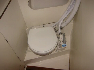

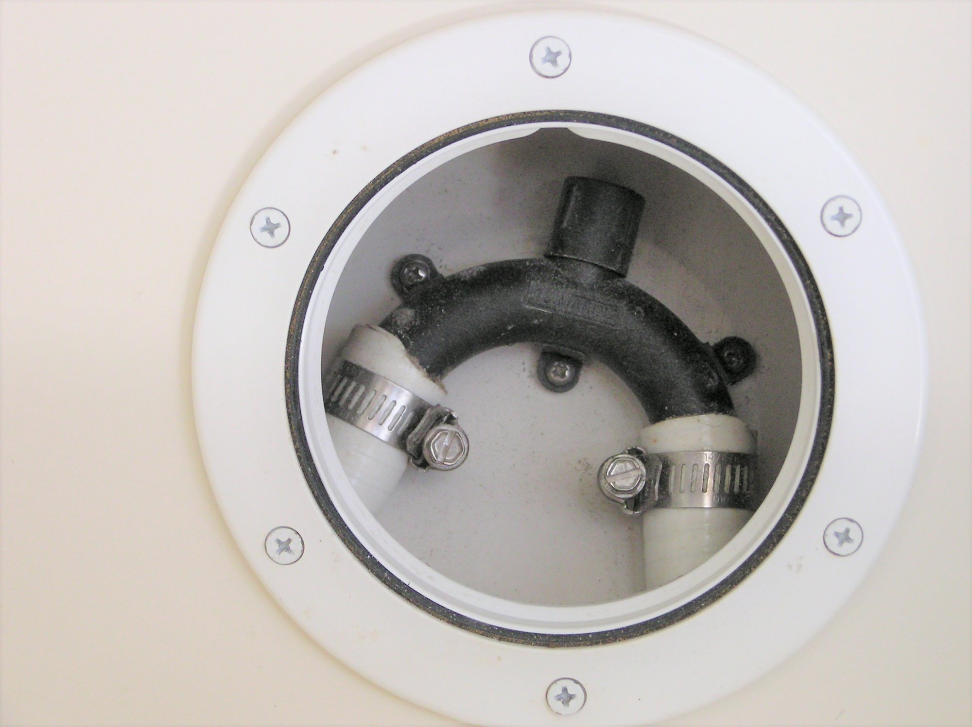

Head intake is another likely source of the water if there's no vented loop in the line and the toilet is left in the "wet" mode. See photo and the installation instructions for your toilet for the correct location. It should NOT be installed between the pump and the bowl...it belongs between the pump and the bowl, to replace the short piece of hose the toilet mfr uses and needs to be 6-8" above waterline at max heel, not just when the boat is at rest...which on most sailboats puts it 2-3' above the bowl (see photo).

Peggie,
Go back to your original post on this thread. That is the source of confusion. "It should NOT be installed between the pump and the bowl...it belongs between the pump and the bowl.."
For the record, the vented loop on the C310 is in the correct location, between the pump and the bowl. It goes up beneath the cabinet. This makes changing the duckbill a chore.
Oooops...I should have read it before I posted it. That should have read : "...should not be installed between the THRU-HULL and pump...." No wonder you were confused!
Reason it shouldn't be between the thru-hull and pump: it would interfere with the pump's ability to prime because pumping would pull in air. I've seen dozens of posts over the years in which the poster said it was necessary to put his thumb on the hole in the top of the loop to get the pump the bring in any water.
