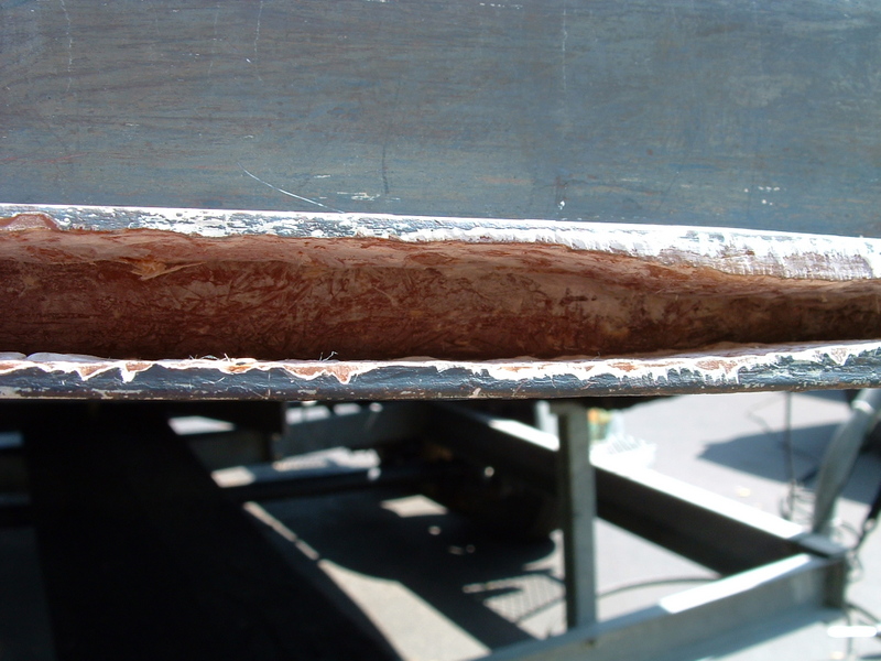

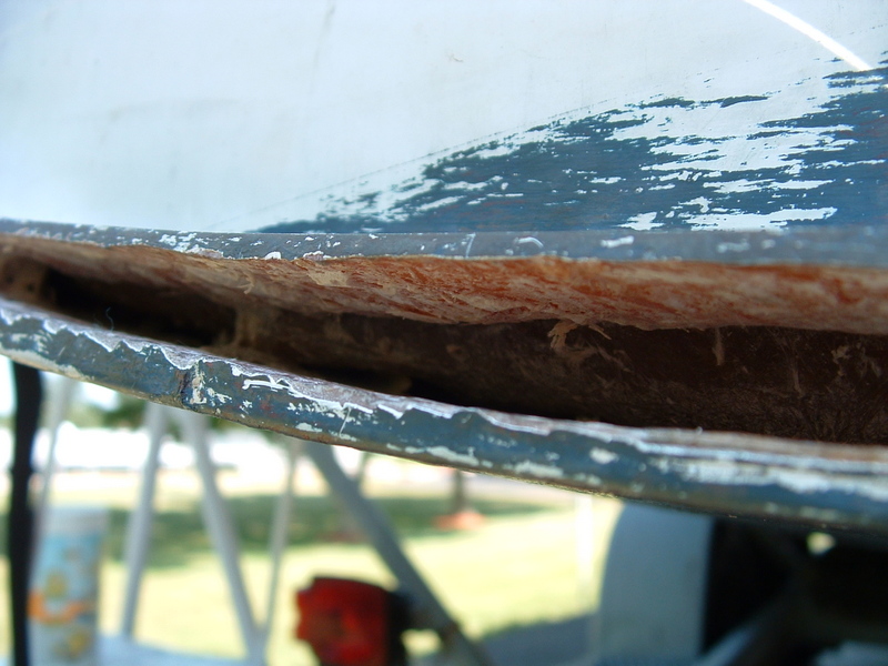

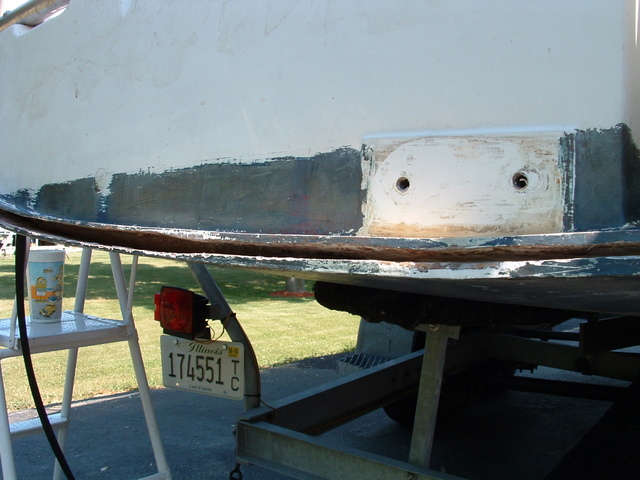

My water came in from the hull and deck joint, but only when heeling stressed the joint.
I had a small hole in the area behind the stern berth where the water could be seen dripping in. Once home I had my son hold the air nozzle from the air-compressor to the hole and gently apply air. On the outside you could see water coming out of an invisible crack about 2 feet long.
The adhesive material didn't stick and I had to remove and replace about 4 feet of material. Once I started removing it (by hand not a power tool) it was easy to tell if the adhesive was still sticking and removed all that wasn't.
No problems since!

Thank you John for the photos as this may well be the problem but other sources could be the culprit like the gudgeon where it is attached on the lower transom again below the water line when folks are on the back. Only if you knew my involvement with these boats.
My approach is to ask questions and for photographs before pulling everything off. I also use to be an investigator as well besides a pilot.
