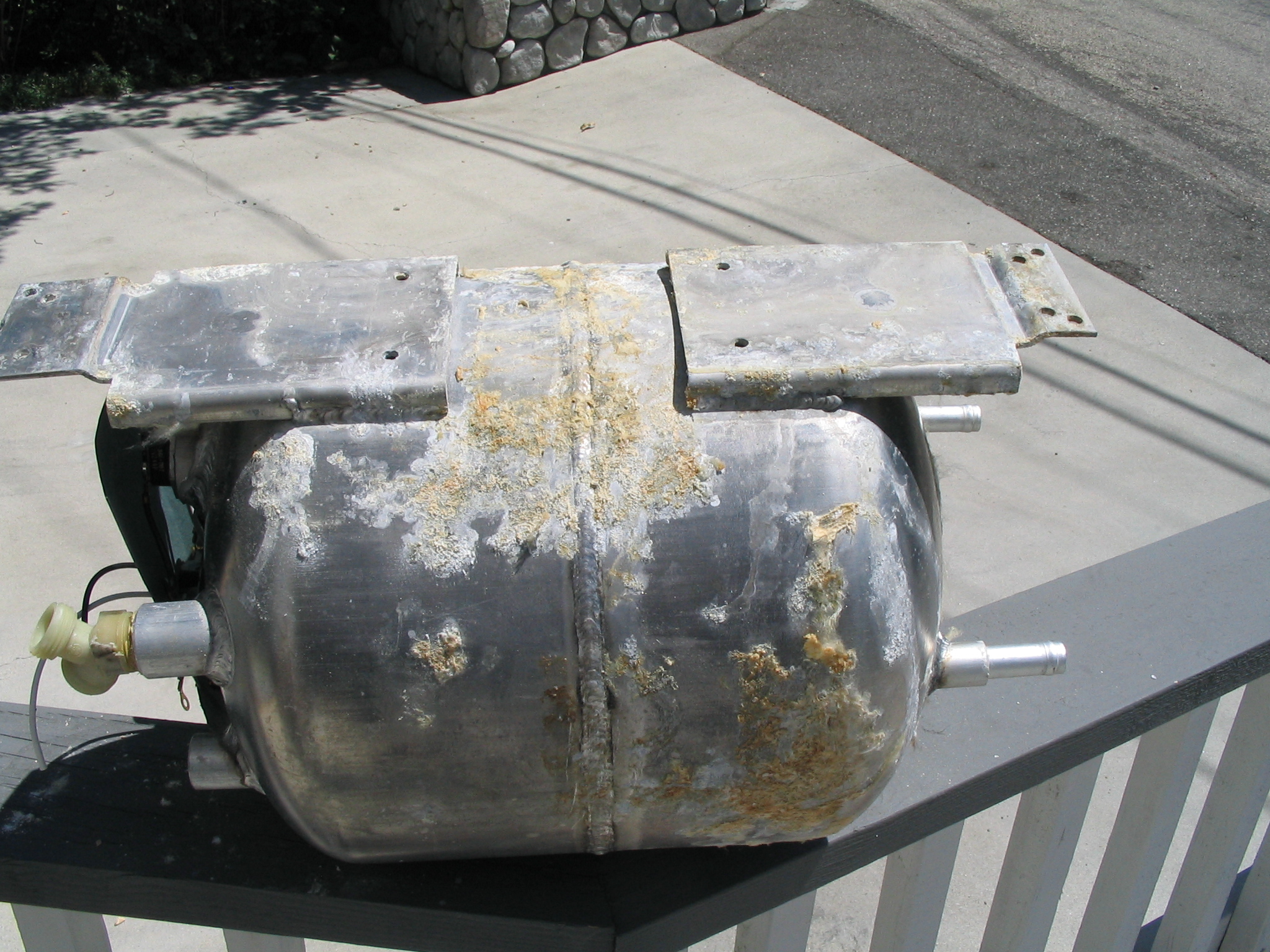

I seem to replace them about every 7-11 years. In my experience, they leak around the heat exchanger to broiler fittings. Two boats, 28 years, three water heaters. Here is a photo of one of them with the exterior stripped off. The one I have now has been in there for quite a while. Hope I haven't jinxed it! :confused:
