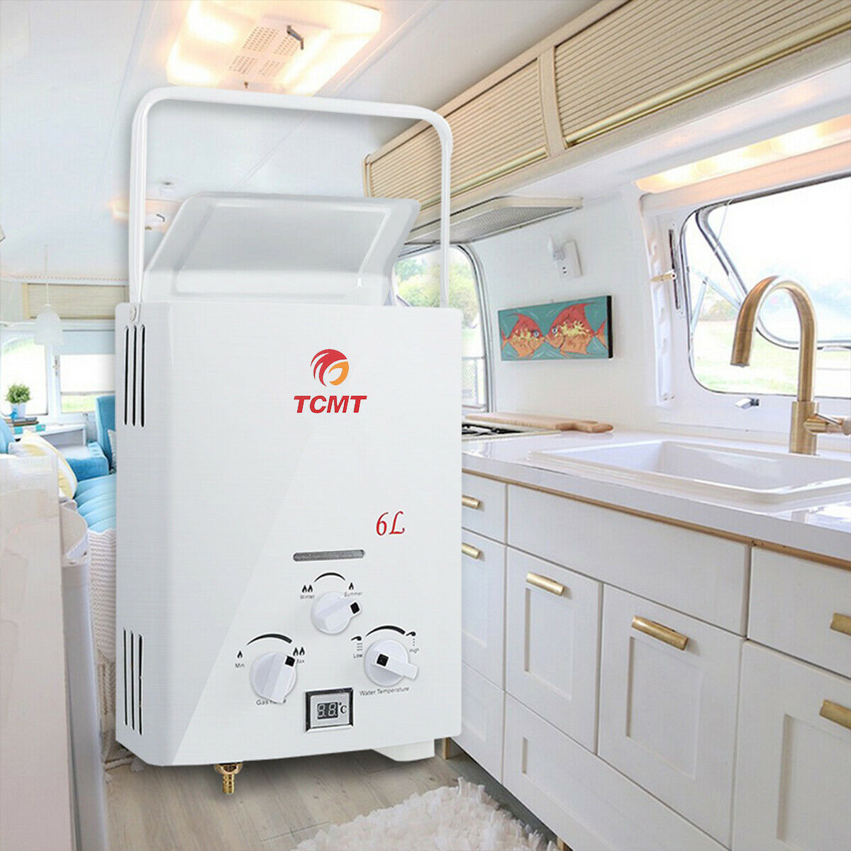

Although not standard, it may be easier to install, my 34 has an on demand propane heater...
What's the make and model of the water heater? Is it currently available?
Sep 11, 2016
37
O'Day 30 & 34 (Both O'Day) 0 Halifax, Nova Scotia
Does any one use these (Only related to this thread), I grabbed one for our last boat and purchased a new boat this year. I'm comfortable with this external system, but may not install it before selling to a new owner.
