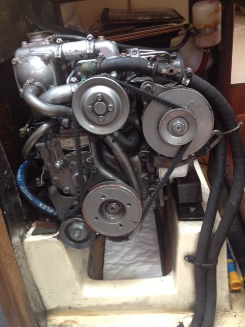

I'm new to engine maintenance and am trying to determine whether our engine has a water heater hose. It used to have a hot water heater, but it was removed. I'm assuming we won't have a hotwater heater hose because of this, but want some confirmation since I'm draining out our coolant and flushing with clean water before replacing the new coolant and I've read that you need to flush out the water heater hose during this process. I've attached pictures of our engine below. Thanks for any help!

The two hoses that appear to go into the floor in the first picture are probably going to the water heater.

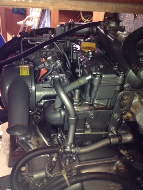

On my 3 GM, in the middle picture, the aft-most hose sends water to the heater coil and the one just behind the pulley is the return hose from the water tank coil .. or where the coil used to be..The return hose has a bleeder in it to be used for burping after refilling. Someone probably just put a jumper (connected those hoses together) back where the heater was so that when a new heater went in, it would be easy. Those hoses on the back side look to be fuel return from the injectors back to the tank and a tee to the fuel pump.. That is a little strange.

Think that might be some kind of "poor man's" fuel polisher? That looks like the in line to the secondary filter. Wow.
10,152
Rick.. I dunno..?? Looks like a variation of the rig that was used on the older QM series Yanmars where the return went to the top of the secondary filter .. This one looks like it tees into the lift pump suction line.. and it looks from the paint and clamps to be original.. Should make trying to bleed that thing kinda.... uuhhh.. interesting! Must be a very early GM series.. most 33's of that era had a 2 QM20.

The OP has either a bus heater or a water heater plumbed into that engine. Where the hoses go I can't say....
