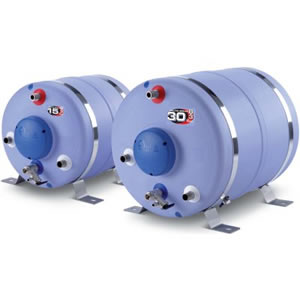

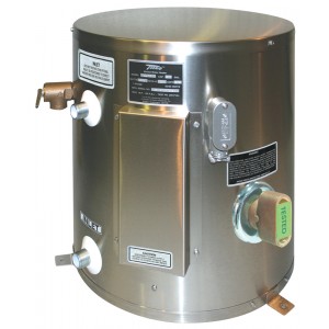

Firstly running the engine to produce hot water only happens when you have a hot water heater that is connected to your engine. Some boats have them some do not. Those that do not and are used to cruise with often have the new owner change out the water heater.
If you have a water heater it should be located somewhere in or near the engine compartment.
It may look like one of these:

How new to you is the boat? Every o'day I've ever seen has a round vertical heater like the one in the center picture that John posted above. It should be in the engine compartment next to the galley bulkhead and accessible by your cockpit locker. Of course a PO could change that. If you would like a schematice from the oday 34 manual , PM me with a fax number. Sounds like the cold water supply hose may have been disconnected during winterizing. Do not turn on the ac current without water in the tank least you burn out the element.
