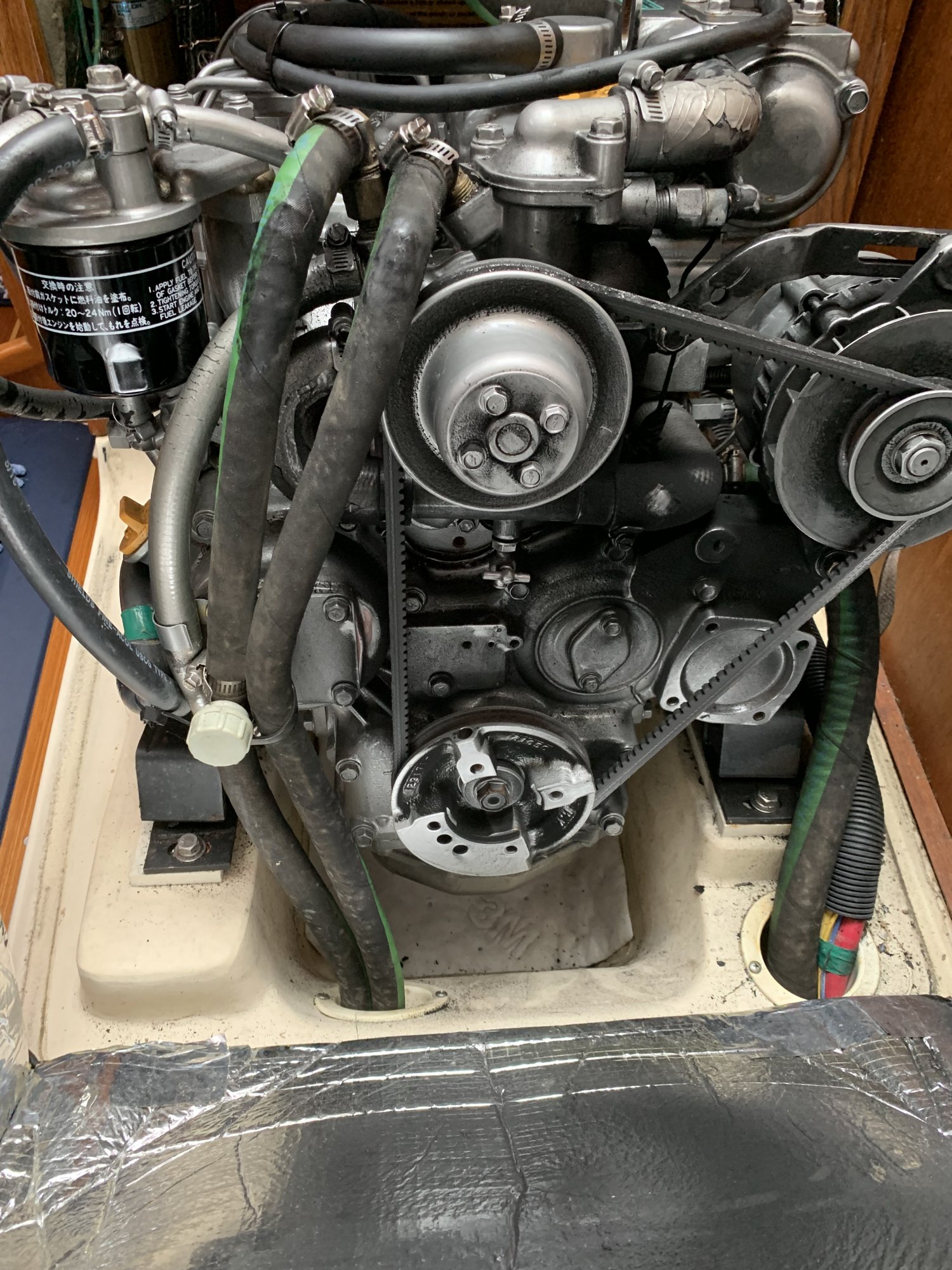

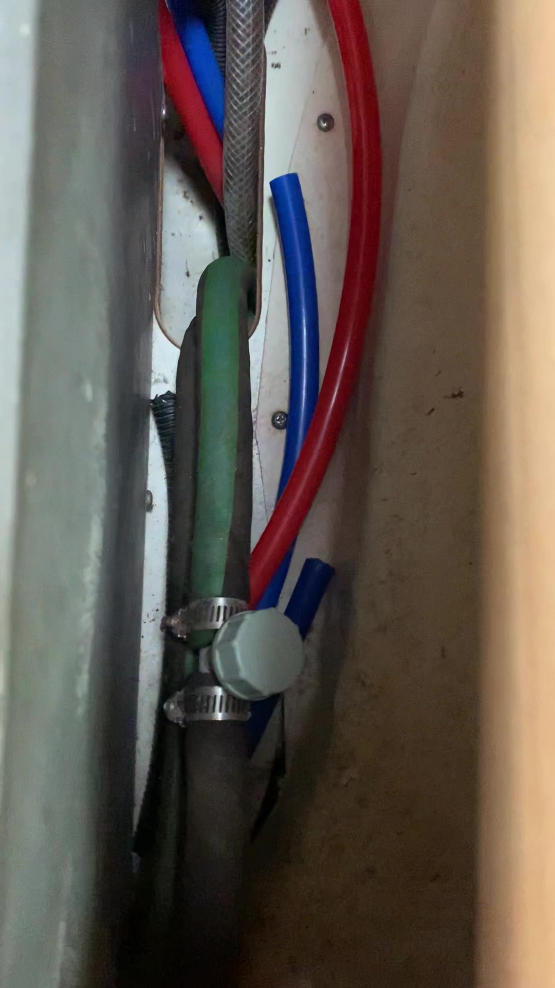

What's the best way to winterize our air conditioning system? Any pointers for running antifreeze through? If I put a few gallons of rv antifreeze in our fresh water tank and run all the faucets, will that be good enough? The reason I ask, see pictures. These 2 hoses run from the hot water tank to the engine. Note the cap fittings. Will my flush be good enough, or do I have to drain through these fittings? Thanks a bunch,

The hoses from the water heater to the engine carry engine coolant to the heater, so no need to worry about that part of the circuit - it’s already antifreeze.
