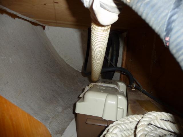

Welcome aboard, Larry.. !! Lots of good folks here and many Hunter 34 folks to get comments from. There is a loop that goes up several inches above the engine. You can see it way aft behind the battery box in the starboard cockpit locker. The engine exhaust gas pumps the water over the loop when the engine is running. BUT remember that if you crank the engine a bunch without it firing, the water will back up into the engine just as you've seen. You can clear it by using the decompression levers after the water inlet valve has been closed or the hose removed from the injection elbow and the elbow removed and the air cleaner removed.. Hand turn the engine until the water is all clear.. re-install the exhaust ell at the rear of the manifold (4 bolts).. drain the exhaust hose before re-installing on the elbow. Turn the engine over very slowly by hand through the compression strokes of all cylinders.. Then remove the mixing elbow water injection line and put it in a bucket.. Crank the engine very briefly to clear the exhaust hose then re-install the injection hose.. She should be fine. Why yes, I did water lock mine while trying to bleed the diesel pumps.

I'll bet that's one mistake you'll never make again. So, yeah, there will be an elevated loop in the exhaust hose back there, the purpose of which is to keep water from being pushed into your exhaust by a following sea and flooding your engine. It will be high enough to be above the water level at the maximum normal angle of heel. Higher than your engine for sure. So when you were pushing fresh water into your heat exhanger, it was running through the exhaust elbow and back into the engine, since that was lower than the exhaust loop. As Kloudi1 mentioned above, that's also why you need to close your seawater thru-hull if you 're going to be doing a bunch of cranking, like when purging the hi pressure fuel lines. If you don't, you'll end up flooding the exhaust and backfilling your cylinders with seawater. Anyway, pick up a copy of Nigel Calder's book on marine diesel engines. It's less than $19 on Amazon and will really help you understand what's going on back there. By the way, the 3GM30F is a great engine. Some say if you take care of them properly you can get over 10,000 hours out of them. Cheers.

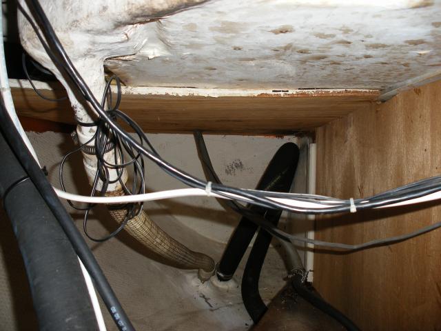

PS: Found a pic of the exhaust hose exiting the hull in my H34.
