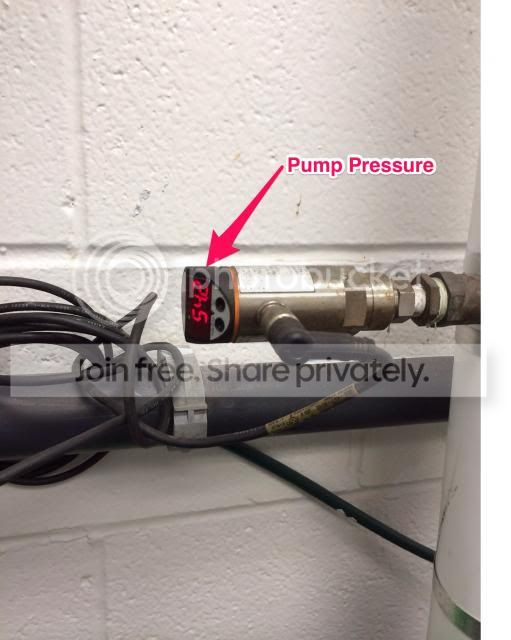

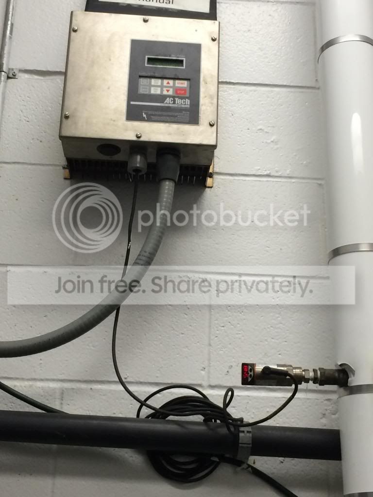

The maxi puppy is 10GPM minimum with a 21 AMP draw and not really ment to deadhead against a second device with a fixed 3.5 GPM throughput
It is going to get hot and always be at 100% load in this service so i would at the least consult with the factory on the this type of service and duty cycle
I wonder how some of the new variable speeds DC pumps would handle saltwater
BUT getting industrial we have 35 PSI of local water pressure which flows X
In this case the machine needs 55 PSI at all times with zero to 150 liters per minute water flow
The sensor controls the pump drive so that the machines water flow needs are meant and there is no damage from pressure spikes

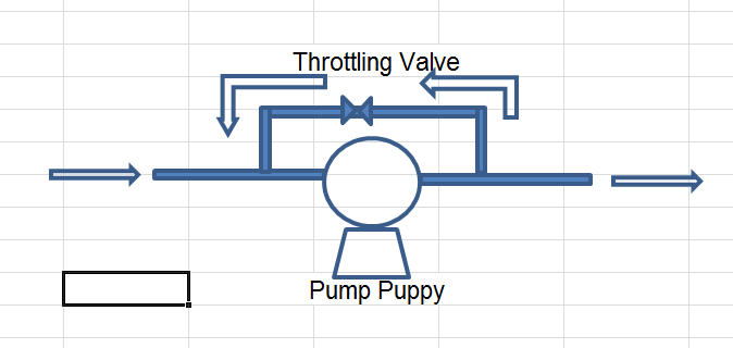

Once upon a time we had to insure a pump that fed a process would not dead head, or run at restricted capacity, causing it to burn out. We created a bypass loop connecting the output back to the input side with a throttling valve. The pump could run at maximum capacity all the time it was needed and the subsequent process would draw what it needed when it needed it. I don't know if this would help, but its a fairly easy experiment with a couple of Tees and a valve.
If your Puppy is pushing directly against a process that has less demand that it can deliver, then in essence it might be deadheading and it is then cavitating inside resulting in poor output. Bigger might not be better as it will cavitate even more.

We created a bypass loop connecting the output back to the input side with a throttling valve. The pump could run at maximum capacity all the time it was needed and the subsequent process would draw what it needed when it needed it. more.

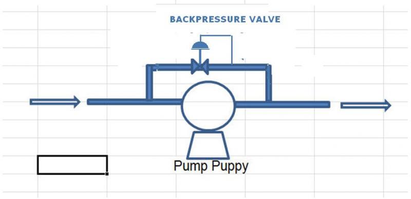

Looks good as far as it goes Alan. Had a simialr situation some time ago and rather than a manual throttling valve, we used a back pressure valve to ensure the supply pump delivered a constant supply pressure regardless of the flow through the system. We couldn't afford (read as too cheap) to have a variable frequency drive for the supply pump.
I'm sure a very small backflow valve is available somewhere (too lazy to find one right now). For those not familiar with this rubbish, basically it's a pressure reducing valve that's installed backwards and is normally closed (it opens as the sensed pressure increases) to control the UPSTREAM pressure.

I still think its worth trying the recirculation loop based on the information Claude is presenting as it will mitigate the high pressure buildup and subsequent impeller distortion by keeping pressure low and flow rate high. Once the impeller distorts, the pump is in bypass mode internally and little if anything will come out the output. In fact you could use some flexible hose t-eed to the inlet of the HP pump (output of the Junior Puppy) and a c-clamp to squeeze it down as a throttle. The ideal situation is as Ralph describes controlling the pressure, but this should work to some degree. Run the hose overboard or into a bucket initially and just see if the demand requirement of the HP pump is being met.
