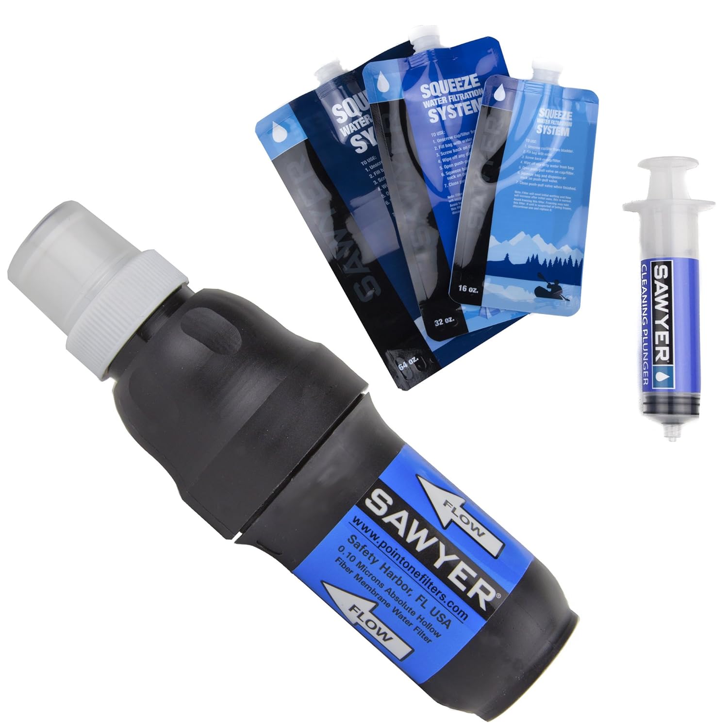

I am interested in putting a filtration system on Dragonfly. As a hiker, I have been using the Squeeze system by Sawyer
https://www.amazon.com/gp/aw/d/B005...M+hyL&ref=plSrch#immersive-view_1512216345019
It uses a micro-fiber filter. I don't think there is any carbon involved.
