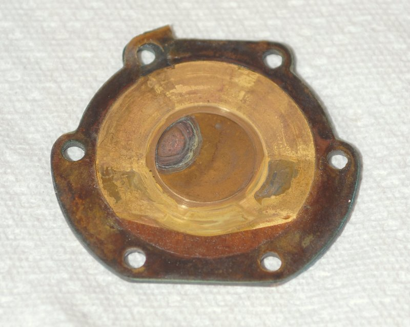

Have you checked the plate that covers the impeller. If it has any grooves in it you can lose the prime. My Ericson had that problem. You can sand the cover down. It must be smooth. not like this one:
Sep 28, 2022

How about some photos of the pump during the rebuild process? An impeller pump is a simple device that sometimes requires a rocket scientist and a master technician to repair it.

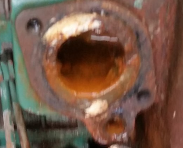

Undaunted, I removed the thermostat housing, connected a clear poly tube to the water supply line with the other end in a bucket. I ran the engine at idle for one minute and it produced one gallon of water.
Thanks @SycloneDriver , for that info. It appears that there is some attempt to measure the pump output right at the pump outlet, although I would like to see the tubing in place.
Unless my eyes deceive me, the inside of that pump appear to be excessively corroded.
That pump interior also looks to be cast iron.
@priopel , please supply a clear picture of the pump interior. And we will need a picture of the pump interior from your engine manual. If you don't have a manual, search this site for one.
I could be wrong but I think that is the inside of the thermostat housing.

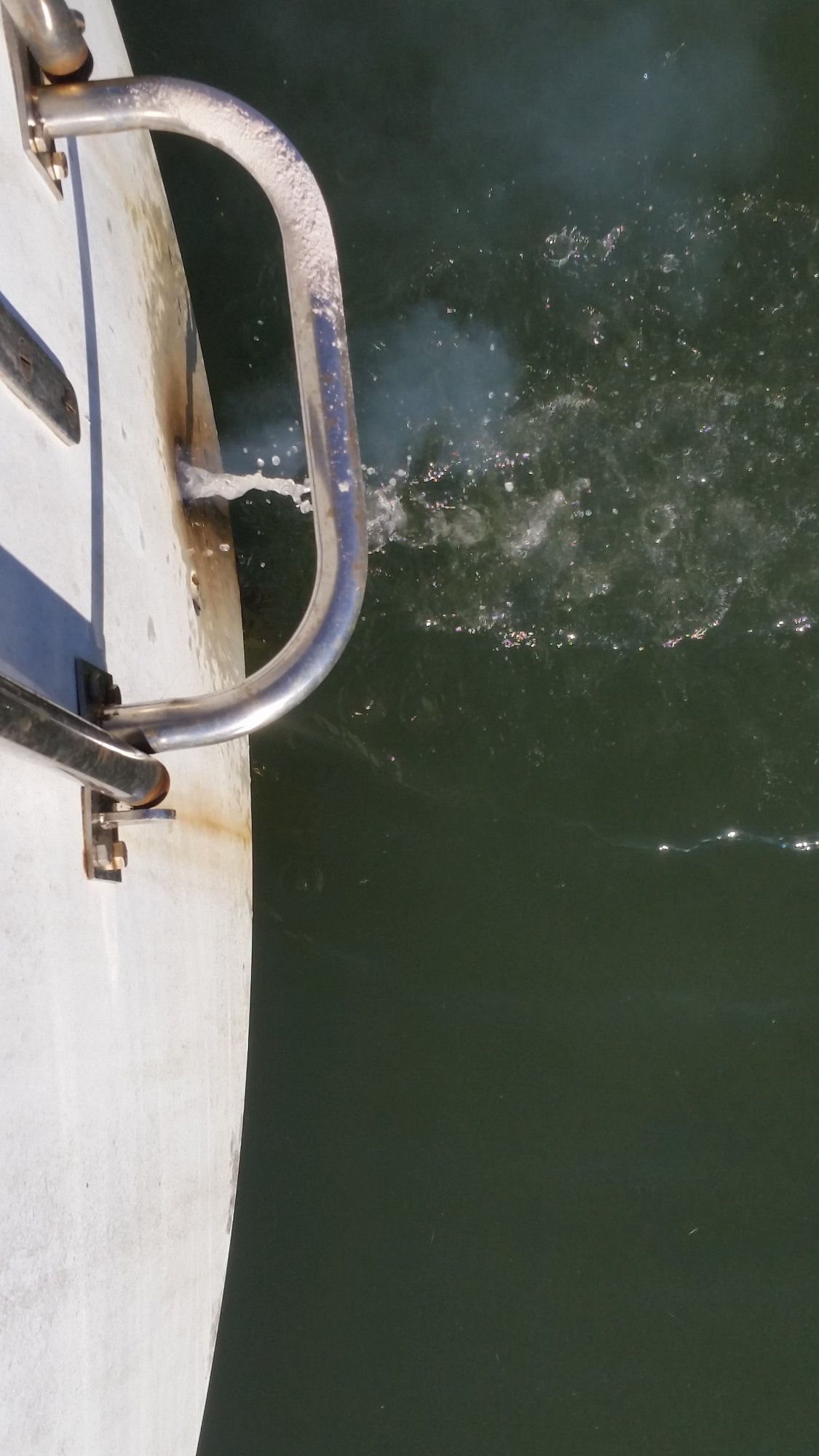

Hurray! After installing a 12v pump, I now have water coming out the exhaust.
Because the water pressure is so much greater, I now have leaks at those pesky seals along the water supply pipe. The design of having flat washers abutting the end of a copper pipe to effect a seal makes no sense to me especially considering that there is nothing connecting the pipe. I improved on this by taking some conical washers and shaving them down to the right shape with sandpaper. This reduced the leaking but not entirely. I then formed a piece of wood as a wedge and tapped that into place under the point where the water supply pipe enters the manifold. This again reduced the leakage but not entirely. At this point, I decided to call it a day and smile at the fact that I now have water coming out the exhaust.
