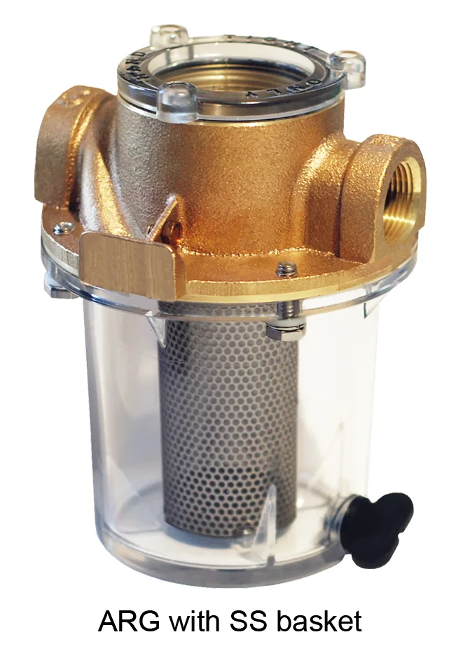

The strainer is probably pretty big and will look something like this:
A common failure on these strainers is the gasket above and below the glass housing. It is a cheap fix, buy some gasket material and make a new one. Also the strainer needs to be cleaned out periodically.
23,867
I like the Groco ARG 750
They come in 3 designs of basket. Plastic, Stainless Steel, or Monel. I like the monel model.
It is small and compact. If the strainer is located above the water line, I can open the top of the strainer and empty the basket even if the thru hull is open. You can always shut the thru hull to be sure no water enters the boat while you are cleaning the strainer.
