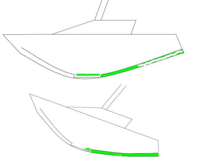

I'm guessing there is also the possibility that there is more water now, between the actual hull of the boat and the plastic (or whatever) shell that acts as the interior of the boat..
Question 2 - if there is water between these layers, do I need to worry about it ? With the boat on the hard, it is tilted to the aft, so that the bilge is no longer the lowest part of the boat. I'm up north where the temps get below 0. Could this water be contributing to the blistering I'm getting on the hull?

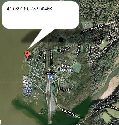

Where is New Hamburg?
41.589119,-73.950466

I think that most boats with hull liners, like my 1986 H28.5, are going to have water accumulating between the hull and the hull liner. It is probably impossible to prevent. But I would guess that your boat, like mine, also has some limber holes or small access points that can be used to pump such water out. On my boat, and perhaps yours too, if I pull up a panel in the cabin sole it exposes the aft keel bolts which come through the hull liner. I can slide a small diameter hand pump tube (same one I use to change the engine oil) into a limber hole on either side of the midline of my boat. By moving the tube around, I can usually suck out any water between the hull the and the liner. Investigate your boat thoroughly and you may find the same sort of arrangement.
