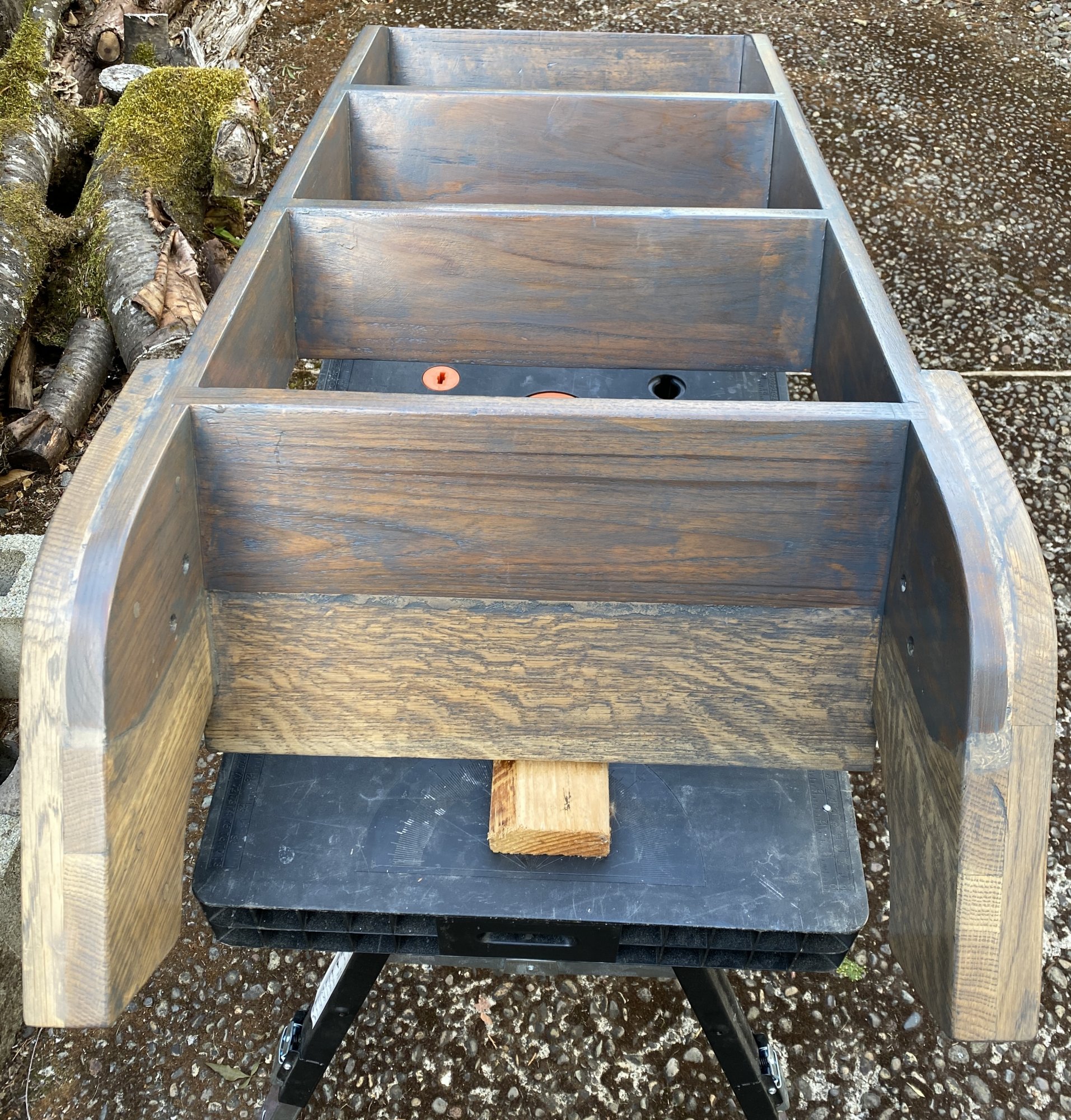

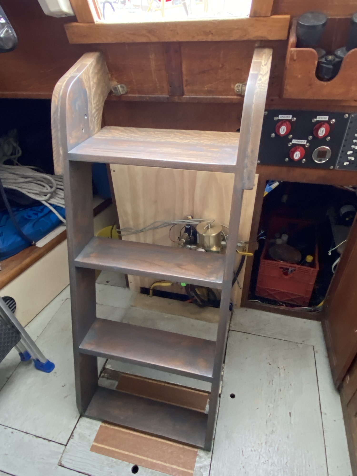

The internal woods are going to be Halcyon. I have already completed the new stairs. The stairs were stained with a Varithane oil-based wood stain. I let the stain dry for 24 hours. I sanded with a 320 grit. Wiped the surfaces clean, then applied the Water-based varnish. Four coats on the first day and three on the second day. I followed the directions for building up coats using gloss clear. The final coat was satin clear.
