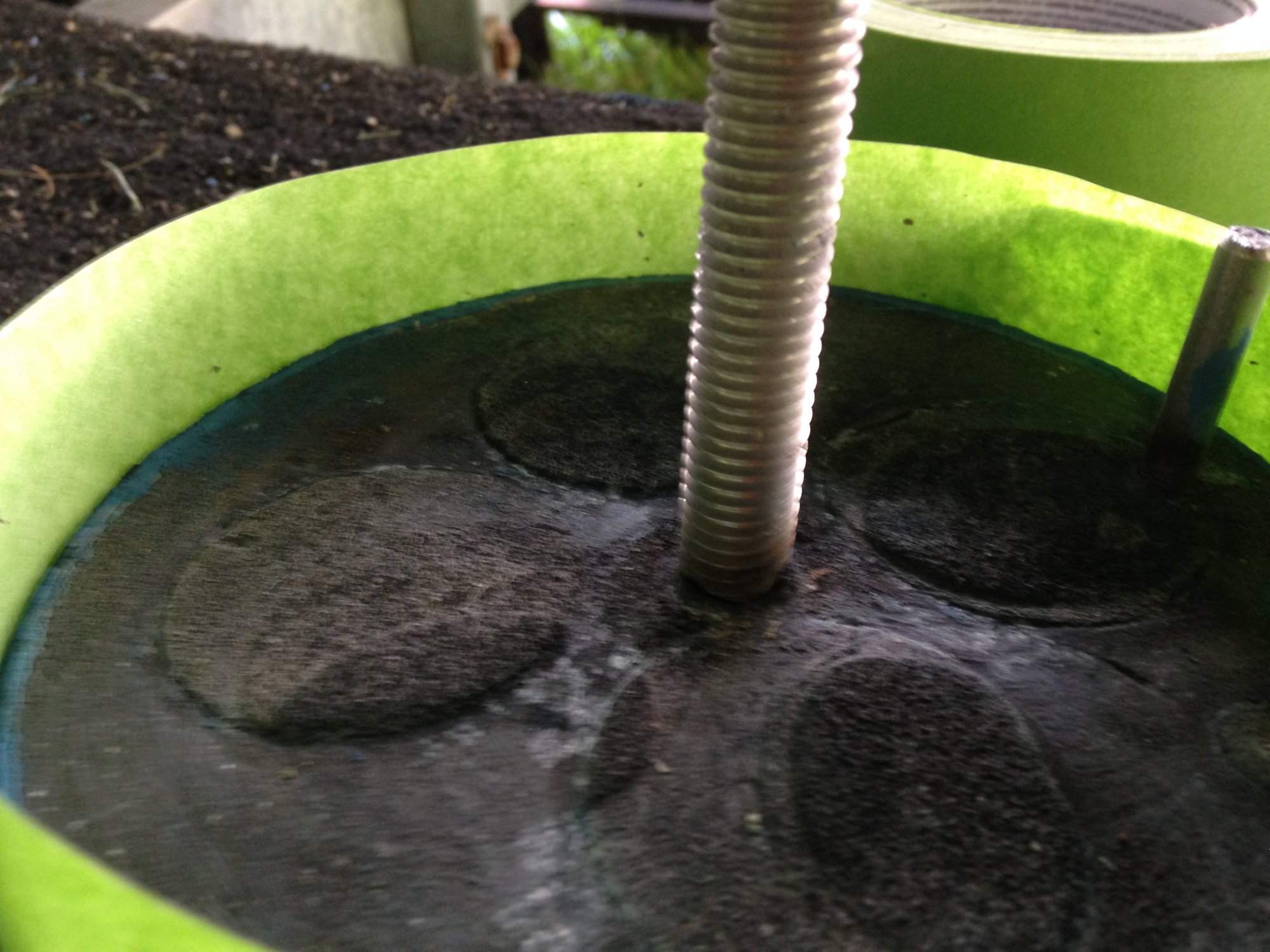

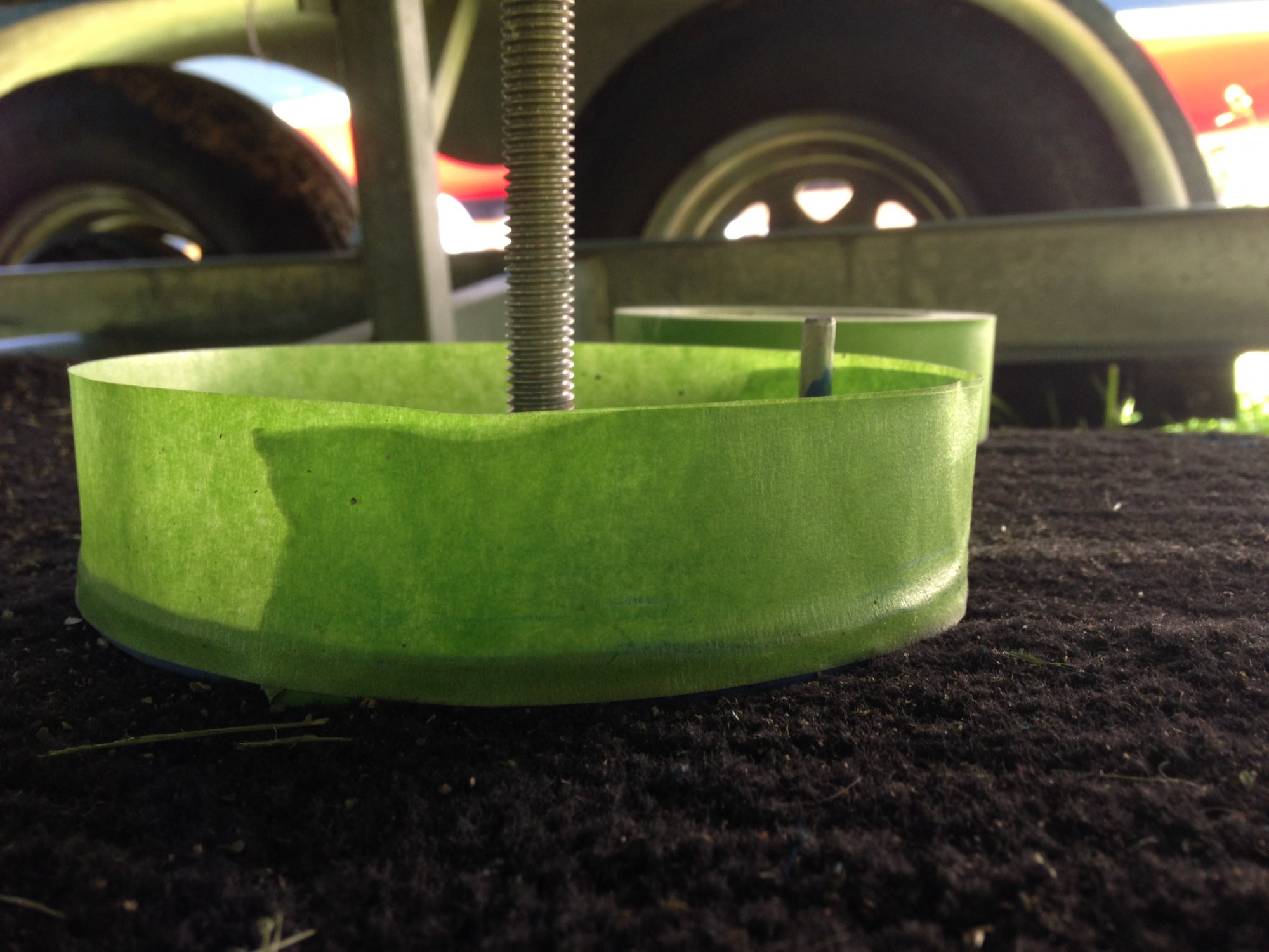

Well, I have done the valve reseal as rgranger suggested. After cleaning the valve surface and making a masking tape damn around seal I poured about 1 1/2 tubes of goop on the plate. It leveled nicely and appears to be a nice pliable seal. Took about 45 min. Thank you all for the help
