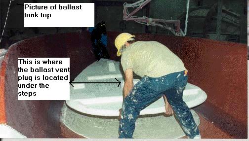

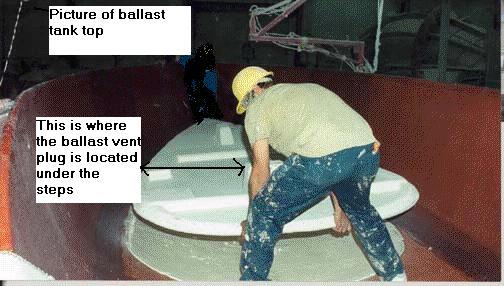

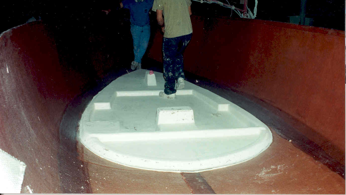

Photos from construction phase of h26/260 by Marlow Hunter.
How much water are you getting? A little or a lot? If just a bit place paper towel around the 1” vent seal and the ballast tank drain rod/nut under the cabin step. See if you have evidence of dye after a sail/rocking the boat.
If leaking due to a grounding I would expect the most likely location would be somewhere along the hull/tank top joint. You might be able to see evidence of damage on the hull exterior which would help you determine where to look in the interior. The hull/tank top joint is largely visible - in settees storage areas, bottom of galley and head cupboards and via access hatches under the aft berth. A borescope/endoscope can help with the inspection under the aft berth.
A quick check on the seal of the drain nut/washer/rod and vent plug can be accomplished by getting several friends aboard and having a look under the step access. This method would also assist in having a look at the rest of the tank top areas as well but you will need to work around your assistants! (Sufficient weight aboard will lower the top of the ballast tank below the exterior water line and force water through any holes/openings in the tank top or hull joint. )
rectangular object near the bottom centre of the photo with tank top in place is the piece under the cabin step with the fill/drain and vent are located.

Pictures are great. We intend to measure volumes tomorrow. I’m thinking some were between 1-2 gallons 24 hours. We’ve looked with a bore scope for signs of influx but this is difficult to see movement other than the rocking (slight) of the boat. I injected compressed air through the vent hole while looking with the bore scope but saw no bubbles. Looking at the tank, there is a rounded lip over the joint so this might prevent air bubbles from reaching the leak.
We’ve already traced down most of the obvious places but are certainly open to any ideas. Love the pics you posted. Very helpful.
