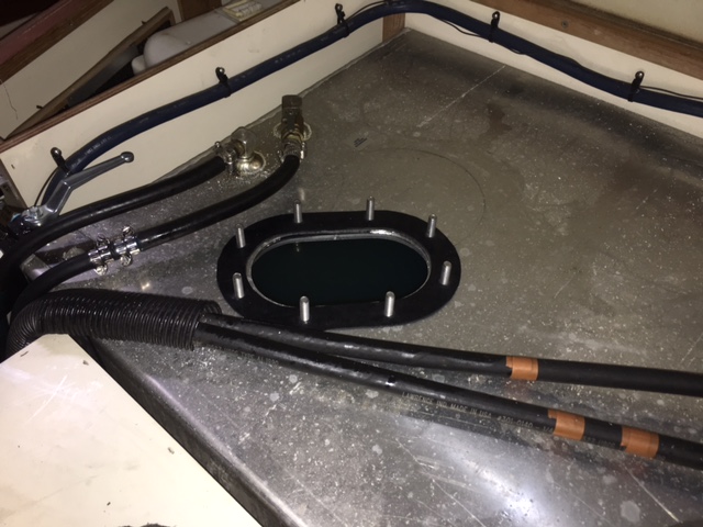

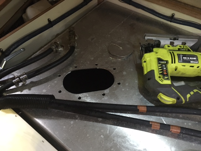

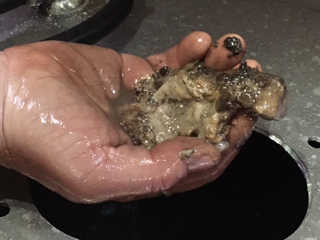

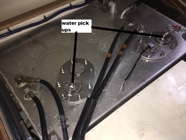

IMG_2836.JPG IMG_2841.JPG IMG_2845.JPG UPDATE- the "Clean Diesel" guy came today and installed his custom inspection ports- I am really impressed- just have a look at the pictures attached. We have not been able to do the cleaning and polishing today as it was raining, but he reached down into the tank and found 2+ inches of sludge- see picture attached- but the tank hasn't been cleaned in 25 years!
His inspection plates feature a water pick up drain- see the pic- all you do is attach a suction pump to the outlet and open the small gate valve and starting sucking to see if you have any water. Please note - as my tank has a straight and level front edge- which is the lowest point- he positions the water pick up tubes in the far right and left hand corners of my tank .He also found that the factory fuel pick up is only about 2mm off the tank floor in the middle of the tank and that this pick up was surrounded by this sludge- I was SOOOOO lucky not to have had a problem while underway! I will do another update after he has cleaned the tank and polished the fuel- such a wonderful tradesman- shame for all you guys that he is in Sydney , Australia! But he does sell these inspection plates and installation is simply done with a jig saw. I am a happy camper!
