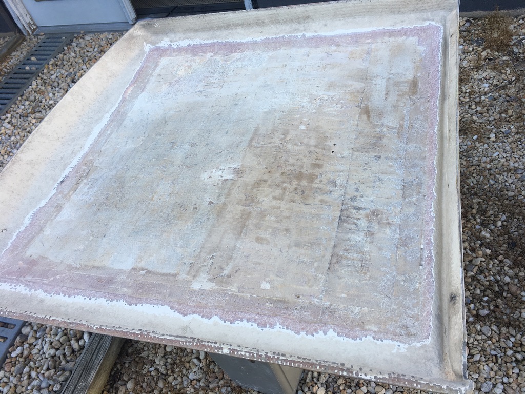

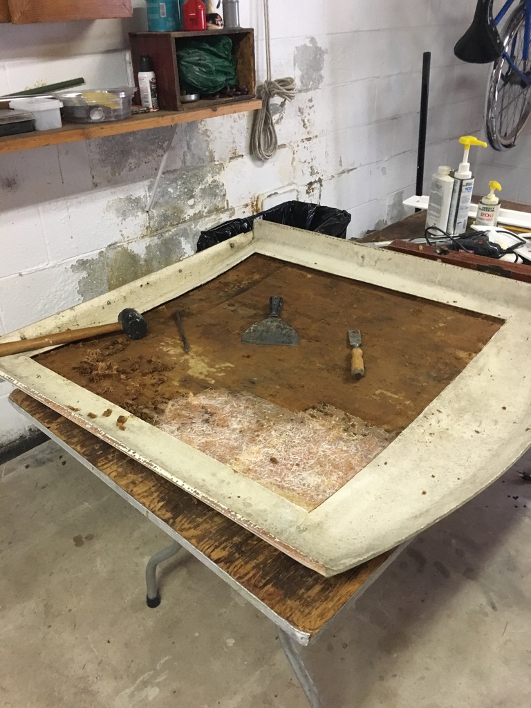

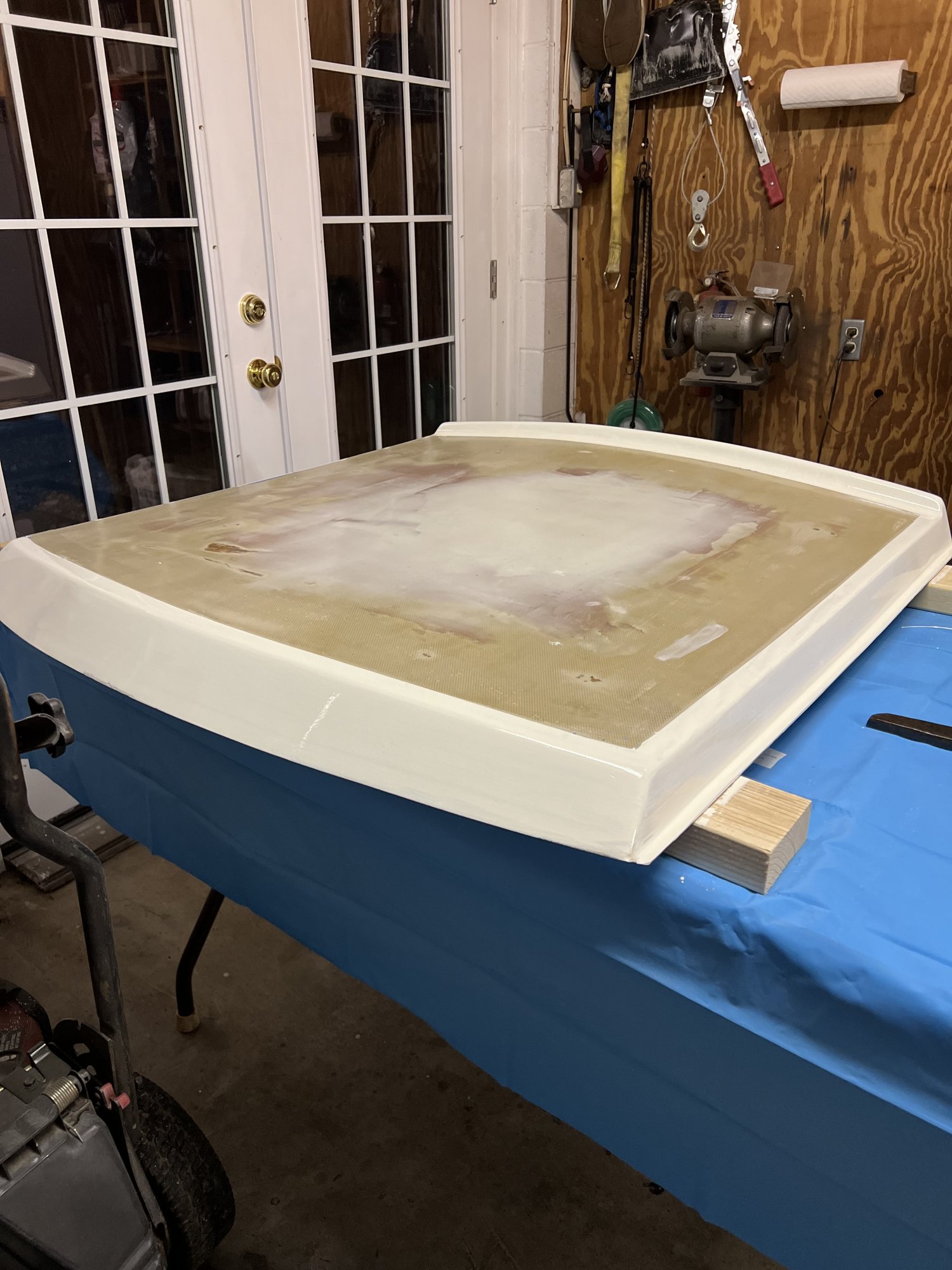

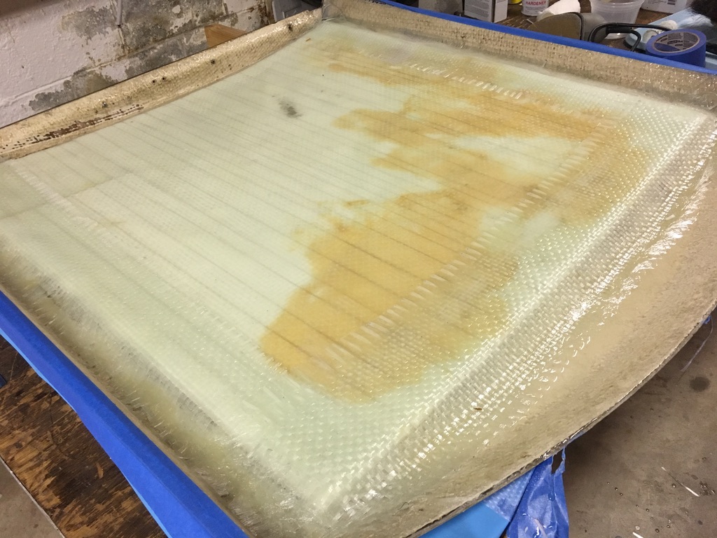

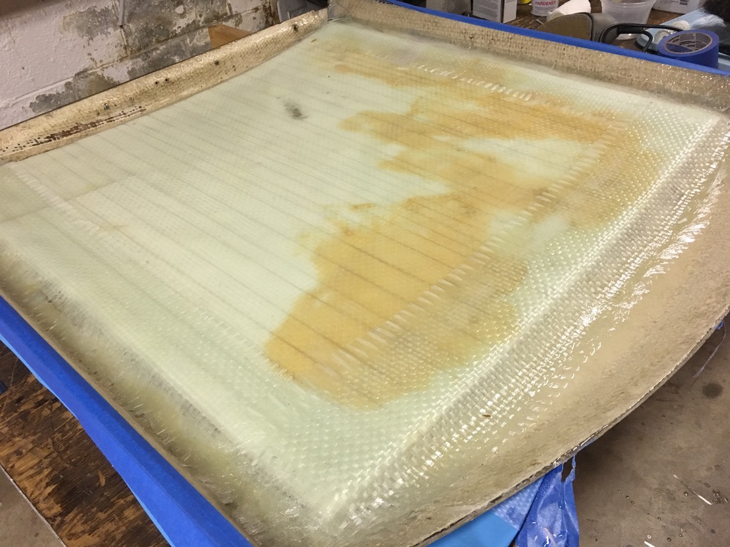

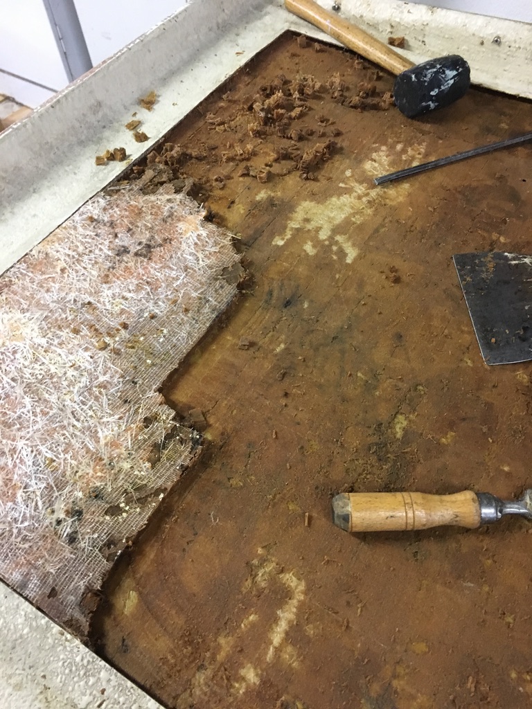

I am repairing and painting my companion way hatch cover on my O'day 30. The original cracked in so many places, the balsa core got soaked and rotted to a mush. I cut away the interior panel, removed all the old core, replaced fresh core, finished with fiberglass and epoxy. Then turned it right side up, built the low spots with thickened epoxy, shaped and sanded, and lastly put a clear epoxy coat to seal it. Then I sanded the gel coat sides and applied interlux bright side with 10% thinner as my first coat on the prepped gel coat. It dried well. Sanded down and applied the same paint mix, this time painting the entire hatch cover. Where the second coat on the gel coat it has dried hard. But after a week of curing time, the filled and finished area is still tacky to the touch. What gives, anyone? Am I just impatient and it needs more time?

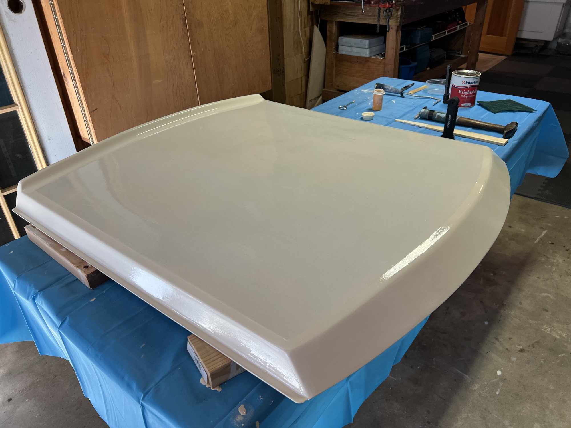

This is the upper side before after applying paint over the gel coat edges
This is how it looks with the whole top painted.

I suspect the epoxy is inhibiting the paint cure. Did you wash the epoxy before applying the Brightside? Epoxy forms an amine blush especially when when curing is cool environment. Sanding before removing the amine blush will grind it into the surface.
Call Interlux Tech support to verify.

Dave, thanks. You are an asset to the forum with your epoxy experience. So my epoxy was sanded and then wiped with Acetone. Paint was applied 30 minutes after the wipe down. Epoxy work has been cured for at least a month. I will reach out to Interlux as suggested.
13,450
I think that's your error. The epoxy needs to be washed with warm soapy water and a scrubby, then rinsed. The amine blush is water soluble and waxy, acetone won't remove it. Usually when there are adhesion and curing issues it is the amine blush at the root of the problem.
If the paint hasn't cured by now, the first step in any solution will be removing the uncured paint. You'll need lots of paper towels and what ever solvent is used with Brightside. Fortunately you have a small area. The Interlux solvents tend to be pretty nasty smelling, a charcoal filter mask will help along with good ventilation.

The paint on the gelcoat areas cured, the paint on the epoxy areas did not cure. If heat were the issue, then none of the paint would have cured. The difference between the two areas is painting over gelcoat or a cured Brightside vs painting over plain epoxy. The usual culprit with paint or gelcoat not sticking to epoxy is in the preparation, specifically the amine blush. A second possibility is improper mixing of the epoxy, specifically not following the correct hardener/epoxy ratio. A third possibility is old epoxy which did not fully cure.
Be sure to remove the uncured paint with the right solvent. Solvents used for 2 part paints like Interlux Perfection will soften cured one part paints like Brightside.

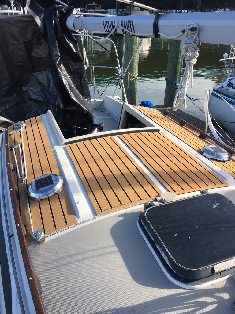

@ William 24424: The project started with cracked top issues.
I had broken teak railings/hold down sliders. I bought two new ones from Rudy. Then I removed the top and worked on it as in my opening work description.

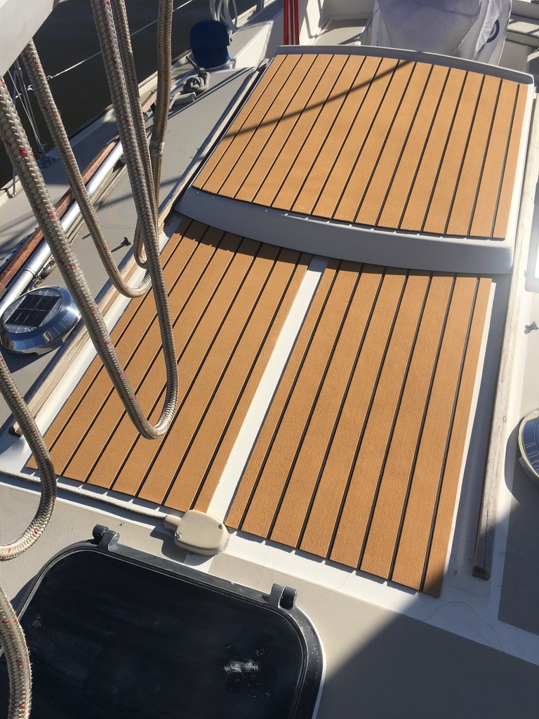

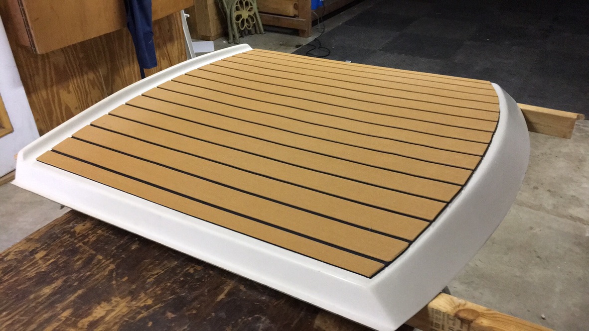

What I left out was, I went on line and bought faux teak covering and applied. Two years later I was scraping it off. Sure it looked good, but the weather and the UV just disintergrated it.
Now I'm doing the topside again. Who said I can't keep myself busy? Ha ha. Running out of allowable space to upload pics. Will add more on the next post.

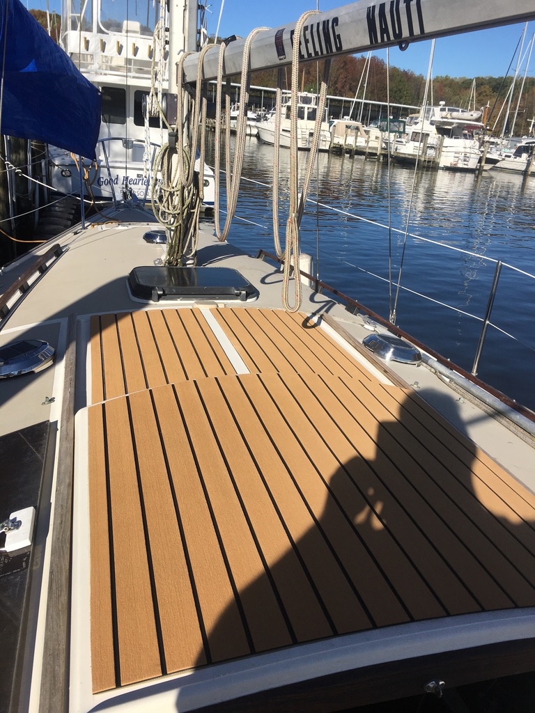

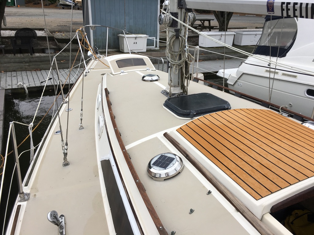

Pics of project continued.
UV and weather damage was all over the faux teak. This product was not SEADEK. The SEADEK product is closed cell and far superior Also $260 a 40x80 sheet.
So enough of this show and tell. Back to finding solutions. Another 7 hours of heated workshop time before checking the paint to see if there is any difference. Thanks all.

Huh! Where there's a will there's a way. Opened up the workshop back door, pulled my work table to the door, used lacquer thinner to wash off the tacky paint. It did not affect the painted gel coat. All clean now. Cleaned up my shop while the few remaining fumes escaped out the door, put the work table back and all the products needed to continue with the project, like an OR room Mayo stand. Now I wait to wash with soap and water and a scotch brite pad.

Have the same problem with a fixed sea hood that covers a cast acrylic companionway slider. The seahood developed a leak, probably where the factory installed a dorade vent, causing the balsa core to rot. The deck side is finished with nonskid. Going to use core cell for new core. How many layers of cloth did you use over your new core? Plan to spray gelcoat over the nonskid to refresh & cover some spider cracks.

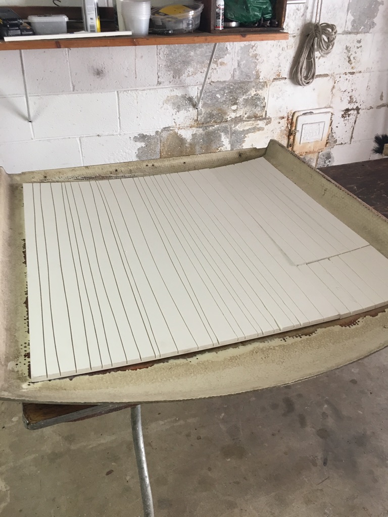

Thanks for Layer of cloth fine weave first. Then installed PVC core and filled gaps with epoxy resin. After cure, I used a large weave roving.

@dlochner et al. I took the opportunity to set up saw horses outside in this 34 degree weather and with hot water, kitchen soap and a scotchbrite cloth, scrubbed every which direction. After 30 minutes of rigorous scrubbing, I rinsed off the top. Oh my, that nice shiny finish has been replaced with a very dull surface. I think I got it all. I wiped it down with paper towels and then brought it inside to dry. I will let it dry for two days, check with feel and look for any missed areas, then as suggested, apply paint to a small area to see if it cures. I'm learning a lot about epoxy work and starting to get the hang of it. Maybe a hard dodger with a soft canvas top may be a future project. Who knows, let's get this one finished first, but you can't blame a guy for dreaming.

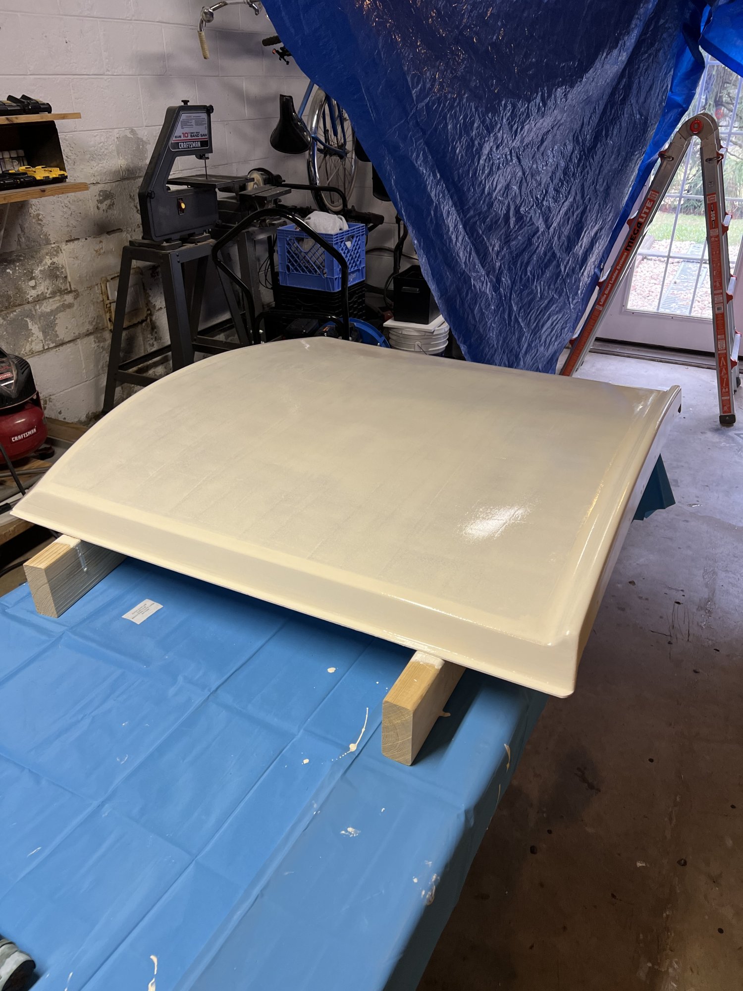

After a quick sand and final cleaning I painted the whole hatch cover again, using a mix of paint and 10% paint thinner. It went on so well and after much rolling in all directions here is the still wet look result. This just the first coat. I intend to do one more coat with 5% thinner and then the final coat straight paint.
