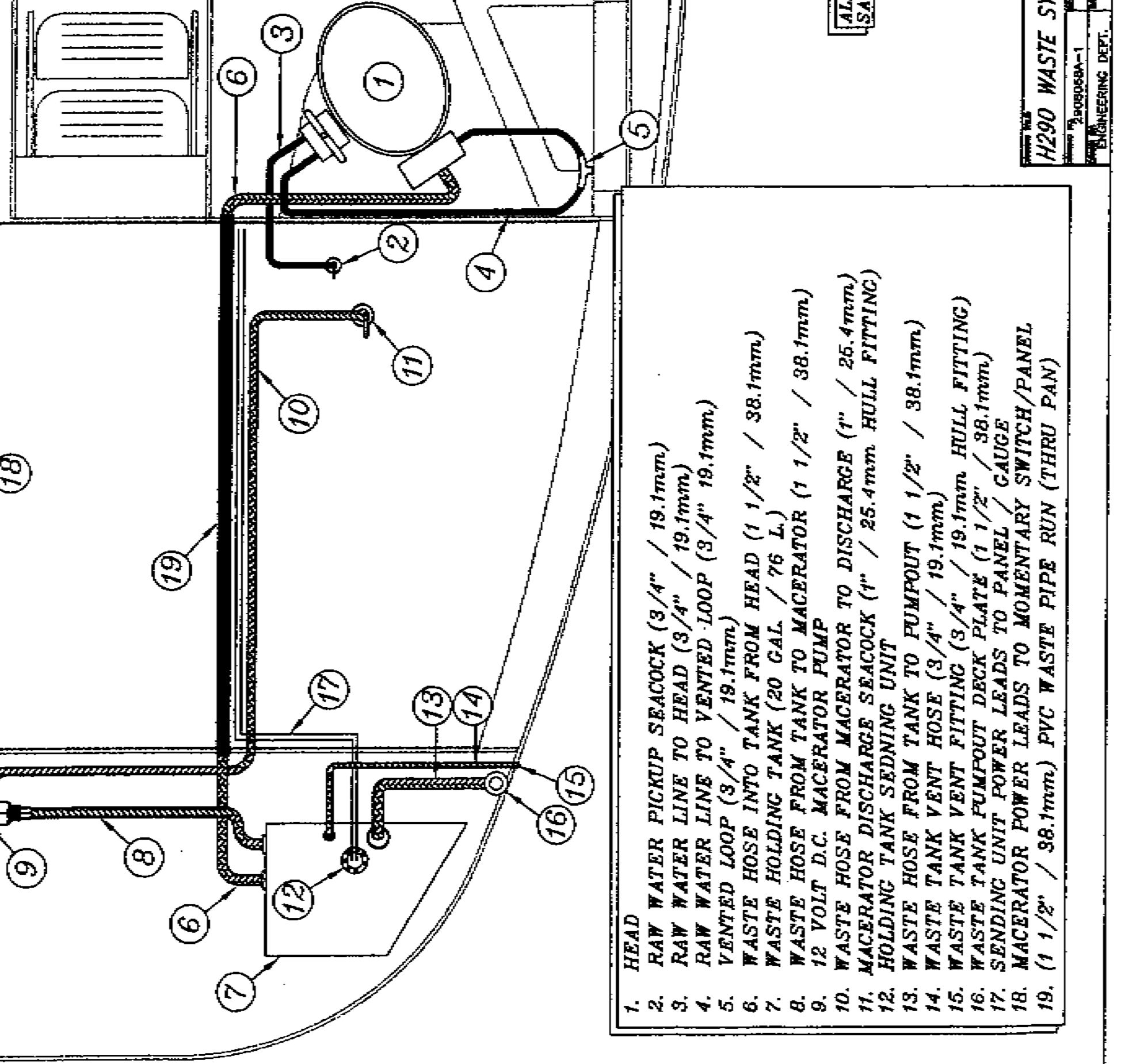

Hi H290 waste tank indicater does not work, power to it so tried the float level but cant get it out of the tank due to no room to lift strait up as cockpit locker right above the tank. Had same issue on potable water tank and lifting out the float mechanism was strait forward. This seems the same except no room to lift out. Anyone tried fixing this or any suggestions?
thanks
Colin
Oct 27, 2023
84
hunter 290 toronto
was full, now pumped out...pwr at guage, think float is saturated and not working...same issue with fresh water tank and easy fix there. Right above item 12 is the cockpit locker so unit cannot be removed strait out.
thanks for any help
