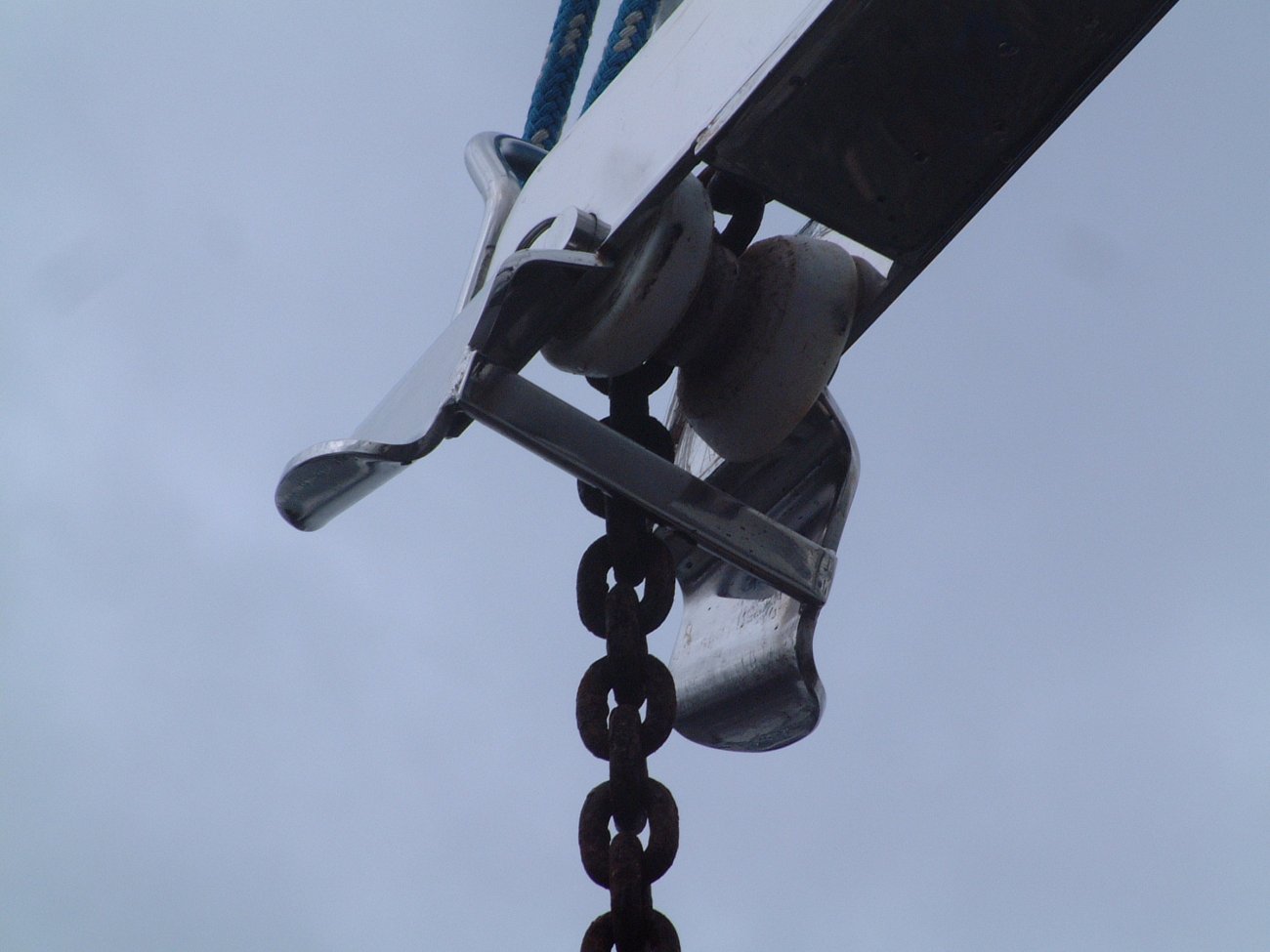

Our boat lives on a mooring so there is very little opportunity to rinse with fresh water. I rinse with seawater when hauling up and I rinse with freshwater whenever I fill my tanks. I get about 6-7 years service from my chain which is 5/16" ACCO G4. I think that the worst wear on the chain which removes the galvanizing is at the anchor bow roller. I have a reinforcing bar across the sides of the anchor roller and the chain gets pulled across it. Also the constant motion of the links rubbing each other in the water also contributes to the galvanization removal and subsequent rusting. I added a piece of PVC tubing to cover the reinforcing bar so that the chain would not hit on metal. I think this is beneficial to prolonging the life of the chain, but I have no positive proof. Below is a pix of the reinforcing bar that I have covered with PVC tubing. Sorry, nor picture of the tubing in place.
