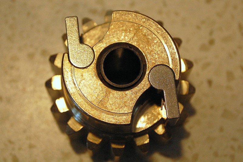

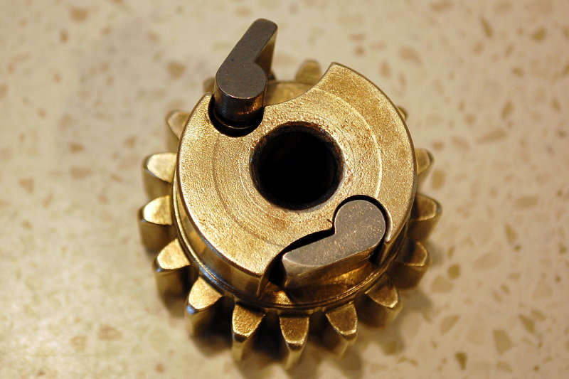

I recently came across an issue with a set of Lewmar Ocean Series self tailing winches that leads me to post this. The winches in question had the pawl pockets so worn, stretched or sloppy that the springs apparently jammed in-between the bronze gear and pawl and finally both pawls failed to spring back / operate. In my 40+ years on the water I have certainly seen worn and sloppy drums (usually aluminum), failed pawl springs, rounded pawl locks and worn pawl sockets too. Usually these were all on poorly maintained winches. However I have rarely seen pawl pockets this badly worn out especially on relatively new winches that have been routinely maintained using Lewmar branded grease and pawl oil. That is the real stumper here.
This failure caused a dangerous situation which meant the winch would no longer stop the drum from spinning backwards. The owner almost broke a wrist. A winch handle on a loaded drum with no pawls can easily break and arm or worse, especially if it were to hit a child.
Also, when this one spun backwards, and failed to lock, it broke the line stripper off causing the line to jam under the feeder arm when the sheet was cranked back in.:cussing:
These winches are not very old, a current series, though the EVO series seems to just replaced it. These are/were Lewmar's top of the line winch and had been cleaned and lubed religiously using Lewmar brand grease and Lewmar Speed Lube for the pawls & springs..
Please check on & inspect your Lewmar Ocean Series winches!
A Lewmar Ocean Series ST Winch (not the one with the failure)
How loose the pawls were fitting. Brand new pawls in this gear fit exactly the same way:
One of the pawls can simply slide out of the pocket !!!
Not good!!

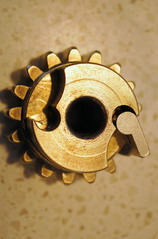

This is what the new pawl gear looks like. There is little to zero slop in the fit. This is how it SHOULD fit.
Please, for the safety of you and your crew at least inspect your pawl gears!!!

Yet with a little google search I easily found a discussion from 2006 on the J105 forums where multiple owners have had the problem, with the same winches. One owner even reports that Lewmar has developed hardened bronze gears and an optional stainless gear to try and deal with this issue. But yet, I am the only one to ever have this problem.... BTW I was not offered the upgraded gears so whether they really exist or not is debatable......
It is hard to say what happened exactly but it is clearly in the bronze that "gave". A brand new pawl fits exactly the same way.
Apparently I am not the only one to have seen this issue:cussing::

But these winches were perfectly lubed, no "gum" and the pawls, like I find so often, had been properly oiled using Lewmar products, not greased. I know because I have been the one maintaining them, on this boat, for at least 8 years and I don't believe the winches are even 10 years old yet.
Either way I think folks who own these winches should take the time to pop the top, remove the line feeder, slide the drum off and pull the gear pins & gears to inspect the pawl sockets. It takes about 10 minutes to do so, at best. A broken arm will put you out a lot more than 10-20 minutes....;)

I suspect the rounded corners on these pawls occurred from the slop in the pawl socket. The soft corner looks much more pronounced in the pictures than in real life due to shadows. When laid flat on glass you can't even slide a piece of paper under that edge.
These pawl gears are apparently used in both the 44ST and 48ST winches..
